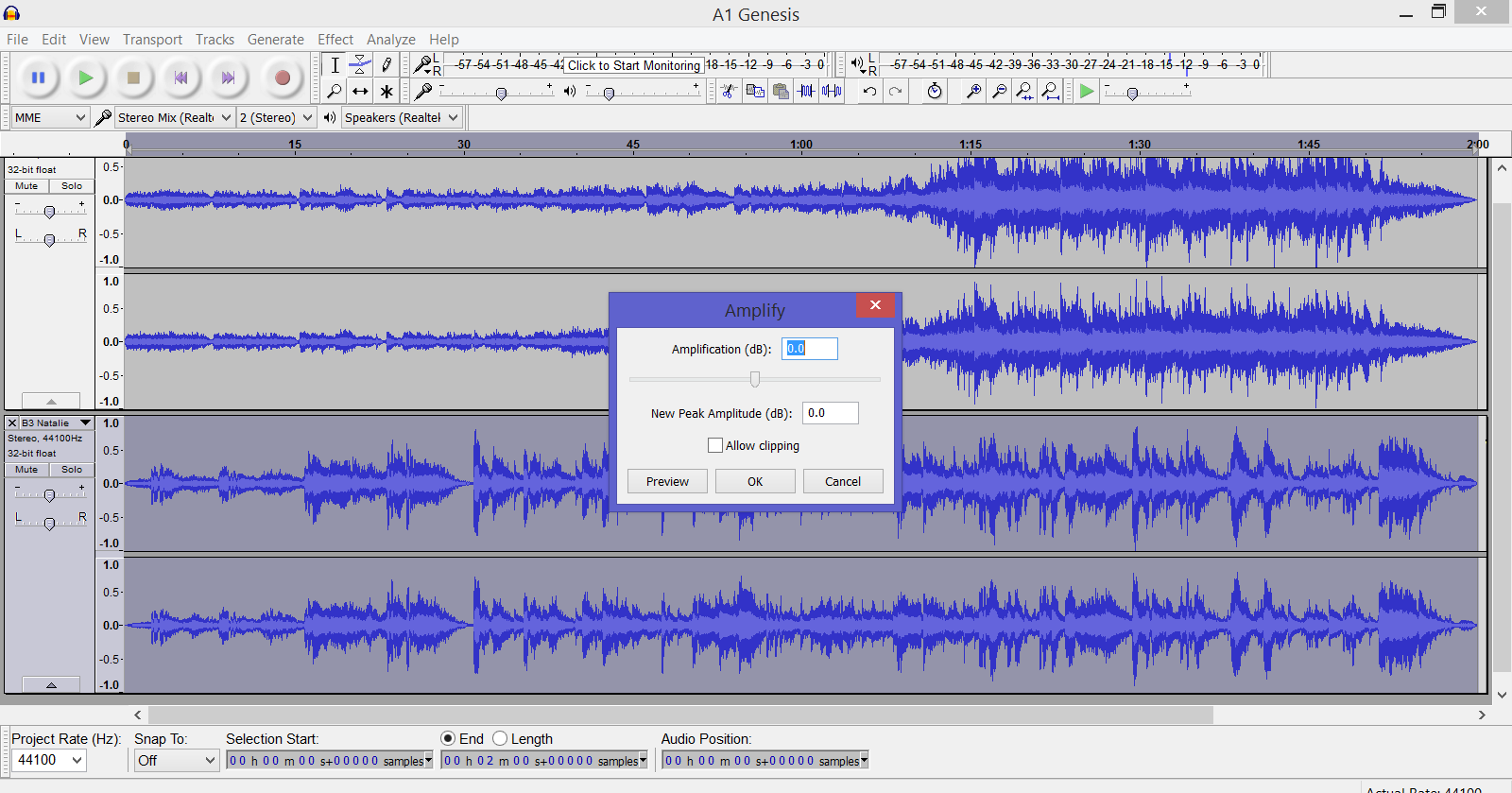

Enlighten me. I used Audacity and that is telling me all tracks are the same level. At least the way I'm using it anyway.
In previous listening tests I even went as far as recording a test tone and measuring playback levels on a meter/scope. That drew complaints too although none of you knew I was doing that.
So how do you match the level of two tracks in Audacity.

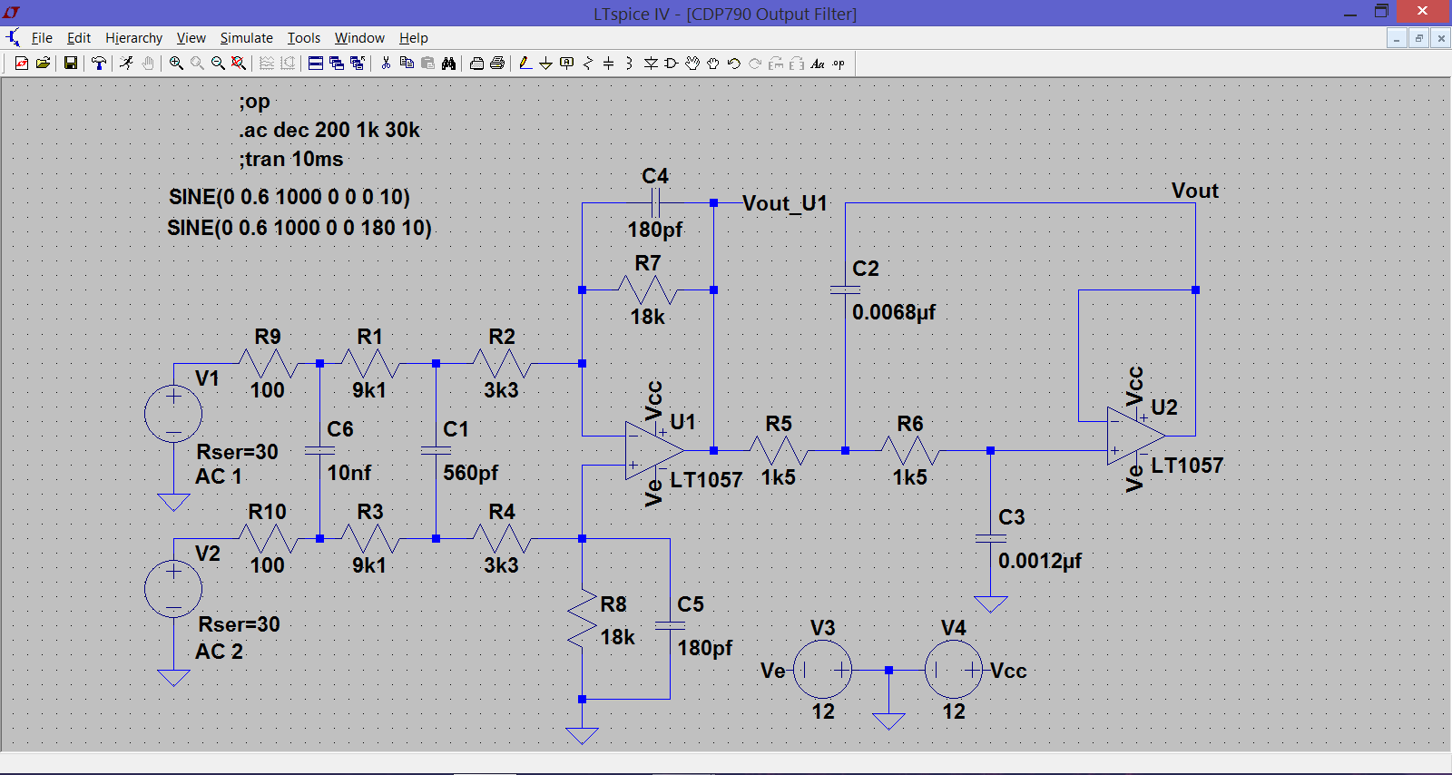

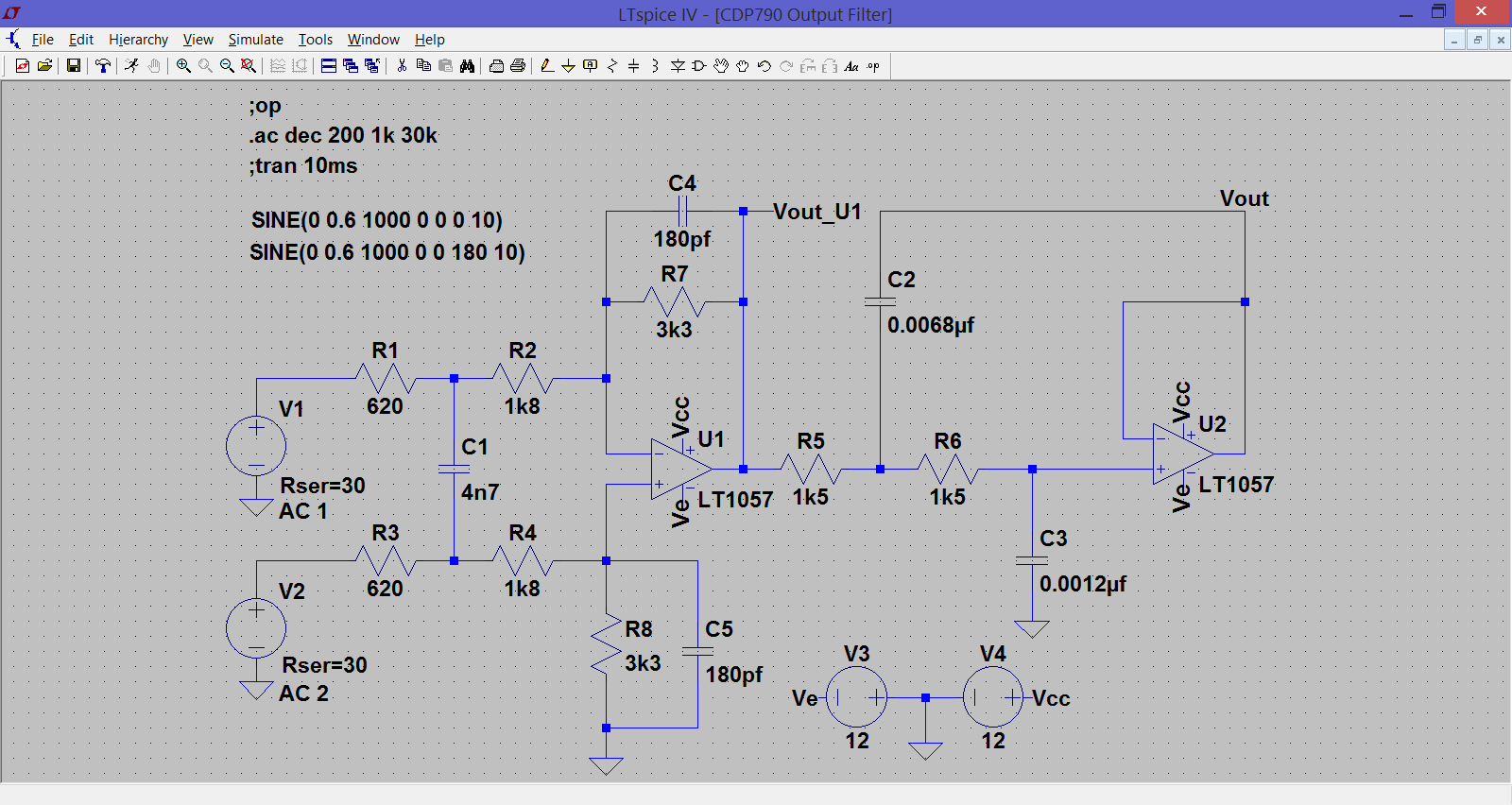

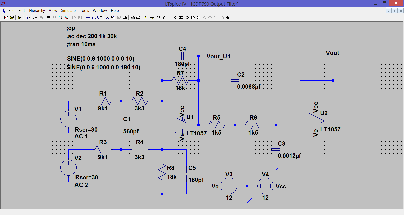

Here are the mods. The first is with the original player, mods 2 and 3 are as shown and both with the 0.22F supercap on the DAC supply.
odd. Foobar says peak is within 0.02dB for all 3, but RMS is 0.5dB different for A3. It reports the B tracks as all the same.
On tracks A1 vs A2 and B1 vs B2 I see at the most 0.07dB RMS difference. Biggest difference is on the right track. That's point zero seven dB. I doubt that would skew the tests.

Can you give us a sample of original filter without 0.22f cap ... with 0.22f cap on analog part than 0.22f on digital part. And 0,22f on both lines. So 4 samples. It is enough last minute of genesis sample. I still think if it is worth to buy that caps.Thank you
Interesting. As I mentioned earlier (or as you can probably tell 😀), I'm no expert on file handling and how to do all these things. Its all been very much trial and error and learning over the months.
One thing is always abundantly clear though, and this is on all the listening tests I've run, and that is that it always seems to come down to being an exercise in file handling rather than just sitting down and listening. Whatever the truth with the levels here (and they are all pretty close whatever the outcome) I would ask (seriously) does it matter that much. Even if there were a couple of db difference (as there could be if you were listening to two different models of DAC, or two phono cartridges etc) then just turn it up and keep listening and comparing. If there is a difference then eventually you will pick up on it and hopefully be able to express a preference for one over another. I didn't use Foobar for listening to these, just my normal speaker/amp combination and using the DAC of my Marantz Pearl-Lite to play the files from a USB stick.
