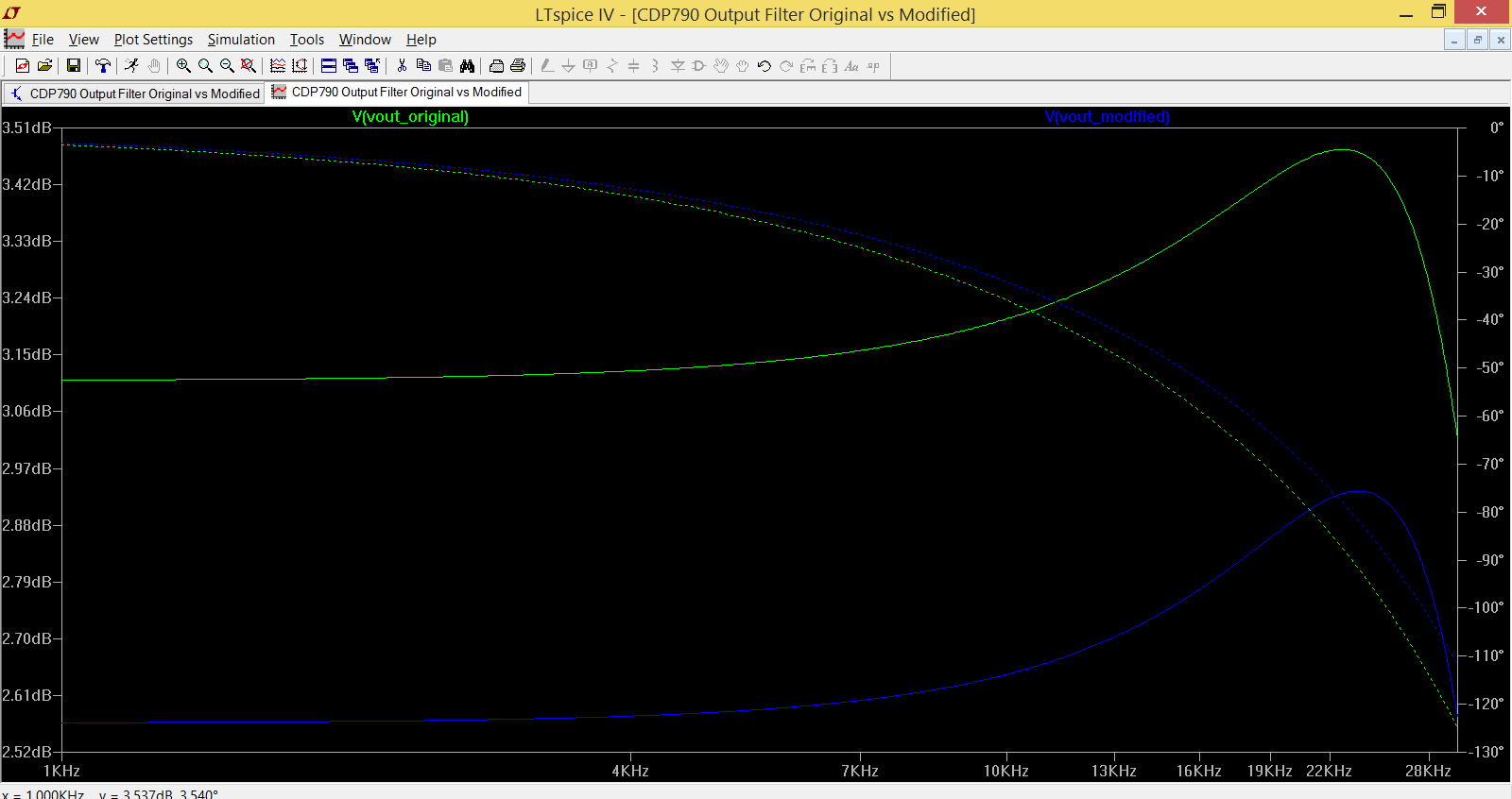

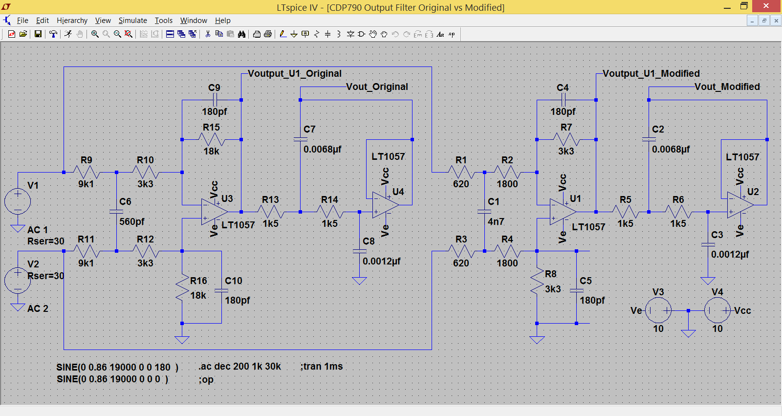

I've had a little bit more of a look at this today and discovered that some of the Sony component values don't agree with those in the service manual (and it was those I based the original simulation on) although the difference it makes to the response is minor.
I suspect the values could have been rescaled to keep distortion at maximum levels to a minimum, the reason being that the opamps run on only -/+5 volts which is very low. The rescaled values slightly reduce the forward gain of the stage while maintaining the same response.
This diagram shows the values actually fitted in the DAC (left hand side of diagram) and on the final version I have settled on to test all this (right hand side of diagram). The components values I have selected mimic the original response as best as possible without recourse to odd values and making values up from series/parallel combinations. A check of the actual player output at 1kHz intervals all the way up to 20kHz shows a flat response. The fact that the final output is flat, implies that the DAC output is purposely not so given the fact the final opamp stage has this rising response characteristic.
This diagram shows the response from the original values (as actually fitted) and my closest fit for the modification using preferred values that I had available. Apart from a slight overall reduction in output level it mirrors the original fairly closely I thought.
Listening tests tomorrow.
