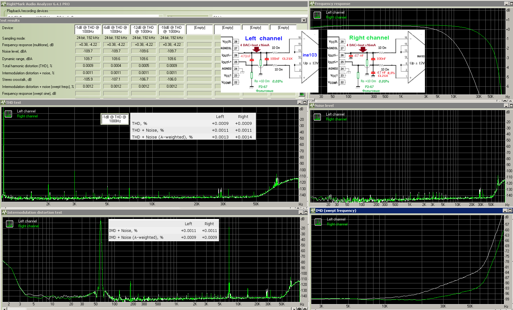

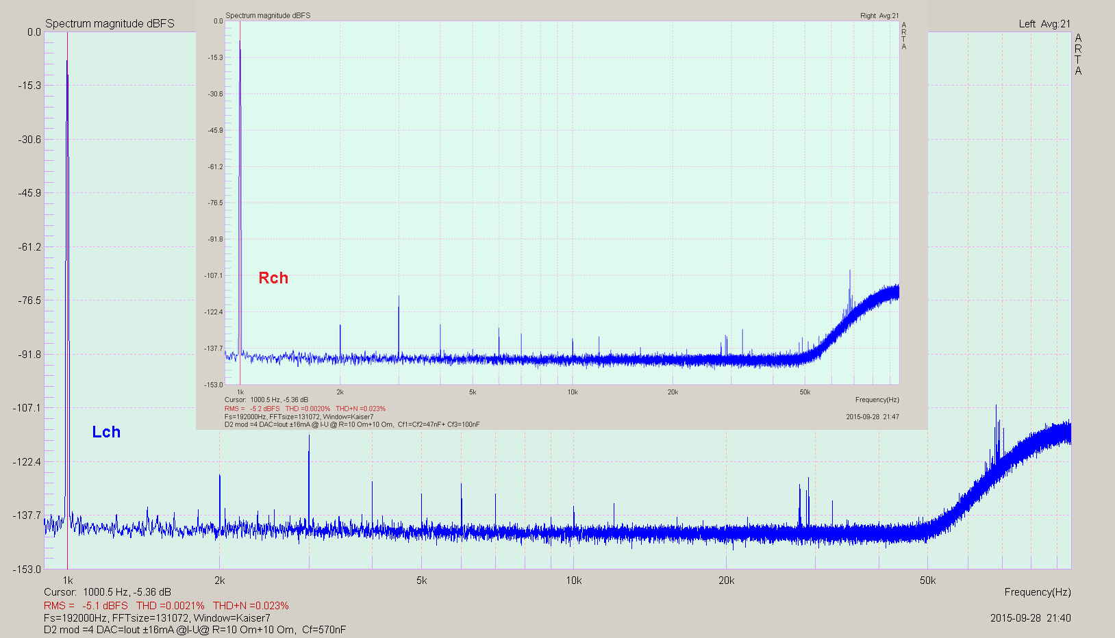

Fs=192kHz
Cfilter = 570nF @ Left channel
Cfilter=C1=C2=47nF, C3=100nF @ Right channel
what sorts of input are you thinking?
Another point, I'm led to believe there is some kind of magic about -1db at 20kHz. Does that mean simply substituting 1R8 for the 3R3 resistors destroys the secret mojo? This measurement is unlikely to show anything except the small shift in 3dB frequency.
The above picture (#456) shows the no I to V approach, I directly into small R with high gain low noise amplifier. Mixing all these different approaches together is bound to cause confusion.
