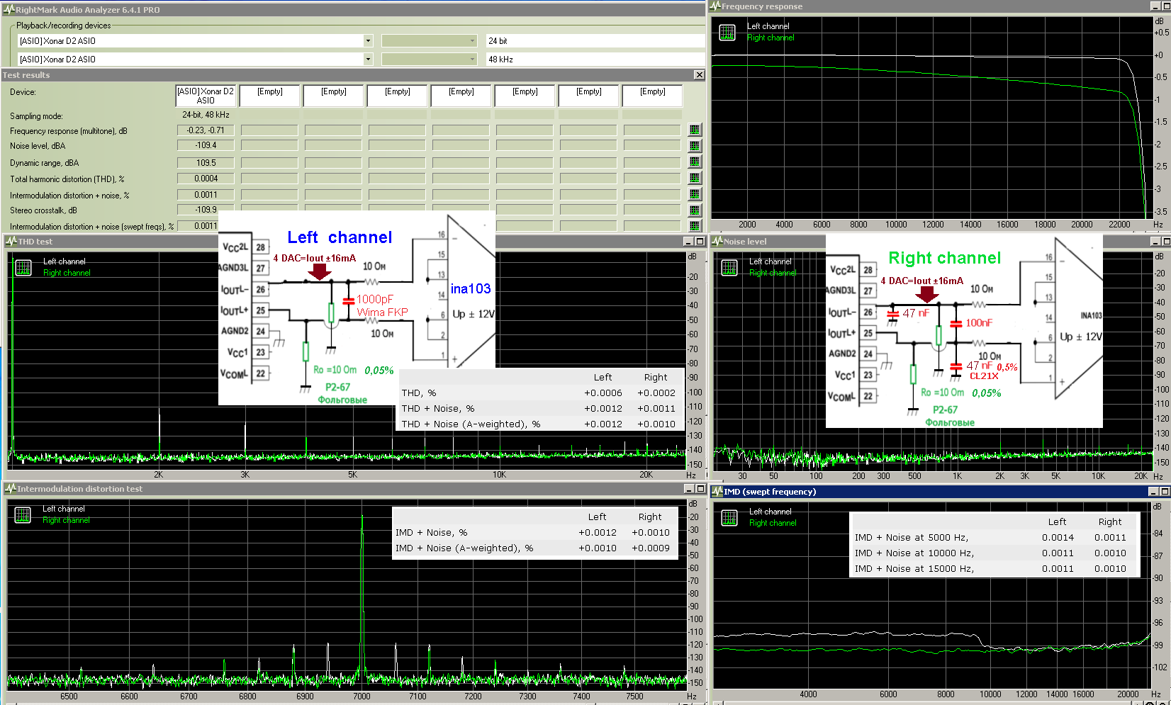

Thanks Vovi! That's the sort of thing we have been looking for. I see more distortion on the channel that is heavily loaded. Is that right?
Is it possible to see the same test without the caps? That would show us useful info.
