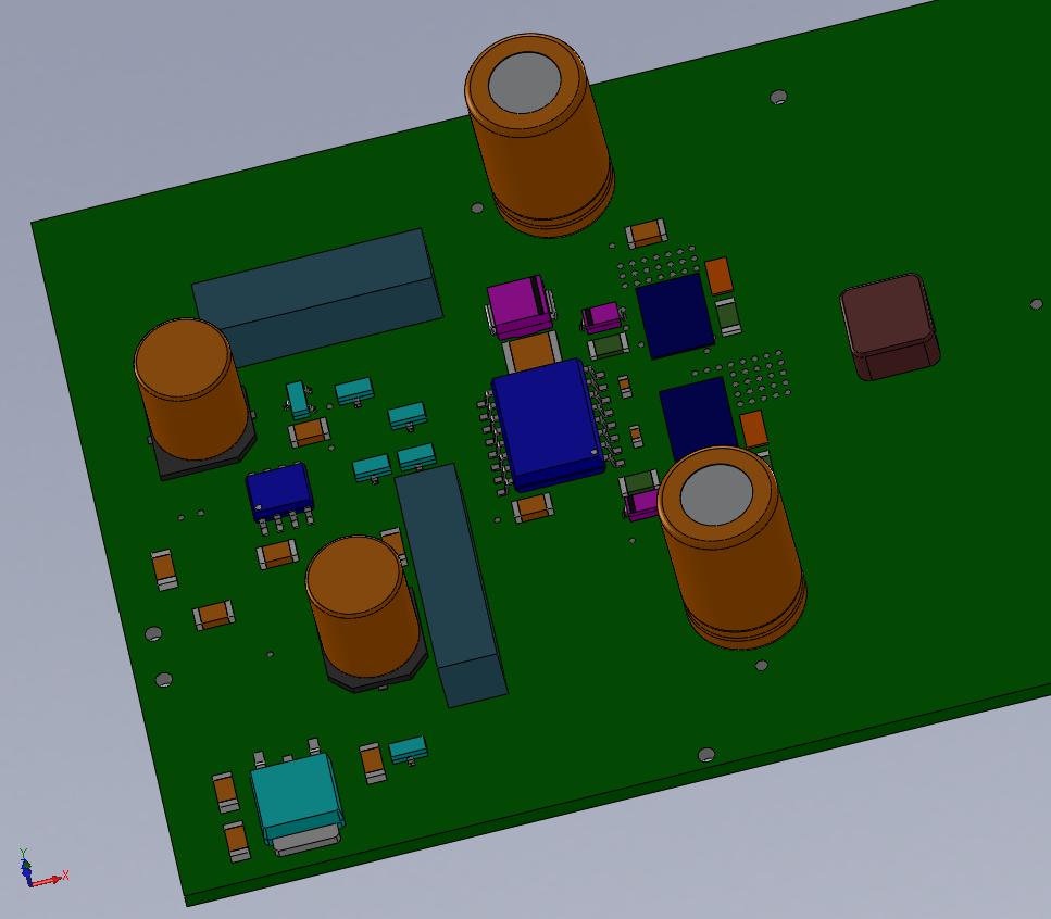

To cater for the mechanical side I've been playing with the IDF (Intermediate Data Format), Circuitworks and Solid Works to start creating the 3D assembly for the board.

I've attached a screen shot of the assembly so far, I still have to model some of the PTH components. The advantage of using this form of transfer between the PCB layout package and a 3D package such as Solid Works is in fitting the board into an enclosure, or if doing a custom enclosue, designing the enclosure around the PCB assembly.
The other advantage is being able to produce some quick and quite nice assembly drawings. On think I do with prototypes is print the drilling info onto A4 sized labels that you can then align and stick on the board to provide location points for drilling.
When the assembly is completed I will either create a parasolid of the assembly or use the pack and go function so your freind who has SW has all the mechanical data.
A quick example of the derived drawings from an IDF-Solid Works assembly. The only thing that dosn't transfer easily are the component references, it is possible to transfer them but is a pain to get them to apear on the drawings.
