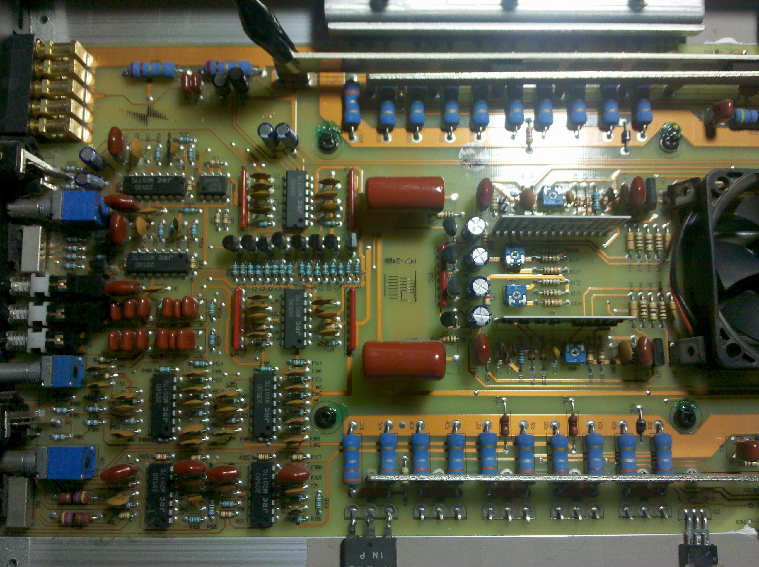

Working on this amp, right channel has +19Vdc on it and the left has -17Vdc. The left channel has the top part clipped off. The right channel has a signal riding on a dc level.
Reading other threads I found a schematic for the ceramic boards, what should the signal coming into pin 3 and 4 be.
Attached is a photo of the pc board. Are the drivers Q9, Q10 on the ceramic board?

Measure the voltage again but this time, place the black probe on one of the non-bridging speaker terminals.
The signal on pins 3 and 4 should be audio with essentially no DC.
Do you have the proper supply voltage on both power supply pins of the op-amps?
Do you have the proper supply voltage on both power supply pins of the driver board?
Do you read 100 ohms for each placement (A and B) on the following image?
http://www.bcae1.com/temp/ppidriverboardresistoroverlay01.swf
You can't install an SMD resistor in place of the original. The only viable options (in my opinion) are to use a leaded resistor and connect it as shown in the image or to replace the board.
As a side note, if the 100 ohm resistor didn't open 100% (they rarely do), you need to remove the transistor and cut the resistor through completely. If you don't, it could cause strange problems later.
