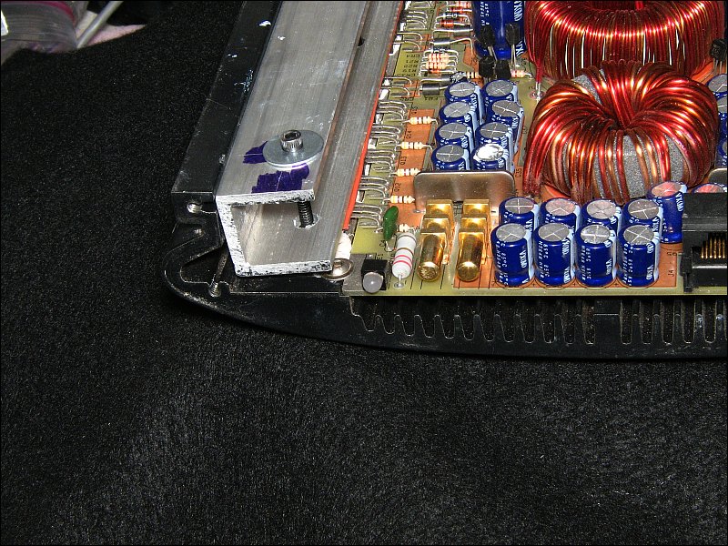

If you do anything with the 2200 with the cover off, you need to make clamps to hold everything tight to the heatsink. Failure to clamp all components could lead to the amp failing. Have no more than a 15 amp fuse in the B+ line when making adjustment. The easiest clamps to make are probably using C-channel (below).
The 20k pots are the DC offset pots. Turn it slowly to see which way reduces the offset. The channel could have (probably has) other problems if you can't zero the offset.
I didn't try adjusting offset yet as I haven't had time to make clamps.
