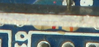

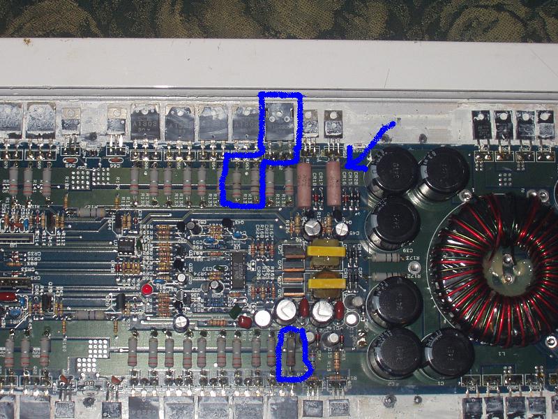

I had the outputs out of the amp on the left channel and just soldered them back in.
Now the amp has 1.95 volts on the output for like 10 secs then goes to 0.2 volts and amp plays fine out of the left channel then after about 2 mins i get 1.95 volts on the output for a min then it goes back to 0
Do i need to adjust the pot still or what do i do from this point?
Look for bad solder connections on the large transistors on the driver board. You'll need a lighted magnifying glass to see them, most likely.
