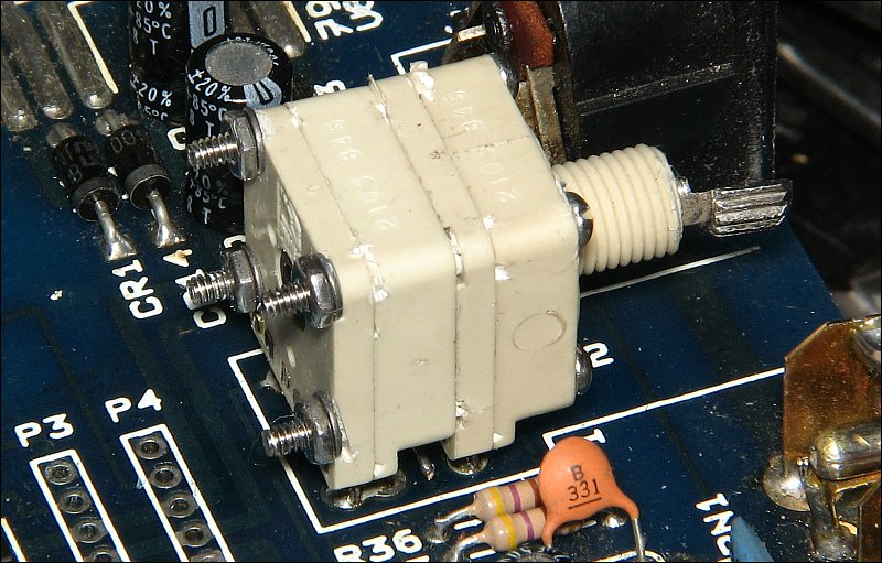

Oh I forgot the gain pots on these are usually trashed < scratchy and have fall outs in their spans> A suitable replacement that fits the PCB might be a bit tough to locate but a worthwhile investment IMHO...🙂

Those gain pots always suck, on all amplifiers. If there is a replacement, I'd do it.. But don't want to spend too much effort on trying to find one. I have the same issue with lots of "external" pars on Car Amplifiers. I am looking for the wire harness for a HiFonics amplifier. Also have a Infinity RSA250 in the stack that has a broken speaker terminal. And, my favorite amplifier a Harman Kardon CA260 with a broken RCA input. I have been unable to find suitable replacement parts. If the time comes that I want to use this equipment but have not found anything, I will just modify them to as needed.

The large white pots can be removed, disassembled, cleaned and reassembled. #2-64 screws can be used to close them back up. You'll have to drill out the holes with a #49 drill bit.
