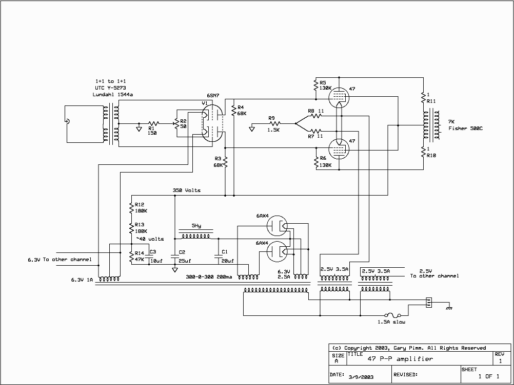

It all started nearly 20 years ago, when Gary Pimm introduced his push-pull 47 DHP amp to the audiophile community. I must've entered a mid-life crisis (which still shows no sign of abating) and decided that I had to build that.
I've assembled most of what was needed, except OPTs; PTs and chokes came from Peter Dahl of Texas (yes, I decided on monoblocks), and I talked Gary, who displayed an angelic patience in answering all of my idiotic questions, into building the CCS and servo boards for me.
Then I developed cold feet. Or, perhaps, some thing have their own timing and are guided by their own stars. I remember getting involved with vintage amps and doubting my talents to build something of equal quality. Also, I didn't have a reasonably efficient pair of speakers to match with the PP47, but now having built 3 pairs of Coral Holy Basket based speakers (one bookshelf and two Frugel horns), I told myself 'now is the time'.
Gary's CCSs still have all the juice, and I'm following his advice to run it for a month before wiring in the servos. I'm using power switching supplies to feed DC to the 47s and finemet 14K OPT from Audiofeast/Terramoto which fit nicely under the chassis.
What can I say? My heavily modified Ampex 6973 monoblocks, the creme de la creme of vintage gear do not hold a candle to these PP47s. Which fills me with daring thoughts to sell the Ampexes along with a bunch of other gear and put the money toward a stereo version of PP47 ... Tabor perhaps ... SS Tabor (see the brazenness, and no, it shan't take two decades).
Anyway, here are the pics. And let's hope that they may trickle down to Gary's attention because his old email and another that I found are not delivering.

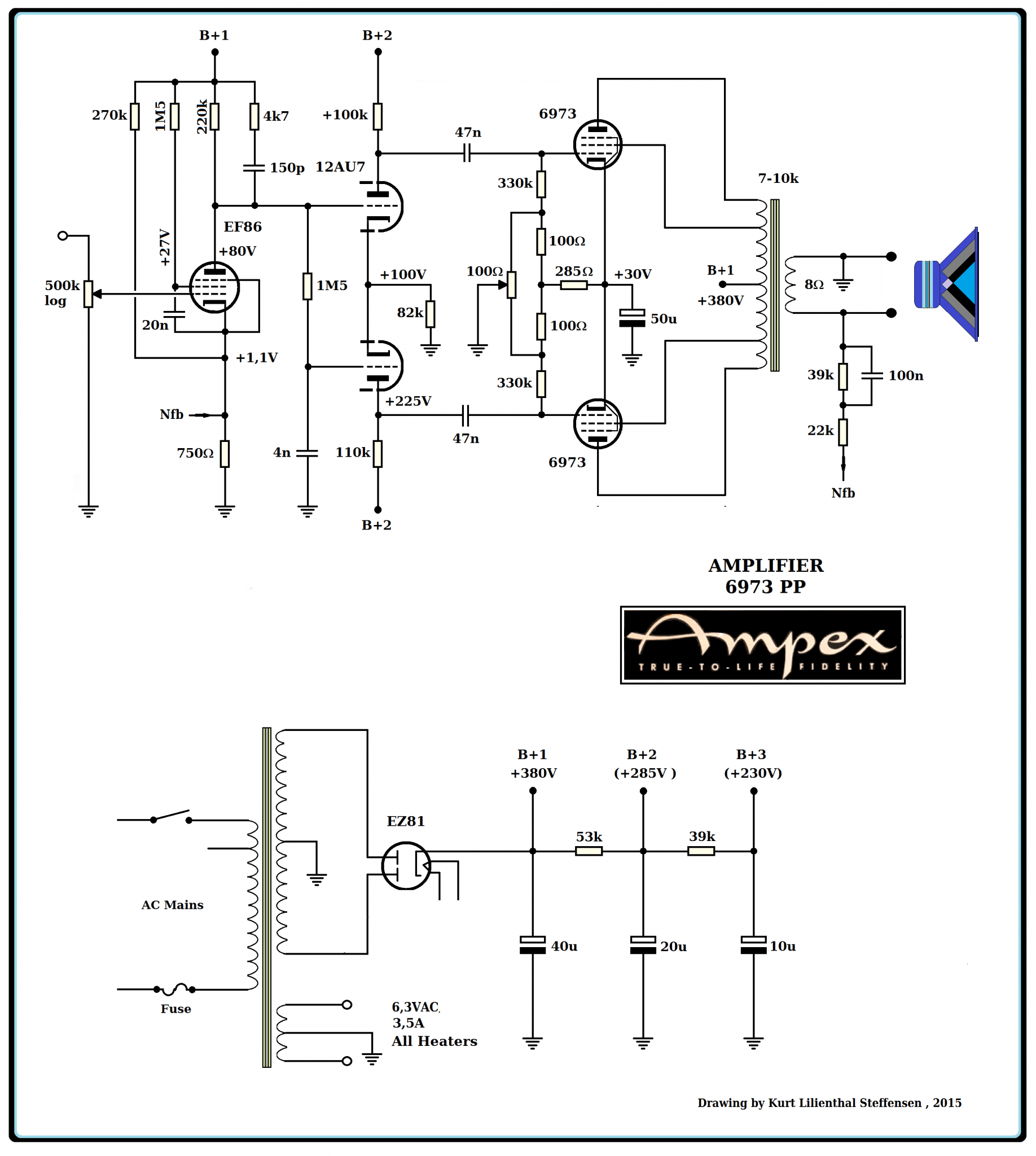

Looking at that Ampex schematic, maybe someone more knowledgeable could explain what is going on around the driver.
1) The 4k7 + 150p is some sort of band pass filter?
2) How does the 1M5 resistor + 20n cap set the potential on the screen?
3) the 270k from anode to cathode, is that a divider with the resistor not pictured (750k), or local feedback?
1) The pair make an ultrasonic low-pass filter, part of frequency compensating and stabilizing the negative feedback loop.
2) The 1.5 M resistor sets the screen voltage, the bypass cap keeps the screen voltage constant with respect to the cathode.
3) The 270K resistor in combination with the 750 Ohm cathode resistor adds some fixed bias to raise the plate voltage of the stage to match the desired operating point of the direct-coupled long-tail phase inverter. Lowering the plate or screen resistors or raising the cathode resistor could also do this but all would lower the gain (and reduce feedback).
