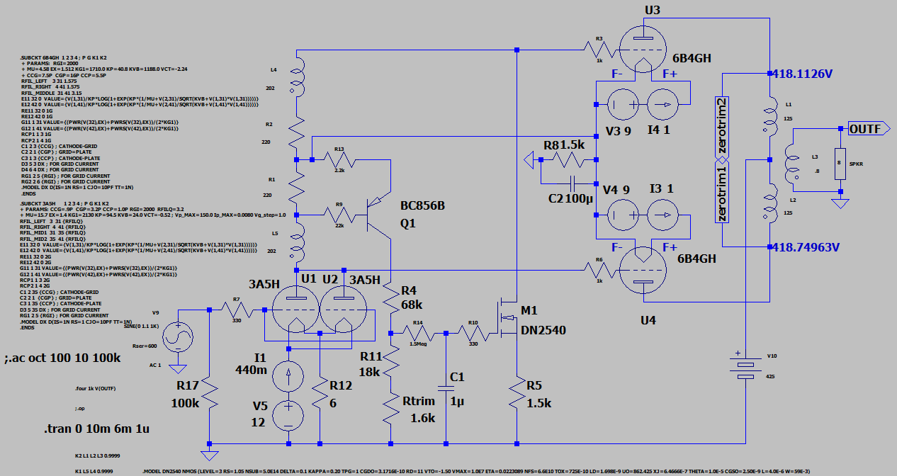

I don´t follow you here, I draw separate regulators, but I now included a common voltage source/raw DC. Better?:

If you need help, I can explain to you. I´ll give you a clue: The anode transformer with the current sensing resistors in the center is the secret, as it acts as phase splitter and the sand parts balances the currents through it. I used LL1667 in the schematic, but Slagle will design the actual one.
Dave Slagle came with the original idea After that Rod Coleman helped adding the servo circuit and they both understand the circuit. Anyne who can read a schematic also will.

Seems you didn´t read the last schematic, where it is shown that you measure over the primary OPT windings and then adjust for zero reading, if we assume the primary windings have the same series resistance(if not it is a simple task to calculate the expected voltage difference). By adjusting Rtrim this matter will be taken care of even if the driver tube drifts. In the design process it can be worth checking how the anode choke and the OPT primary currents interacts. Work in progress, designing must be in the virtual world, before building any listenable prototypes.

Seems you are not enough into circuit designing, AFAIK Rod built it.
Download LTSpice, it will probably save you a lot of manual work building prototypes, once you get the hang of it.
#23. This is a screen dump of the *.asc:
