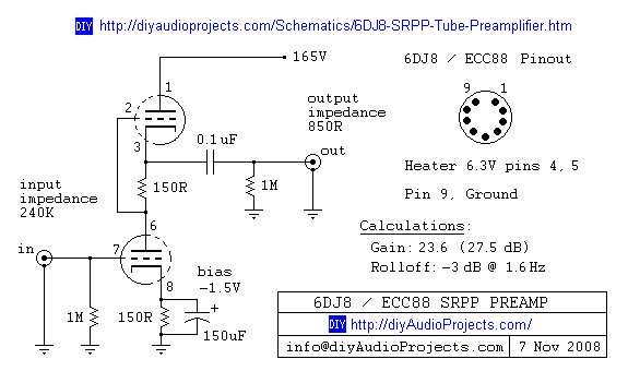

I found this schematic. B+ is spot on for what I've got to work with. Anything scary about it that you can see?

Did you use a single triode, and a plate load resistor?
Or did you use the schematic in Post # 37?
6mA in that preamp would only have 0.9V bias.
What is the signal source that drives the volume control, and from the volume control to the 6DJ8 grid?
What is the voltage output of the signal source?
A typical CD player has 2.0 Vrms out (2.8V peak at full scale signal).
Your preamp schematic with only 6mA, and 150 Ohm bias resistor only has 0.9V bias.
0.9V / 6 mA = 150 Ohms
The 2.8V peak from a CD player is over 3 times larger than the 0.9V bias.
If you only have 0.9V bias, the preamp needs to be used to amplify a smaller signal, like a phono cartridge.
Perhaps your preamp was oscillating at VHF, and only drawing 6mA average (Very High Frequency RF). No grid stoppers, and the wiring placement might have caused that.
But with 165V B+, there was only about 82V across each triode, less than the typical 90V in the data sheet standard operation.
Was the 6DJ8 tested for emission?
The schematic in Post # 37 is an SRPP stage. It is not a cascode stage.
What is the schematic of the 6DJ8 circuit where you only got 6mA with 165V B+?
I haven't tried the schematic in post 37. I just found it while looking for 6DJ8 amplifier schematics. I was using a single triode with a plate load resistor of (i think) about 10k, and I was feeding it audio from my bench PC. I'm not sure of the signal strength. I'll be able to take measurements this weekend. Another thing I've heard about the 6DJ8 is that it likes to oscillate. I've seen it said that the grid stopper needs to be right on the tube socket. I planned to do that in final implementation, but it's problematic with the breadboard/prototyping setup I have at the moment. It's possible that it was indeed oscillating at a very high frequency. To my knowledge, neither of the two 6DJ8s that I have were tested for emission. I bought them from a reputable seller on Ebay, but it's Ebay so that could mean anything at the end of the day.
When you do the measurements this time, check the bias voltage, the plate to cathode voltage, and the plate current (if the grid is not drawing current, the cathode current is the same as the plate current; and with self bias, is easy to check: current = cathode Volts / Rk Ohms).
Then, find the plate voltage and the plate current on the tube graph, and see if the grid voltage lines show that the bias voltage you have intersects with the plate current and plate voltage that you got.
It should be close, unless the tube is bad, or the tube is oscillating.
The 6DJ8 is a high transconductance tube.
At medium plate current, the 6DJ8 will change its plate current by 12.5mA/Volt of bias change.
A little change of bias voltage makes a large change in plate current.
80mV bias change = 1mA plate current change.
With a resistor in the plate circuit, the change will be less, because the plate voltage will also vary as the change in plate current causes a change in the drop across the plate load resistor.
With a 10k plate resistor, a 1 ma change in plate current will change the voltage drop across the 10k to change by 10Volts.
At medium current, the 6DJ8 plate resistance is about 2.5k (in round numbers).
A 10Volt change in the plate resistor voltage drop, will change the plate current by the amount of
2.5k x 1mA = 2.5Volts.
So if the plate load tries to change by 10Volts because of a 1 mA change in plate current, but the plate tries to change by 2.5V because of a 10V change from the 10k . . .
that interacts to give the actual voltage that it settles to.
But, it should land somewhere near the plate curves, at the intersection of plate voltage, plate current, and grid bias.
Otherwise, we are back to either an oscillation, or a bad tube.
