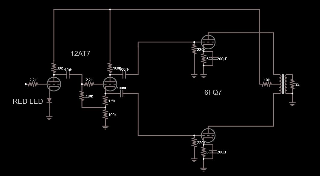

I've been prototyping headphone amplifiers for some time now, using tubes I have on hand from TV pulls and whatnot. I currently have a more-or-less textbook 6FQ7 push-pull triode setup with a 12AT7 preamp and phase inverter. It's fed into a 10k:600 OPT and sounds good to my ear. B+ of 390v. Plate voltages and current are all in spec. I'm curious about its actual output impedance though. That OPT is almost certainly not ideal, the 600ohm secondary notwithstanding. I've attempted to learn how to figure it out, but so far it has eluded me. It'll get plenty loud for 98% of music out there, but I would appreciate a tad more headroom in case it's ever needed. I was looking online and found a good bit of praise for the 6H30. It has overall higher plate dissipation at 8W for both plates combined. The 6FQ7 is 4W each or 5.7W total. I've also read that the 6H30 has considerably lower output impedance. That being said, I have no idea what said impedance would be with two 6H30 triodes in PP. Can someone clue me in? Is it worth buying $70 worth of new tubes or should I look into a different OPT for what I currently have?

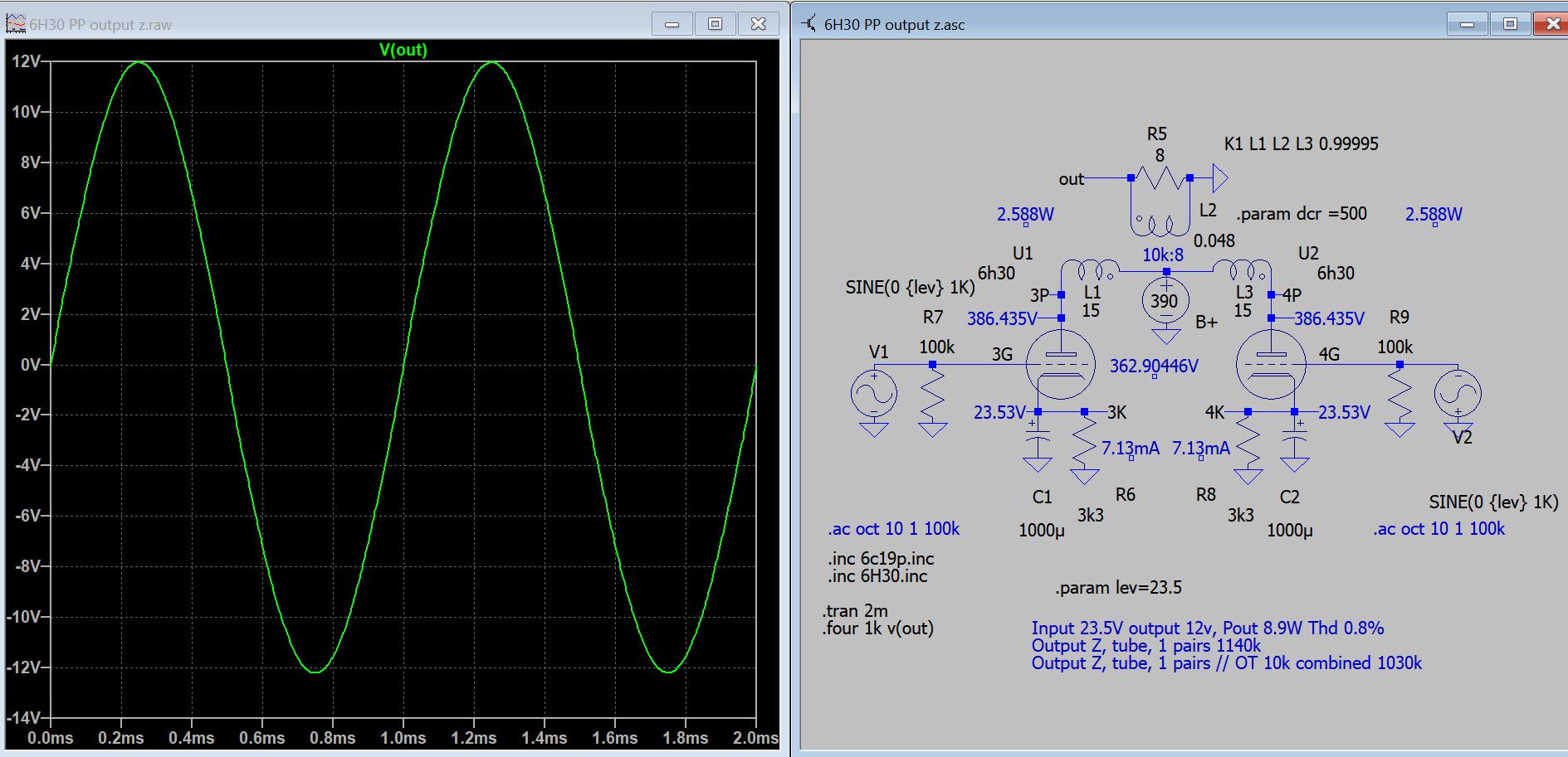

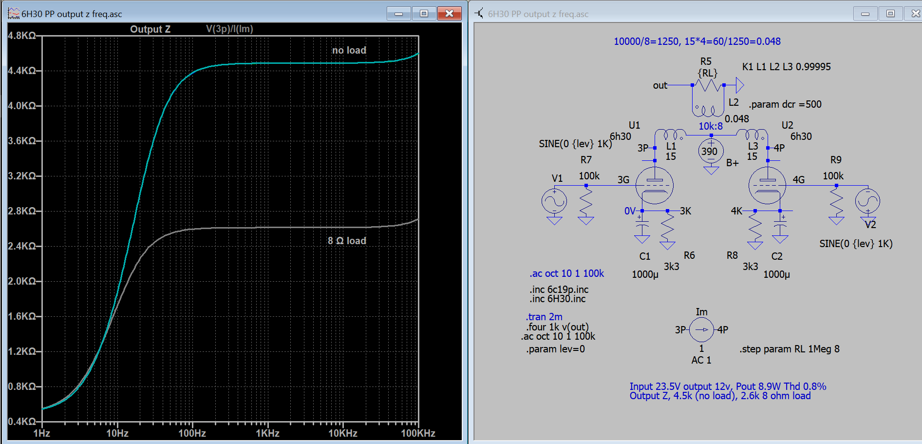

See if you find any useful data from this sim based on your configs. How many output watts you're getting now? With 6c19p gets only 2 Watts more, but with a lower Z OT, output maybe increased, as now 10k/4.5k=2.2 rp:OT ratio.
If you have a DVM load the amp's output with say 30 ohm and measure the voltage across it at 50, 500 and 5000 Hz playing sine waves. Do the same with a 15 ohm load. That should provide enough info for a rough calculation at three freqs.

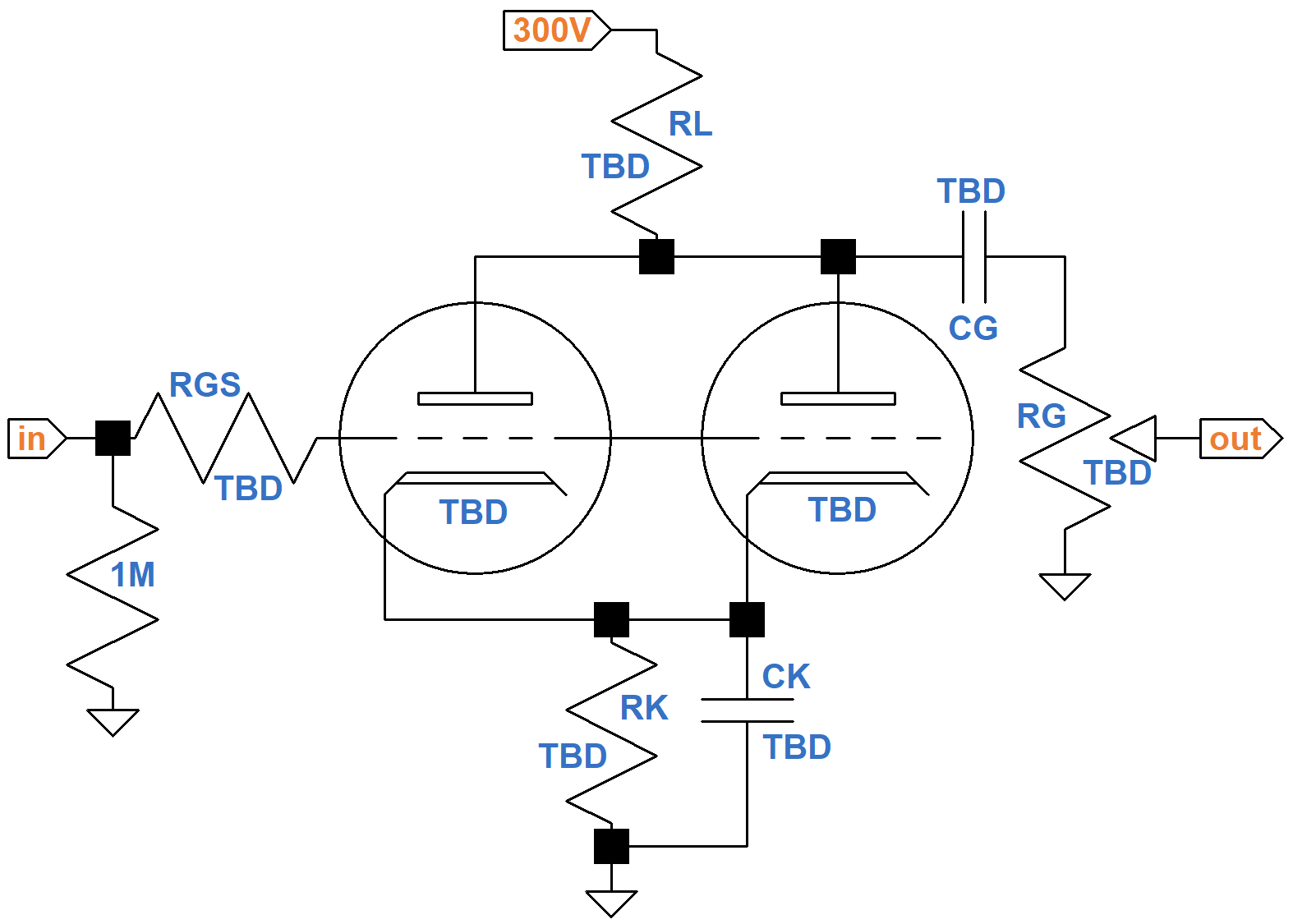

The ECC99 is cheaper and results can be quite good. If one wants enough power and low output impedance can use 2x ECC99 per channel, which means parallel push-pull. This can give easily 1-1.5W in pure class A operation with lower plate voltage around 250V (also making power supply cheaper) and low output impedance around 150R using the 10K:600R transformer. Each tube can work at about 18 mA and this will make plate dissipation 2.25W per triode against 3.5W max recommended with reasonably good life.
The 6H30 can give similar output impedance only using 1 triode per channel but not the same power otherwise won't last long if will work close to max power dissipation....this could easily result in being more expensive (i.e. 6H30 life is less than 50% of ECC99 life).
2 6P1P (or 6V6 etc) triode strapped per channel would work nicely into 10k and give nice linear results with almost 2W of power.

I've included a schematic of what I've got now. I drew this from memory, but I think I got the values correct. Now, by "parallel" do you mean something more akin to the image with the white background?

Thanks for all the replies. The headphones I have now are 32 ohm, I think. They're just a pair of cheapos. I'm planning on getting a pair of Grados though, and I think they're also 32 ohm.
Then your tubes are working into 5K and not 10K. You have to either design the amplifier taking into account 5K load (6V6 or other small power tubes are surely more suited than signal tubes like 6FQ7, 6H30 and ECC99 if you also looking for some power) or change transformer to one with secondary for 32R load.
Third option, if you want to use tubes like 6FQ7 with higher plate resistance is that you look for a headphone output transformer with primary impedance in the 15K range for parallel push-pull or 30K for PP, in both cases with 32R secondary. Multiple secondary choice is also a good thing in case you want to change headphones with different impedance.

You could also do the contrary of what you are doing now: use a common output transformer with 16R secondary with 32R load. This will double your primary load. If the transformer is decent quality inductance will be more than enough.
For example you could try with the EDCOR GXPP-12K with 16R secondary.
Using 32R headphone you will get 24K primary impedance and can use just 1 6FQ7 or ECC99 per channel.
