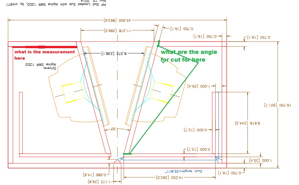

I made myself a sketch of the SWR 12D2, and turned the drawing around, to have a better starting point.
Now we'll have to know what changes can be made to make driver mounting possible through a front slot (one could make part of the side panels removable, and mount from there?).
You are right, the slot needs to be 8.375 wide minimum to fit second driver in. Cabinet will be 35.75 wide now. I wonder if that is too wide for the OP?

I added the dimensions you asked for into the drawing. I just use the software to put in the dimensions, so some numbers end up being a bit strange, but it's not necessary to get this to the last thousands. I also checked the cross-sectional area behind the driver, it is just a little bigger than before (You could use the added area/volume to add a brace @ the input to the duct, e.g.: a 2x4 w/ a rounded corner. I put it in the drawing in dashed line.)) The duct is the same length I measured in the other drawing.
Wait for xrk971's AkAbak simulation to see if anything has to be modified.

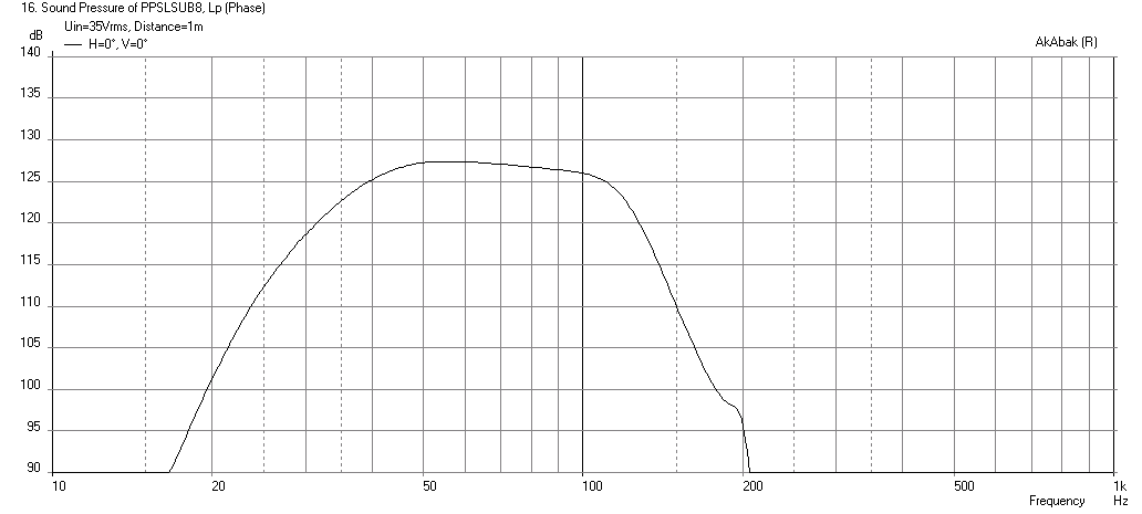

Here is the response with an 8.5in wide x 13.5in tall slot chamber. This should be big enough for you to slip the two drivers in during the installation process. The bass extension is now 36Hz at -3dB with an output of 128dB at 35volts. Seems like it should work just fine.

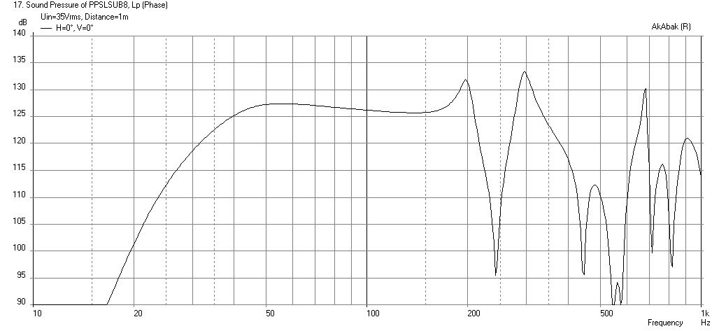

And here is the output with just the angled waveguide, no seatback duct at 35v (less bass extension but can extend higher up to 150Hz), shown with 120Hz LPF:

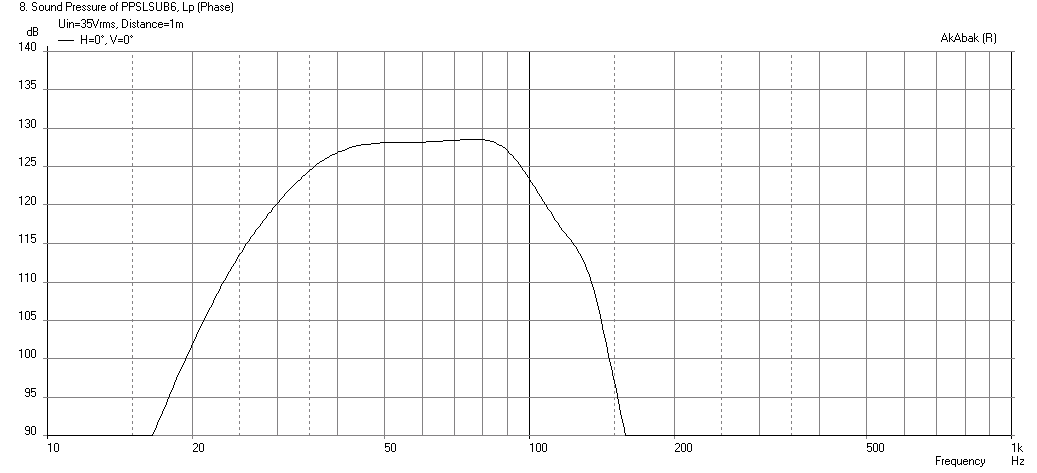

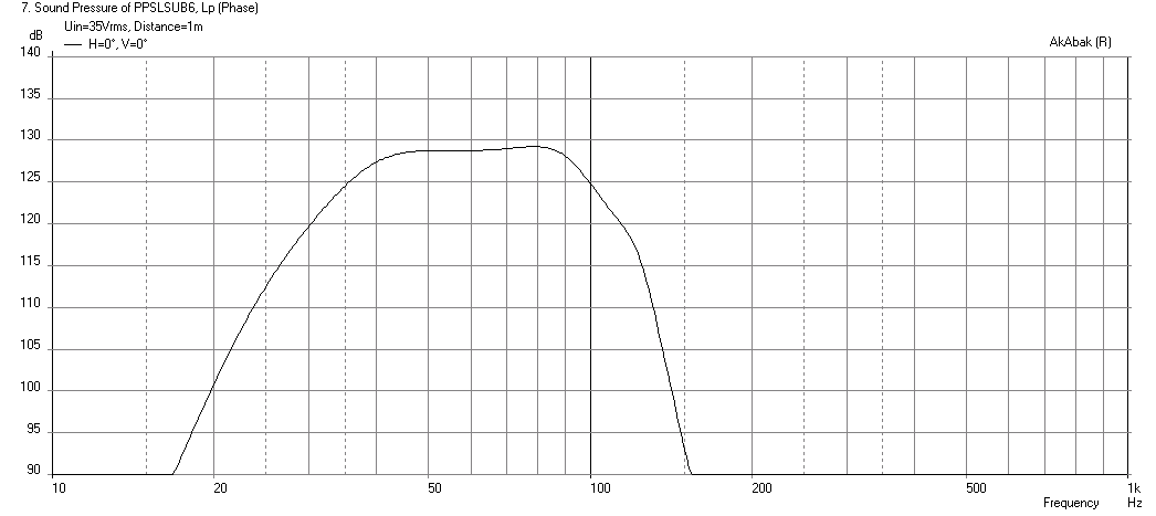

Here is the predicted response with the angled waveguide slot followed by the duct leading through the seats. Looks about the same, maybe a bit less SPL and bass extension is still around 36Hz at -3dB. This is for 35volts input:

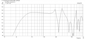

Here is what it looks like without the 12in duct leading to the seats (and no LPF) - very wide bandwidth:
Here is the with the angled waveguide slot followed by the duct leading through the seats. Looks about the same, maybe a bit less SPL and bass extension is still around 36Hz at -3dB. This is for 35volts input:

I'll attach a drawing revision showing the push-pull drivers, and the added dimensions. I would recommend to widen the front slot by about 1/2" for push-pull, and to build a quick trial mock-up to see if you can reach the mounting screws.

Thanks for the drawing. I don't have any problem making the front slot 1/2'' wider,wouldn't that change some of the measurements and layout.

Post #57: "...wouldn't that change some of the measurements..."
Yes, it would. There are a number of ways of doing this, the simplest is to just widen the box by 1/2". Push left and right box away from the center line by 1/4" each. I like that method. But you'll still have to make sure that you can mount the drivers, i.e.: make a simple mockup.
My driver drawing is not a drawing of the actual item. The outside is an overlay of the factory drawing to the factory dimensions. I'm guessing at the position and shape of the cone. That's only a starting point, you'll have to verify that it fits.
