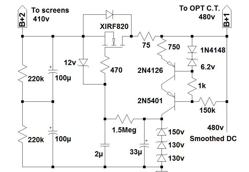

ray_moth said:This is my preferred screen stabilizer at present. What do you think?
Simplicity will do for screen regulation.
However those HV zeners with all the drift aren't for me.. Why the 75 ohm resistor ? .. You are relying on the 33uF for ripple rejection; the o/p could use a single 450V o/p cap.
My favourite would to use a 2nd mosfet and an ic to do the dirty regulation work. .
O.M.O.
richy
I use one resistor where you use a complex CCS.
I use a resistor where you use zeners !
Current being constant, voltage is constant too . . . .🙂
See post #21 above.
See post #21 above.
Yvesm said:I use a resistor where you use zeners !
See post #21 above.
Is your CCS more stable than my Zeners? Is it less temperature dependent?

CCS might help isolate PS noise allowing a much simpler PS filter.
I use the same CCS + resistor arrangement for G1 fixed bias because
it's stable and adjustable. There does not seem to be much drift as
the MOSFET warms up. I think it is within 1-2% in the first second or so.
Is your MOSFET on a heatsink? Very interesting... Mine don't seem
to be that sensitive but it's something to look for. Could it be more
sensitive at higher current?
Michael
It is BSP225, heatsink is a copper resistor lead soldered to it, current is 8 mA, voltage is 100V. The whole amp has 27 dB amplification, and infra sound disturbance when I blow on it is about 10 millivolts (against 100V P-P max needed swing), i.e. -66 dB approximately.
Edit: typos corrected

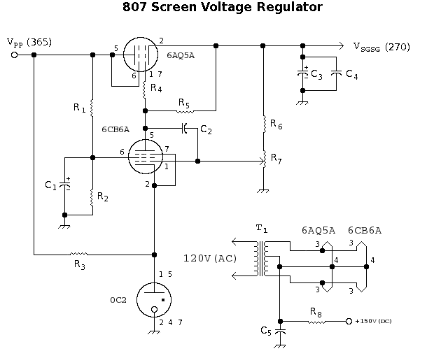

Screen Regulators I
Here are two designs for active screen regulators I actually used in projects. Both are variations on the usual solid state theme. This one uses a 6AQ5 (trioded) as the seies pass device, and the 6CB6 high gain, VHF pentode as the error amp. The 6CB6 works nicely here since it has a higher than usual Vhk rating.
