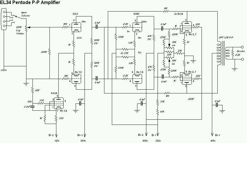

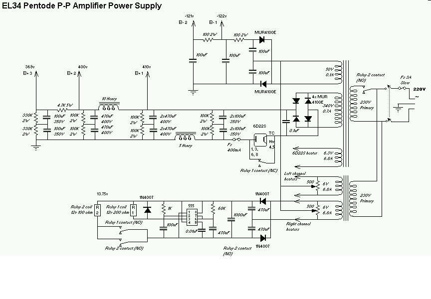

richwalters said:
Simplicity will do for screen regulation.
However those HV zeners with all the drift aren't for me.. Why the 75 ohm resistor ? .. You are relying on the 33uF for ripple rejection; the o/p could use a single 450V o/p cap.
My favourite would to use a 2nd mosfet and an ic to do the dirty regulation work. .
O.M.O.
richy
Hi Rich, thanks for your comments.
I agree about the driftiness of HV zeners, and they should probably be replaced by a string of VR tubes (two OA2 and one OB2 should do it). I could use a long string of the "magic" 6.2v zeners, which are drift-free, but it would require 66 of them!
Yves makes the point: "I use a resistor where you use zeners! Current being constant, voltage is constant too." It's probably an excellent solution. My CCS is in there just to drive the zeners under the conditions of varying B+, the amp being in Class AB1, but it could drive a resistor as he says. I think I'll try that.
The 75 ohm resistor is there to provide some protection to the MOSFET in case of a short.
Ripple rejection is provided by a previous pi filter with 50uf-5H-470uF (not shown), plus the 33uF cap - mainly to suppress zener noise, plus the 1.5Meg/2uF combination - which also gives a slow start for the screens.
The OP caps are in series because the ones I have are rated at 350v, otherwise I agree that a single cap of 450v rating would do.
