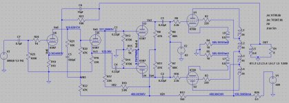

I have disconnected phase splitter and preamplifier and I'm just working with the P-P output stage to get this buzzing sound away. The circuit I'm working is looking like this (inductances are estimate):
V1 is HT with about 370V and 500mA ripple voltage. There's CLC-filter and the ripple is more or less sine. BIAS is about 33V with about 20mV ripple and there's CRC-filter.
Please look at my Williamson simulation in LTSpice. It is actual schematic not only simulated, but also actually built and measured.
Your drawing either omits necessary details, either build prototype have errors.
1) Try to decrease grid leak resistors from 150K to 68K.
2) What is primary inductance. leakage inductance, and resonant frequency of your output transformer?
3) Have you tried to switch from UL to penthode or triode mode? Any changes?
4) Look for cold solder joints at grid pins of the tube sockets or elsewhere.
Sharing photo of your actual build may really help.

I took a 200Mhz analog scope and started to measure different points. There's no any other oscillations which I hadn't seen with my digital scope. The spices were not seen in the bias- or HT-voltages.
Then I tried to remove 6550-tubes and measured the anode pin without the tubes. I was still able to see faint spike with the scope. So it seems that somehow the rectifier switching noise is magnetically coupled from mains transformer to output transformer. And this is inducing oscillation.
