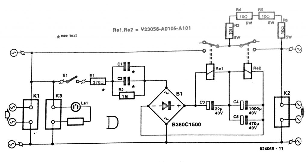

The turn on surge to the main power supply cap is around 447VDC, and the cap is rated at 450VDC. After 15 or 20 seconds when the output tubes are conducting, the voltage is around 400VDC.
In this case just a resistor and a timed relay should solve this as i assume you use bleeder resistors over the HV capacitors anyway.
