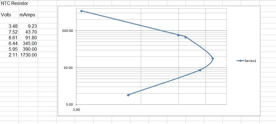

Sample Plot
Taken very slowly, sometimes waited for several minutes to stabilize.🙂

jhstewart9, if there was no inrush, the NTC has to be designed to heat up in temperature to a level where the NTC resistance is low enough not to significantly modulate with changing equipment current - ie. the equipment must present a minimum level of continuous current through the NTC.
The NTC must also survive a transient in-rush situation, where the current through it, and hence transient internal dissipation can get quite high as the bulk NTC temperature rapidly rises and resistance rapidly falls. Datasheets present that scenario as a level of capacitance that can be charged up for a given line voltage.
The application really needs to allow the NTC to cool back to ambient (reset) before it is asked to perform inrush protection again - hence the thermal time constant that is often more than a minute.
The design process for integrating an NTC in to anything other than a basic switchmode mains connection application does require a good awareness of how an NTC works, and just guessing at a suitable NTC part and what it will achieve can naively lead to poor outcomes.
