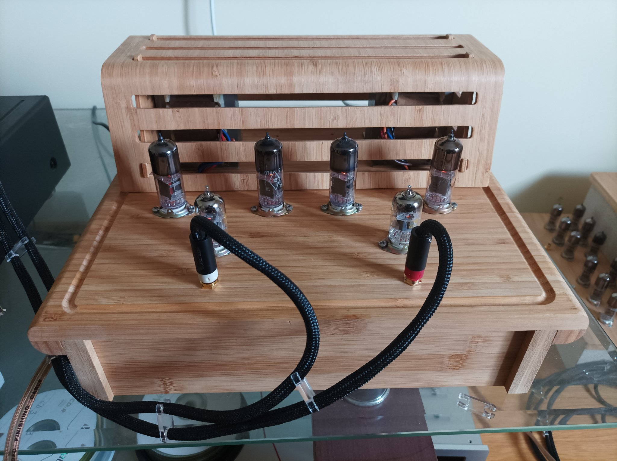

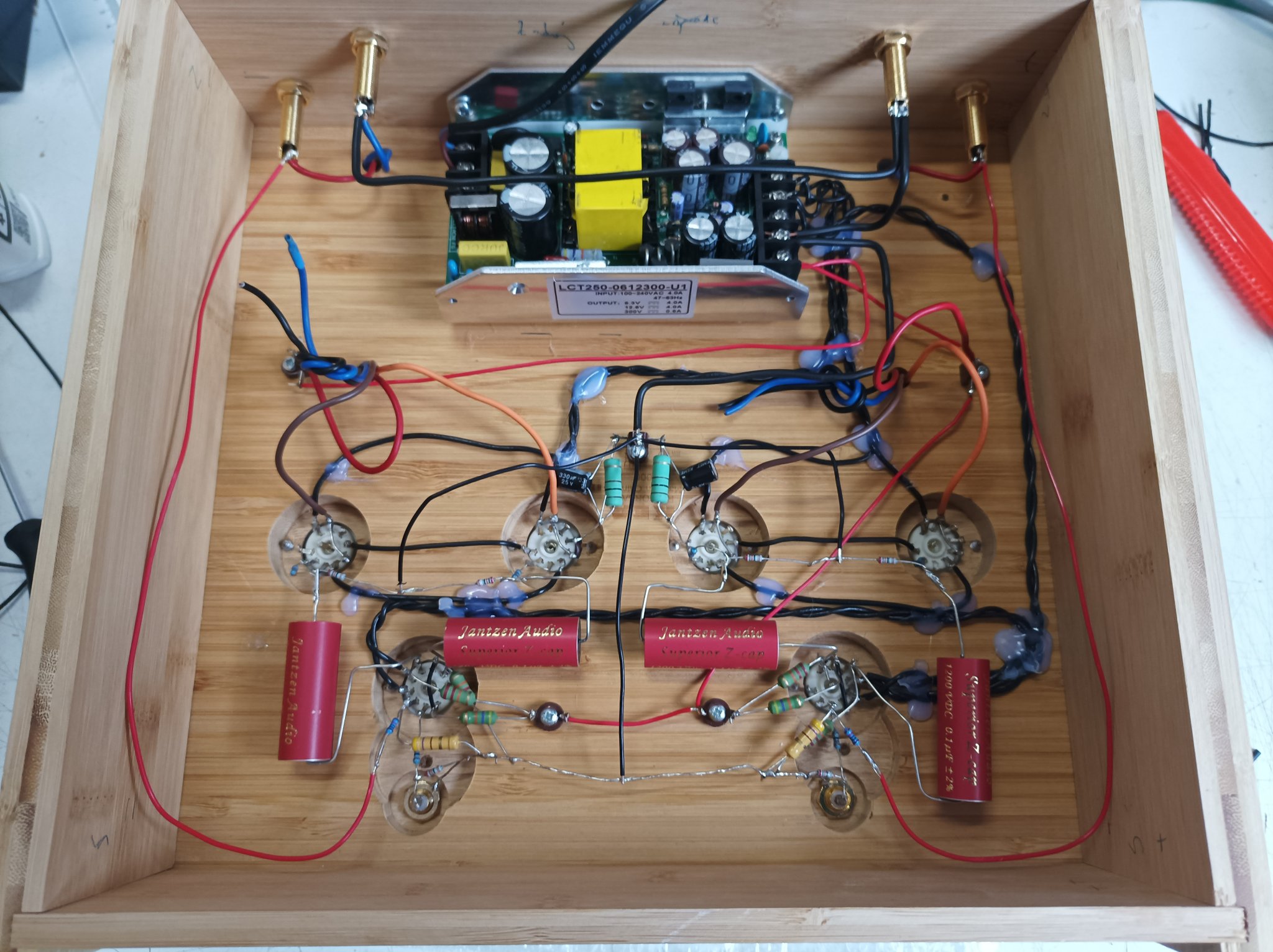

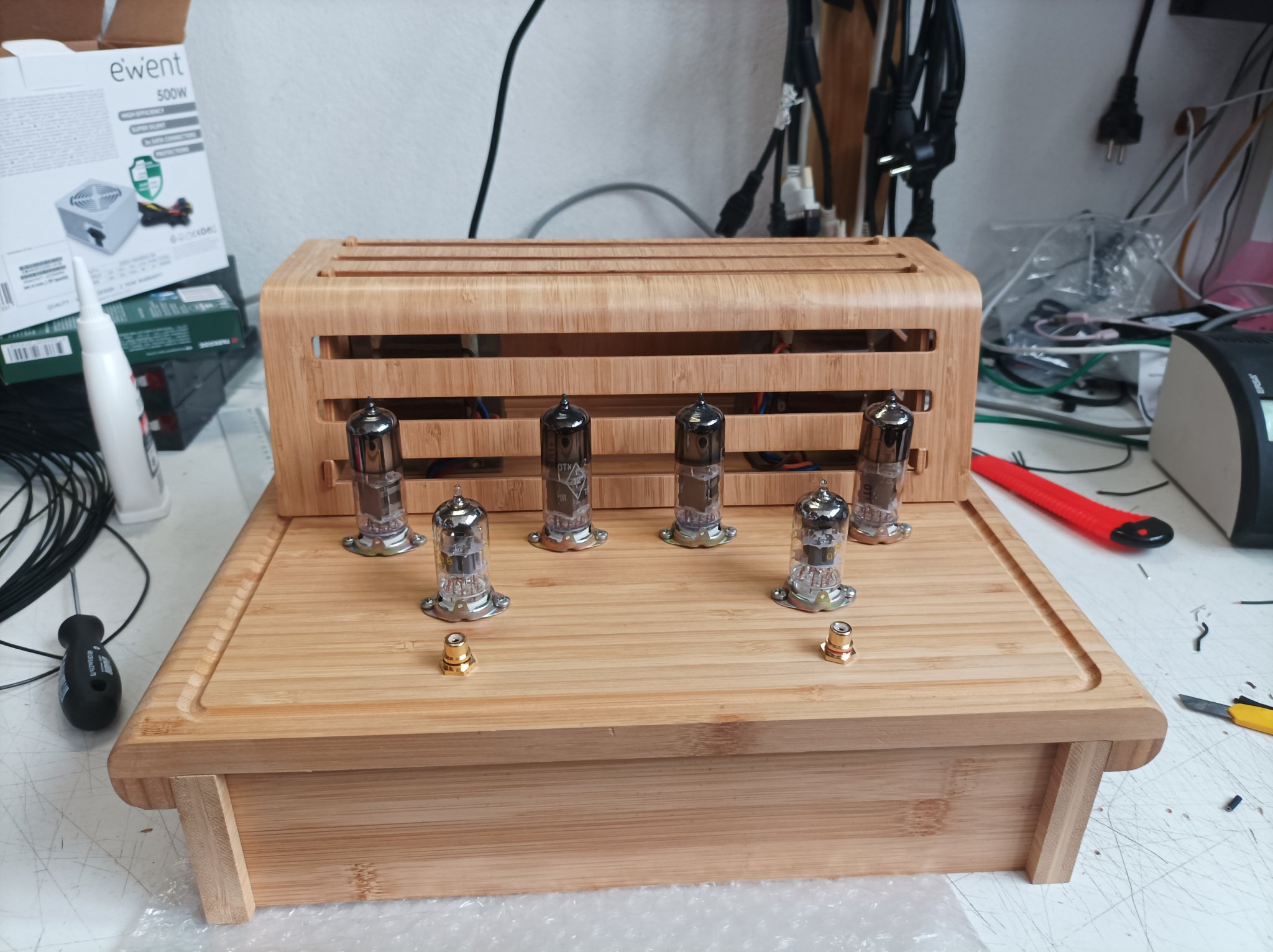

Hello,
it took me again to make myself a new amplifier. This time I took a PCC88 (TESLA) for the input triode and phase shifter. As the final tube, I used 6E5P in triode connection. The result is very encouraging.
Another interesting thing, I used a cheap Chinese switcher (approx. 35€) for the power supply.
Not bad at all...
