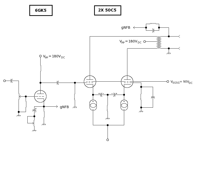

Here you go, as promised. Not exactly what I would do, but it's pretty simple.
Nihilist said:
Are C1 and C2 absolutely necessary, or can this be run without them ?
99% sure that you can ignore them. I included them on my schemo just because I had that page open, but I've only actually had input caps once on an amp.

If you're going with that design, I would implement it as shown here (attached). Keep in mind that this particular design will be strictly Class A, and so no benefit of higher output power that you get from Class AB operation.
Is there a way to implement a Long Tailed Pair for the 6V6's , or is that reserved for driver circuits ? If it can be done with output circuits, can it be used with the phase inverting format like in the schematic ?
Give each 6V6 its own tail load, so that these operate separately so far as DC is concerned, so that you may set the Ipq's of each 6V6 to the same value to minimize any DC core magnetization that otherwise might occur. Connecting the cathodes together through the coupling capacitors makes the stage an LTP at AC. You need a 1.0M resistor from the center of the capacitors to ground so that these will polarize properly, as they will need to be some big electrolytics (figure 2200uF at a minimum). These should be good quality, and bypassed with smaller capacitors (~0.1uF -- 0.22uF, polypropylene) for better high frequency performance
So far as paralleling the halves of the 6SL7, simply connect: K1 to K2; G1 to G2; P1 to P2. Don't forget that after doing a loadline, that Ip doubles, and your actual Rp= 0.5Rp (design nominal). The effective r(p) is also cut in half.
Some audiophoolz might complain about this, but t'hellwiddem. Only one way to find out, and that's to try it. If you like how it sounds, great. If not, well, you'll know what not to do the next time. It won't be a complete loss.

My understanding is that they need to be twice the normal calculated size of a bypass cap. this is because they are in series and so their effective value is halved. I have used this scheme in three amps (thanks to Brian Beck for the original idea) using 1000uf caps, all have been very low output impedance designs - and all have had response down to 10hz.
Hope that helps.
Shoog
Right, I knew that part 🙂 I guess it is that a typical Rk bypass is sized considering, roughly, Rp + rp in parallel with Rk. Rk here is near infinite here, so I am wondering why we can't get away with a single 100u motorrun or something?
In other words, considering these to be two SE stages, Rk bypass would be considerably smaller, and if each stage just had a cap from the cathode to ground, the signal path would be largely the same with smaller caps. I am likely totally wrong, of course, but I am just trying to understand what's going on.
I have seen one implementation which uses a10uf cap which obviously worked. These were bypassing 6080 cathodes. There was talk of a resonant tank, but I wouldn't use a resonant tank in this position.
I suppose its one of those situations where empirical data is lacking (because no one implements this stage) and so a bit of experimenting is in order. Consider that the electro caps are in back to back series - which by all accounts linearizes their response. My experience is that it sounds better than simple cathode bypassing with the same electros. Better bass and cleaner highs.
Shoog
Alright, I'm sold on the use of a CCS. Their cheap enough and simple enough to implement . I am planning on going with Yeo's LMCCS , I can get the LM317's from Rat Shack .
Will I need to run a heatsink on these ? I plan on using one for each device .
I'm assuming the cathode voltage falls into line due to Ohms Law and the use of a current source ?
In the schemo's listed with the "back to back" electrolytics , do the caps need to be of the "non polarised" variety ?
How critical is the 1meg resistor that polarises the caps ? Is it important enough that I would need to use a quality resistor, or can I just use a carbon that I already have ?
You provide a DC reference to avoid that.
All that resistor does is provide a DC reference. There won't be any significant audio current through it, so it doesn't need to be one of those audio "Magic" resistors.
