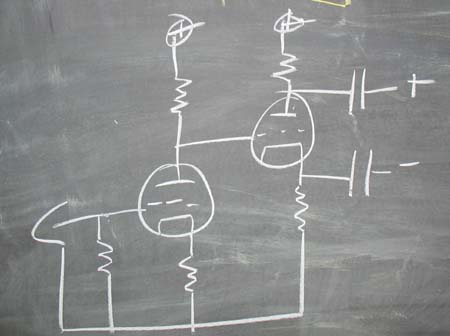

That looks like it's going to distort heavily. There's not a whole lot there to force the two triodes to balance closely.
510K on the anode of a 6SL7 is pretty harsh. I'm not even sure it'll work properly.. if you're going for a Long-Tailed Pair, you want to read this link and re-do some math:
http://www.aikenamps.com/LongTailPairDesign.htm
That's a simple approach that just uses resistors, but if you want to get perfect balance, try an LM334 instead of the 1.2K resistor fed by a small negative supply rectified off of your 6.3V heater winding.
405V (375V a-k) is really harsh for any 6V6. I really wouldn't recommend it, especially not with those Russian tubes.. I've heard they're fragile. What's the primary impedance of your output transformer?
A word to the wise: Trioded 6V6's put out a really disappointing amount of output power, typically around 4-5W in push pull. But hey, you're looking at vanishingly low distortion, so if you have 98dB+ speakers, it might be the thing for you.
Cooking the tubes to squeeze some more wattage out of them isn't really safe.
What does your power supply look like? Could you maybe use some beefier tubes instead of 6V6's?

Nihilist said:
I guess subtlety isn't one of your strong points. :xeye:
Something came up and I couldn't finish the post.
Perhaps instead of telling me it SUX, you could tell me WHY it sux ?
You can't run a 6SL7 that thin and expect it to drive a final. The 6SL7, being designed to operate with very small plate currents (as little as 100uA) likes loads that are Hi-Z and Lo-C -- and that doesn't describe the grid circuit of power finals. With those huge plate resistors (unless you're running off a 1000V rail) mean a very small current. There won't be enough current sourcing at the grids of the finals to charge up the Cgk + Cmiller + Cstray at the higher frequencies, and you'll have a slew problem. The behaviour on transient over drive is also going to be hideous since the 6SL7s will roll over and die at the first hint of grid current.
Better to run them hotter, and include a negative rail for a larger tail load for the LTP. Better still would be an active tail load. All these problems Poindexter addressed in the design of his front end.
I'd suggest a different VT for the front end, but if you simply must have 6SL7s, them I'd suggest using cathode follower grid drivers (6SN7, 6FQ7, 12BH7, 12AU7 (even that one will work here)) Run 'em off a negative rail and you can use fixed bias on the finals. Also, source followers work nicely for this as well, and both will present the 6SL7s with a much friendlier load than any final. That'll take care of the slew rate problem and greatly help out at the high end.

As a way to not add many additional parts, not add a negative supply, and drive the outputs a little better, how about a grounded cathode to cathodyne splitter?

Nihilist,
Some obervations on your amp design:
1.You cannot bypass the cathodes of the 6SL7, because you're using it as a cathode-coupled (A.K.A. LTP A.K.A. Schmitt) phase splitter. If you bypass the cathodes, where's the signal for the lower triode going to come from?
2, It shouldn't make any difference whether or not you bypass the cathodes of the triode-connected 6V6s if they're well matched, but you can try it to see if it sounds better. It won't affect the gain because the cathodes are strapped together,
3. A plate load of 510k for each 6SL7 is about 4 times what it should be. In any case, it is shunted (at signal frequencies) by a 1M OP stage grid resistor.
4. As said, a 6SL7 should not be used to drive 6V6 in triode mode. It's able to drive the 6V6 in pentode mode, but not triode.
5. The 6SL7 LTP as designed will work very poorly, because there is too low a voltage between cathodes and ground. The simplest way to overcome this problem would be to elevate the cathodes by either adding a bias resistor (as in Aiken's example) or using a potential divider from B+ to the grid of the lower 6SL7 to ground. Either way, you'll need to use an extra cap on the IP grid (of the upper 6SL7). With the cathodes elevated, you will need to use a higher value of common cathode resistor or, far better, a CCS using a BJT cascode, ring of 2, or other SS device(s), for proper balance.
