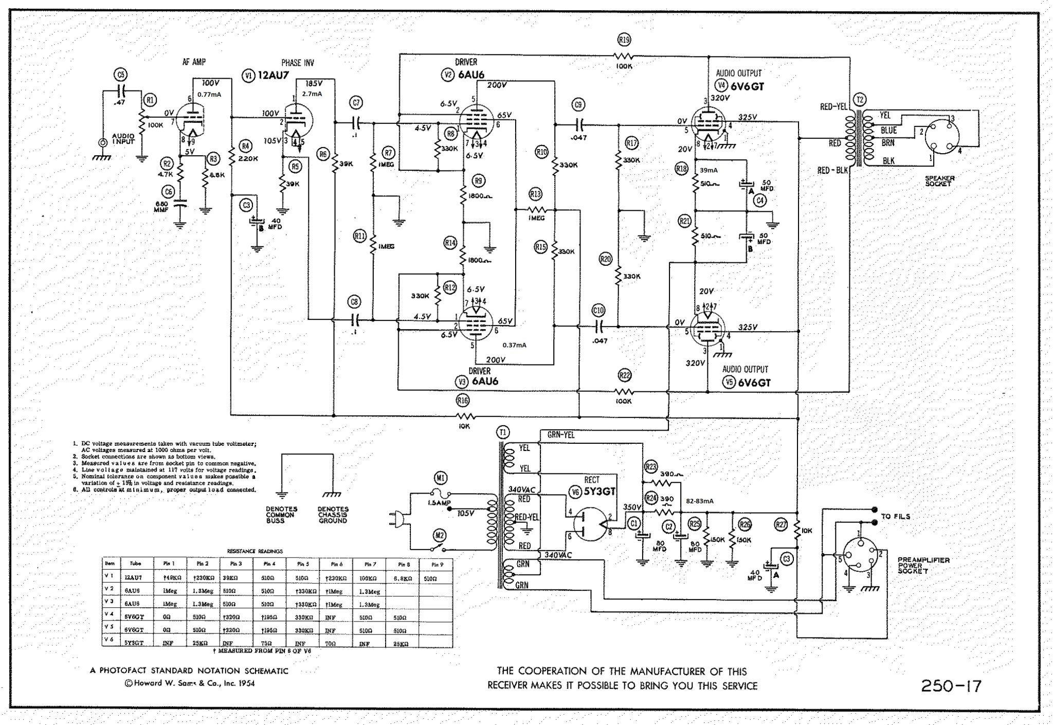

I'm trying to decide on a push-pull amp to start building. I have most of the parts required, including transformers, and a couple of hand-me-down chassis I can use. I was thumbing through one of my old copies of the RCA Receiving Tubes manuals and found this in RC-19:
R18 and R19 (100k) take signal off the 6V6 plates to the 6AU6 driver cathodes for NFB.
R9 and R10 (330k) are a mystery to me. Simulation shows they increase the NFB a little. But how? I guess they feed a little output signal from the cathodes to the grids of the 6AU6s. That would create a little positive feedback, no?
Otherwise the design is straightforward.
I don't have a 9k or 10k OPT, but I do have a pair of 8k:VC OPTs.
The capacitor values introduce high pass filters in a couple of places that result in an infrasonic peak closed loop. I'd increase the values of C3, C4, C7, C8 to smooth that out. Otherwise the design looks well behaved, as the OPT is not within the feedback loop.
I would also improve the power supply; make it stiffer by using UF4007 diodes and bigger reservoir and first smoothing caps, and try to stabilize or regulate the 6V6 screen supply.

- Would it be better to use plate-grid FB around the 6V6 outputs, or is the 6V6-plate to 6AU6-cathode FB basically the same thing done a little differently?
- Is the addition of R9 and R10 a good idea? I've never seen that done in any other amp designs I've looked at.
- I assume using a 6FQ7 or 6CG7 in place of the 12AU7 would be an improvement and would not require much in the way of changes. Good idea?
- I might also try this with EL84 or even 6P15P outputs instead of 6V6s. Thoughts on that? I think it would be an improvement, and they'd be easier to drive as well.

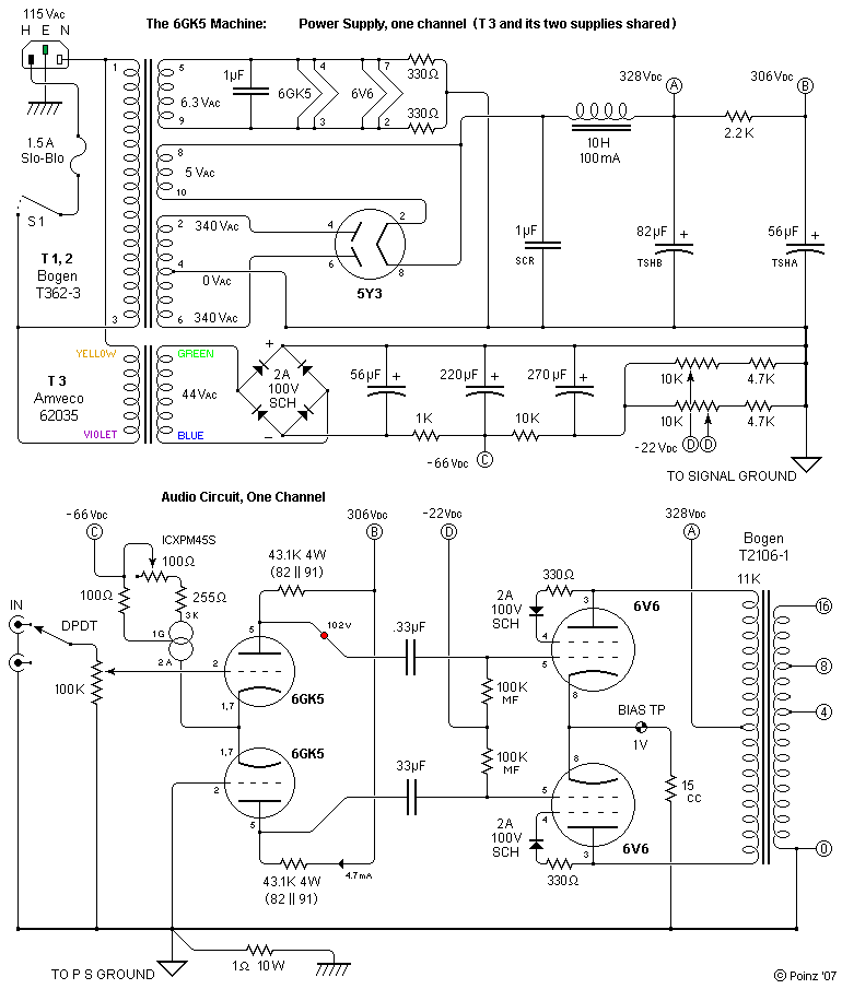

Is it the same concept discussed here? https://www.diyaudio.com/community/threads/vacuum-tube-power-amplifier-2-x-50-w.308590/
I was thinking the same, but why not build it "as is" and see how it sounds and measures? Then, you could go nuts with different configs.I assume using a 6FQ7 or 6CG7 in place of the 12AU7 would be an improvement and would not require much in the way of changes. Good idea?
jeff
@nerdorama - I think the two are exactly the same.
@zintolo - It's an earlier and simpler design than the 50-watt amp in that other thread. Someday I'd like to make that 50W design. Many here (like Wavebourn and SY) have said that is an excellent design. But that would be a major undertaking, and I'd have to redesign the first two stages to use something other than the unobtainium 7199. Maybe just use the 12AU7 circuitry from this RC10 and accept the lower sensitivity. The voltage amp-split load inverter stages are not inside any feedback loops, so that could actually work. [EDIT -- OOPS! Wrong. The global NFB goes to the 7199 input stage cathode, so it would need something with at least close to similar gain. Oh well.]
@nicoch58 - Poindexter's Musical Machine is a PP triode amp, so it will make less power. Probably only 4 watts. I'm hoping to get at least 10W per channel. Eli Duttman's El Cheapo is similar but uses a 12AT7 LTP instead of the Musical Machine's 6GK5 triodes.

I haven't used this type of local feedback in a PP amp, but I have two SE amps with plate to plate feedback. They sound great to me. As well, they are parallel feed. They have -3dB frequencies of at or below 20Hz and over 60kHz at 1 watt. The most recent is still at these point at 10W and nearly this bandwidth at 15W. I think this sort of feedback works very well. I would follow the RCA schematic. Should work great.
First of all, the primary inductance of the output transformer Does affect the phase and the amount of negative feedback at low frequencies.
It is a true low frequency pole.
Then there is the loudspeaker impedance versus frequency, as it reflects back to the output transformer primary.
But that is a completely different consideration, and is discussed in multiple Tubes/Valves threads.
I built both Schade negative feedback, and output tube plate to driver cathode negative feedback stages.
I prefer the output tube plate to driver tube cathode negative feedback.
Schade negative feedback greatly increases the load the 6AU6 drivers would see.
Similarly, plate of the 6V6 to the grid of the 6V6, greatly increases the load on the 6AU6 drivers.
I like plates to drive high impedances, or at least moderate impedances; I do not like plates to drive low impedances (just my preference).
There is a difference in the effect of a Pentode versus a Triode that drives a low impedance.
Check out some of Gary Pimm's amplifiers that used pentode drivers, and output plate to output grid, or output plate to driver plate forms of negative feedback.
The 100k plate to cathode resistors pump DC current into the self bias resistors (that affects the self bias voltage). The ratio of the 100k . . . to the 1.8k self bias resistor that is in parallel with the cathode impedance sets the amount of the negative feedback.
R9 with R8; and R10 with R7, are part of what causes the total amount of the self-bias voltage.

I suspect that they're part of a plan to bias the 6AU6's with larger than normal values for R12/R13, with the intention of keeping the values of R19/R18 up to a tolerable value. They would otherwise become a significant wasted load on the output valves. Because the feedback path is DC coupled (yeah! done correctly!) getting all these values to play nice together requires some tricks and treats. The inadverdant small pos. feedback is not intentional, just the fog of war.R9 and R10 (330k) are a mystery to me. Simulation shows they increase the NFB a little. But how? I guess they feed a little output signal from the cathodes to the grids of the 6AU6s. That would create a little positive feedback, no?

I really like the RCA SP-10 design too. The "local" N Fdbks back to the driver cathodes don't load down the driver input grids. So the front end can be played with for different designs readily. Driver plates don't get loaded down. DC coupling of the N FDBK is a plus. Single pole loading of the "local" N FDBK loop. This Amp does everything right. I would have thought R9 and R10 would be the usual bootstrapping of the 6AU6 grid resistors, don't know what is happening there. For the 9K OT availability issue, you might try the "bigger 6V6", the 6JC5 with an 8K or 6K load. Since a little more current will be needed to drive the lower Z OT then, a little boost in driver gain could help, or go to the higher gm version of the 6JC5, the 6JA5. (or just put some JJ KT77 tubes in there, this Amp could use a power upgrade! And some 6197 tubes in for the 6AU6s, 2X the gm, can call it the RCA SP-35 )

Question about the 6AU6 drivers. What's the idea with the 1M screen load resistor? That large a value brings the 6AU6 screen voltage down to about 65V, which puts the 6AU6 in a low gm area of operation. If higher gm is what is wanted here, why not readjust everything so that the driver pentodes are operating with a higher screen voltage and therefore higher gm?

Plate current through the 6AU6's is about half a milliAmp (call it 150VDC / 330K Ohm) so cathode voltage is 1K8 x 0.5mA = 0.9 VDC (maybe 1.0 VDC including G2 current). 3/4 of that DCV appears at the G1, so actual bias voltage is only about 0.25 VDC, kinda small. To take advantage of the bigger vertical pentodes might likely require quite a bit more current. This would be a generally good thing anyway, for driving the capacitances appearing at the output valves' G1 and allowing smaller output valve grid leak resistors for best valve lifetime.
If the R9/R10 solution is too sketchy for you (can't blame ya) a small positive DCV applied to the bottom of the drivers' grid leak resistors, a few volts, maybe even from a battery, would do the same job, and allow the same design freedom in choosing R12/R13 and R19/R18. Could even keep them the same values, seem well chosen. Use nice resistors for R19/R18, maybe several in series, and maybe wirewound or something else with plenty of dissipation (about a Watt of heat) and best voltage linearity (big signal voltages here).

If the 6AU6 is running at such low current, then just increasing current as you said. RCA'S later 50 Watt Amp has 120V on the 6CB6A screen grids.
I wonder if the SP-10 was using such low 6AU6 current to get some Harmonic Cancellation with the 6V6s.
