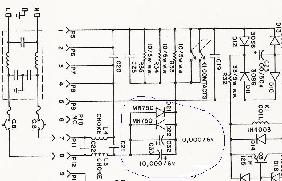

Hi AndrewT, Yes, mine doesn't quite work right. My apologies. Attached is the actual Levinson circuit. Looking at it, it looks like they are not worried about the cap being reverse biased by one diode drop. And you kids playing at home, this is seriously dangerous. Really think about the impact to the electrical grid if a bad idea or mistake happens. And think about the danger to yourself. Using a VariAC and an isolation transformer is highly recommended.
some manufacturers state their electros can stand upto 1.4V or so of reverse bias.
I have not seen whether this is time limited or a permanent limit.
Using one diode drop ensures that 1.4V is never exceeded provided the diode does not fail.
But most manufacturers use two diodes drops to allow smaller caps to be used.
The caps in your post add to 20mF. That pair supports a pretty big transformer working fairly hard, continuously.

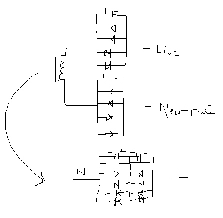

...and sorry to bother again, but if you took my above schematic but wired the two caps in parallel across the AC lines, what would that actually do? (sorry, but it's been bugging me what I can do with the 150uf/350v caps I have, and I'm also trying to get my head around the theory..)

Hi Bab,
you have not moved on.
Why persist with that badly designed circuit?
I can and do make mistakes. Where did my logic go wrong?
The diagrams you just posted are NOT equivalent
and you continue to follow the dubious practice of blocking both the live and neutral lines.
Did you go back and search the recent threads on DC blocking and follow the safety arguments put by both sides for the disadvantages for blocking either the live line or the neutral line?
When you read those arguments did you realise that blocking both lines incorporates the disadvantages of both schemes?
Do you want help here? Or are you trying to wind me up?
I suspect you have done little homework since you first got my attention, keep going the way you have and you will lose it.

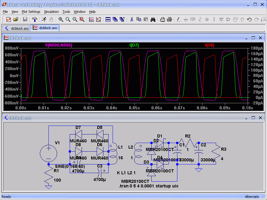

Also, I've been doing some simulation of DC blockers in a transformer feeding a rectifier-capacitor supply, and the capacitors I see in most schematics are far too small. For example, what is the current draw of that Levinson?

AndrewT said:
the DC blockers are usually polar electrolytics.
This necessitates back to back, series connection of a pair.
That is simply wrong, as neither the Mark Levinson nor the Bryston circuits posted in threads here have them in series. They both assume the limited by diodes reverse voltage is insufficient to cause a problem:
Levinson blocker Bryston blocker
I do find the anti-parallel connection interesting; is the electrolytic's ESR identical in both polarizations for these low voltages? If not, why not just align the capacitors in the same direction? Seems more than a coincidence that both circuits would be this way.

I am aware of the literature published by a very few manufacturers regarding small reverse voltage tolerance.
The fact that these two manufacturers (and maybe some others) choose to apply a reverse voltage to polarised electrolytics does not make it right. That they may "get away with it" does not make my statement

classd4sure said:
C'mon this is old stuff. The caps only conduct while AC is crossing zero, after which the diodes take over. :rolleyes:
That's not at all what's under discussion you tool. Not to mention that it's not just when the AC is crossing zero, but when it's within the diode chain voltage drop around zero. But of course, we're talking about the AC across the blocker, not from live to neutral. The following simulation shows that (in this case no DC offset) the diodes only have microamp leakage current through them; the supply is drawing about 170 W; voltage waveform shown is across the blocker:

AndrewT said:
Hi, I don't think so.
Show me why it should be so.
I showed just the opposite in the simulation I posted. They only conduct if a large enough voltage develops across the blocker -- either capacitors too small, or there is significant DC offset. Drawing spikes (because of the rectifier and C-input filter) of several of amps from a 120 V mains, the 2x4700 uF I simulated appears more than adequate.
