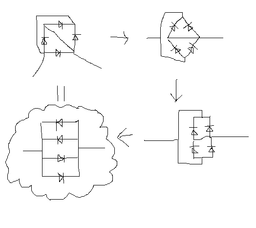

AndrewT said:
Hi, lack of knowledge, working when fatigued, but maybe that was not the question.
Believe me, do not copy post1! Yes, go and look and learn. Try comparing it to a correct wiring diagram. see post12.
Sure, I believe you.
But, I do not hear from you about what is incorrect in wiring.
Could you give me a brief explanation?

the layout is inherently dangerous. those single core, single insulated mains cables strung out across and along various routes is beyond bad practice.
The bridge is incorrectly connected.
The blocker is connected to both live and neutral.
No fuse.
No reference to safety earthing.
No warnings about mains working.
No instruction to the maintenance technician.

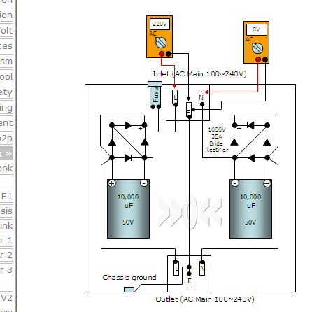

the circuit in post3 has been discussed at length.
I think most who took part in the discussion agreed that it kept the less safe practices of both camps without any of the benefits.
It seemed at the time that most were favouring keeping the DC block in the live line. A few, myself included, prefer to see the DC block in the neutral line.
The argument from both sides was that the risk of injury was increased by using the other variation.
Using the split two pole version (post3) as a balanced input held few if any additional benefits but kept the doubled risk of injury from having both lines DC blocked.
I think we were all agreed that post3 was the least safe, certainly I cannot recall anyone on the forum championing that layout.
A second problem your layout adopts is single diode voltage bypass.
The diodes may overheat in this situation. The diodes should only rarely be required to conduct, i.e. during start up or fault condition until protection triggers.
Running the diodes with repeated pulses was never intended, unless you are sure it will not cause an increased risk of failure.
How will you decide if there is increased risk of failure?
How will you test the long term reliability/safety of a prototype circuit?
Will the circuit achieve it's intended purpose, DC blocking, if the diodes repeatedly conduct?
Keeping in mind you/we are working with mains voltage, I recommend you scrap your layout and adopt a safer one.

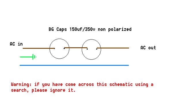

Going back to the Nelson Pass solution that I referenced to earlier, is that something like the schematic below? I happened to get some very cheap Black Gate NH 150uf/350v non-polarised caps, which are apparently useful for "pre-rectification filtering of AC". Would be nice if I could use them for something like this.....
( :att'n: AndrewT, I appreciate your effort to give safety warnings and I have also read the moderator thread regarding dangerous schematics. With that in mind, I put a warning on the attachment in case any poor fool stumbles on it during a search. I must also repeat here that my electronics knowledge is still at the bottom of a very steep learning curve ).

Hi Ssmith,
your circuit has used poorly selected values.
A DC blocker neeeds to have a very low impedance to the normal AC current that passes to the toroid transformer.
Use the formula Impedance (Z)~= 1 / [2 Pi F C]
Your 150uF+150uF in series has an effectice capacitance of 75uF.
Assuming you have 50Hz mains supply then Z=42ohms.
If the limiting voltage drop across the DC blocker is 1Vrms (about 1.4Vpk) then the maximum operational current your 150uF can pass is 23mA (33mApk). If you have 220V mains supply then the maximum load is about 5watts.
Do your own numbers and you will find that 4700uF (4m7F) is about the minimum you can get away with. BUT you must ensure that the "ripple" rating of the cap exceeds the operational current.
How do you define operational current?
What are you planning for high current bypass?
What voltage caps do you need to specify?
What reverse voltage can be applied to a polarised electrolytic?
Why choose 1V as a limiting voltage?
What happens to your circuit if the amp develops an overcurrent fault?
This discussion could go on for ever. I'll stop and let you think about those decisions.
If you are not absolutely sure you can design this mains system then copy a known good design or buy one from Peranders.
Non polarised means you can pass AC through them without the need for back to back.
If you were to parallel the caps instead of series you can increase your maximum load to 20W.

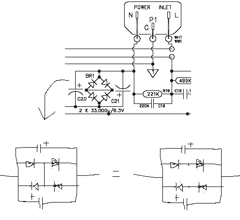

....here's something that Levinson used to do on the ML-9 (torroid), before they were absorbed by Harman. They called it "anti-rattle". As far as I know, it worked. I have no recollection of those mechanically humming/clacking. Maybe I just got lucky with cleaner power. It looks a bit like Babowana's, but it looks like his still has a danger of the caps getting reverse polarized. I've also heard of these referred to as a "coring" circuit. If anybody has any knowledge of that phrase, I would love to know more. Thanks

Hi, Mrshow,
that circuit seems different again.
For current flow in each direction there is only one route from live to neutral through the cap.
That one route ensures the polarised cap never sees a reverse voltage.
The cap is in series with two forward biased diodes.
It forms an effective DC blocker.
BUT it has no bypass for high current!!! either start-up or fault.
If you were to design it for start-up current, I wonder just how much capacitance would be needed?
What would happen to it just before a fuse blew during an overcurrent fault?
