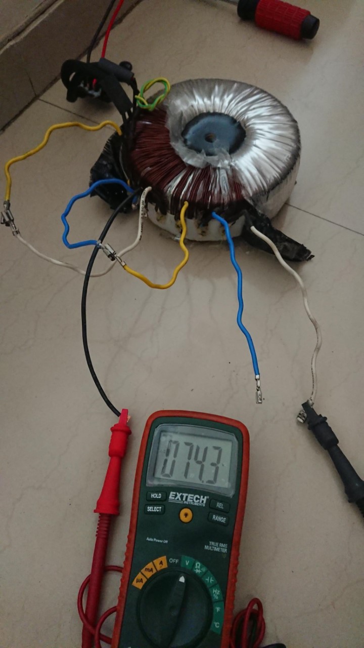

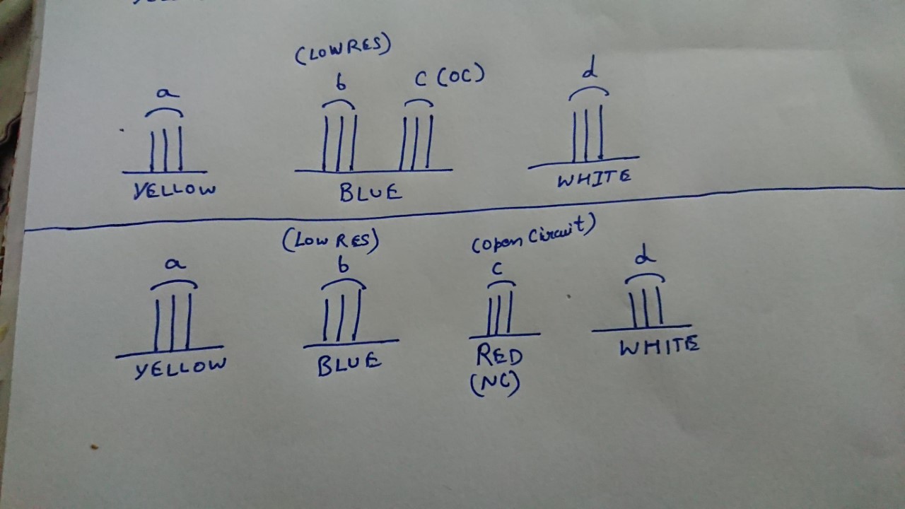

You should have a low resistance from Yellow to Blue.
Low resistance from Red to White.
Open circuit from Blue to Red.

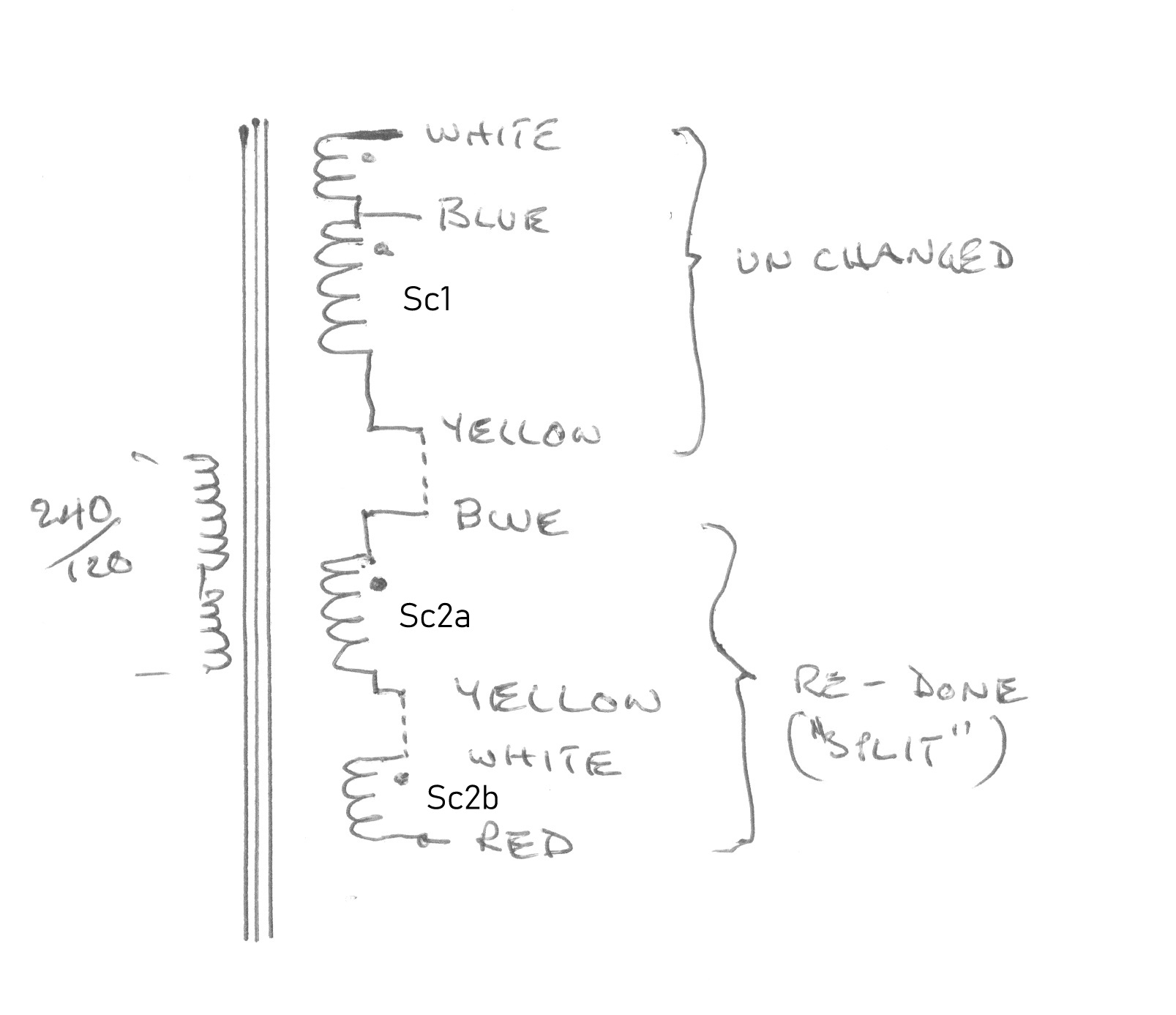

I've added the phase dots to help.
Leave secondary one (Sc1) as is.
Join the altered secondaries (Sc2a and Sc2b) Yellow to White.
Join the original Sc1 Yellow to Sc2a Blue.
Now Sc2b Red is the 36 volt AC out, Sc2a/b Yellow / White is the 28 volt AC tap and Sc2a Blue is the 0 volt connection.
Test by measuring the AC volts from Sc1 White to Sc2b Red, it should be 72 volts. And from Sc1 Blue to Sc2b White should be 56 volts AC.

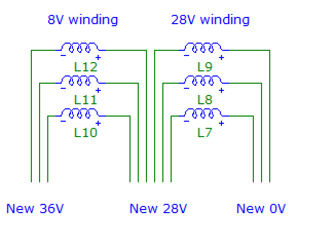

> Can you please tell me how to move the 8V winding to left.
It's just a graphical representation on the drawing.
Basically you have one 28V and one 8V winding in series. They are connected like this (top):
So if you decide "0V" is on the left you get 28V and 36V but with the wrong polarity relative to the other winding in the transformer, which is your problem.
If you decide "0V" is on the right you get the correct polarity but you get 8V and 36V, so the 28V is missing.
So the 8V and 28V windings can be in series, but you simply have to swap them, like in the drawing Alan just posted.
Then you can rewire them in series, so the transformer will have 3 wires for these 2 windings, or you can keep 4 wires, as you wish.

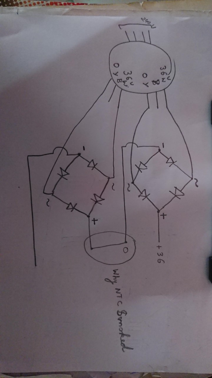

I have a question, before transformer modification I was doing some test. When you connect +ve of one rectifier with -ve of another as in diagram, why did NCT started glowing. The circuit on secondary is still open soo how can large current be drawn? Am I misinterpreting anything?
The only high current paths in that 2nd diagram are the windings and rectifiers.
Make sure the rectifiers are not shorted.
Make sure you have not accidentally connected AC to the +ve and -ve terminals?

Earlier they were not, but after connecting they were 😀The only high current paths in that 2nd diagram are the windings and rectifiers.
When I connected +of one to -ve of another there was a spark sound and some silver stuff came out of rectifier and thermistor started glowing.
No, AC to AC terminals. Only connected one positive into negative of the other. This happened before changes, so not doing it again until I have couple more rectifiers and NTC.Make sure you have not accidentally connected AC to the +ve and -ve terminals?
