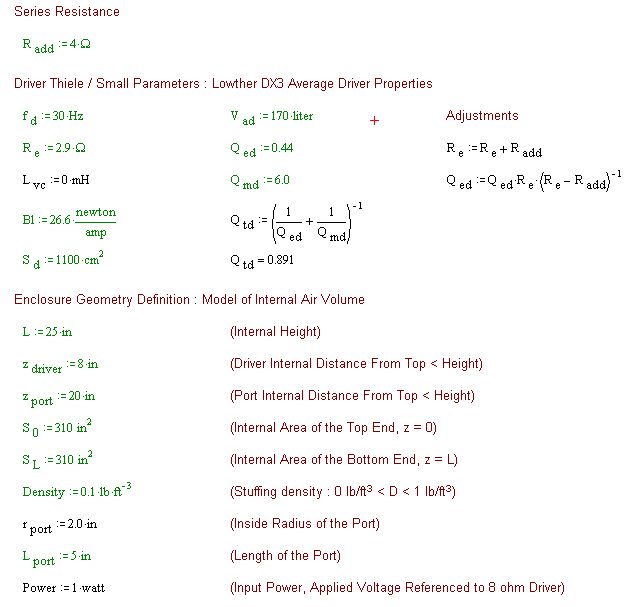

So I left the 4 ohm speaker in place but changed some things to compensate for what the second speaker would bring if it were hooked up. Here are the parameters for that same speaker with the 4 ohm resistor added, only with the Bl doubled, the Sd doubled, the Vas, (Vad) doubled and box volume doubled as well.

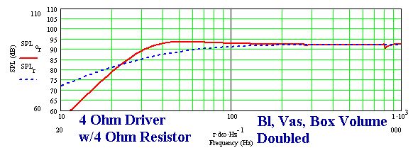

And here is the frequency response after those changes. The curve seems to be returned to it's original shape before the 4 ohm resistor was added. However the SPL output at 2.8 Volts is a little lower. I would guess that is because this is now an 8 ohm speaker, and is drawing one watt instead of two at 2.8 Volts than it did when it was a 4 ohm speaker.

Qes depends on Re. When you add a 4R resistor Re goes up.
Two drivers with two magnetic circuits the seperate Re's remain
the same effectively, it is not the same as the resistive case.

Another way of looking at Qes is the amount of current allowed
to flow in in the cirtcuit when the cone moves. Obviously open
circuit there is no Qes. Short circuit is the usual case, that is :
being driven by a voltage amplifier with near zero impedance.
Adding any resistance lowers Qes by impeding current.
If you consider the series / parallel cases and the current induced
in each coil you should be able to see that nothing changes from
the single driver case except the power per driver.
Parrallel I think it should be obvious its the same, as is the power.
Series you do have double the Re but also two motors which will
produce twice the back emf balancing the increase in loop R.
FWIW Re and external R are not theoretically different.
Say a VC coil has Re = 4 ohms. If you made it exactly the same but
with "super" wire such that Re = 1 ohm Qes will change. Only with
an external 3R resistor would the Qes be the same.
