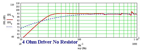

Thank you for the correction-the speaker itself doesn't even get a full watt when you add the 4 ohm resistor-it goes down 0.5 watt.
Just to review:
A 2.8 Volt signal is used to test sensitivity of speakers these days. That is because at 2.8 Volts, an 8 ohm speaker will draw one watt of power, so it is the equivalent of testing at one watt-if you use an 8 ohm speaker.
However, many speakers these days are 4 ohms. At 2.8 Volts, a 4 ohm speaker draws 2 watts, so it's sensitivity rating is higher.

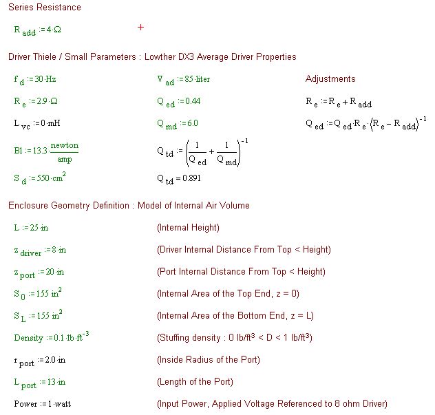

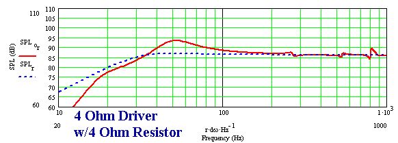

When we add the 4 ohm resistor to the 4 ohm speaker, we do two things:
A) We increase the ohmage of the load the amp is driving, so only one watt total is dropped across the 4 ohm speaker plus 4 ohm resistor load together.
B) The 4 ohm reistor is going to use up half that watt, so the speaker only gets the remaining half.
So when the 4 ohm resistor is added, the speaker goes from getting 2 watts before the resistor is added to getting one half watt after it is added.
Again-thanks for the correction.

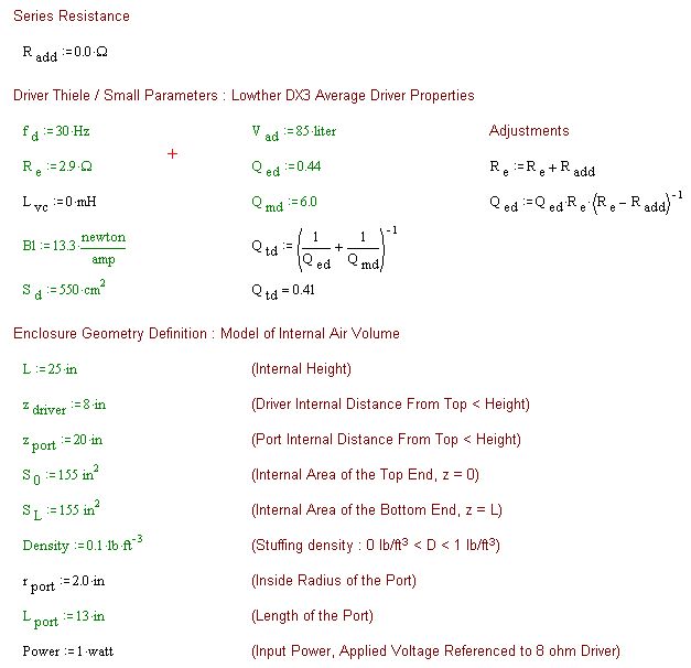

So I left the 4 ohm speaker in place but changed some things to compensate for what the second speaker would bring if it were hooked up. Here are the parameters for that same speaker with the 4 ohm resistor added, only with the Bl doubled, the Sd doubled, the Vas, (Vad) doubled and box volume doubled as well.
And here is the frequency response after those changes. The curve seems to be returned to it's original shape before the 4 ohm resistor was added. However the SPL output at 2.8 Volts is a little lower. I would guess that is because this is now an 8 ohm speaker, and is drawing one watt instead of two at 2.8 Volts than it did when it was a 4 ohm speaker.
