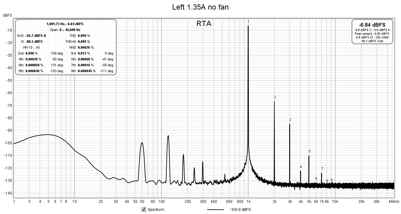

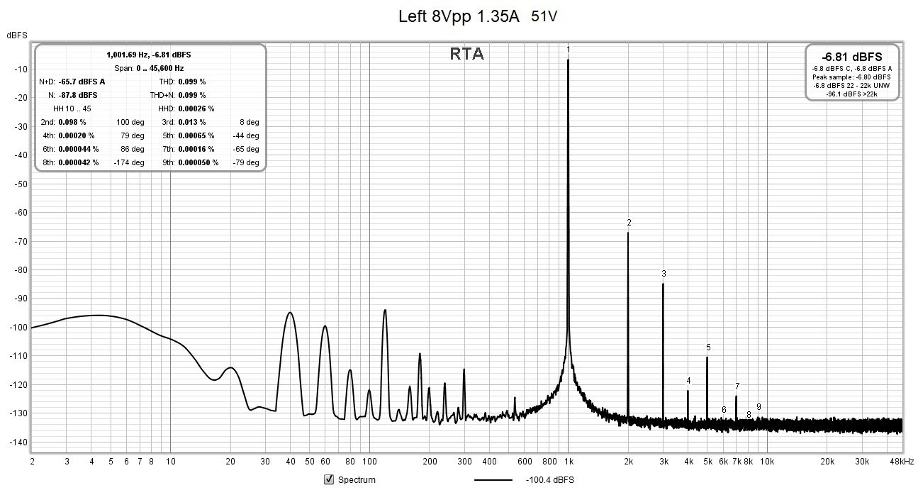

I have not tapped off the amp power supply for a microprocessor, but I have powered a low voltage cooling fan. I was not able to get rid of all the added noise, which showed up as 40 Hz and its harmonics.
In the end, I just lived with it. I didn't really notice it, and I didn't want to add a separate power supply.
