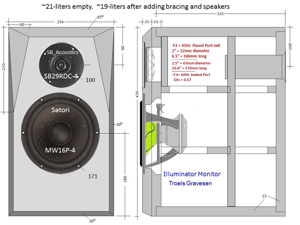

Troels Gravensen's website includes an Illuminitor Monitor cabinet which uses a truncated pyramid shape to reduce edge distortion. Simple bevel cuts. This cabinet will work with the high value 6.5" Satori MW16P-4 midbass and 1.1" SB_Acoustics SB29RDC-4 tweeter. Purchase a DSP engine which can include tweeter time delay, in addition with either 2nd or 3rd order crossover filters at 1,800Hz.
