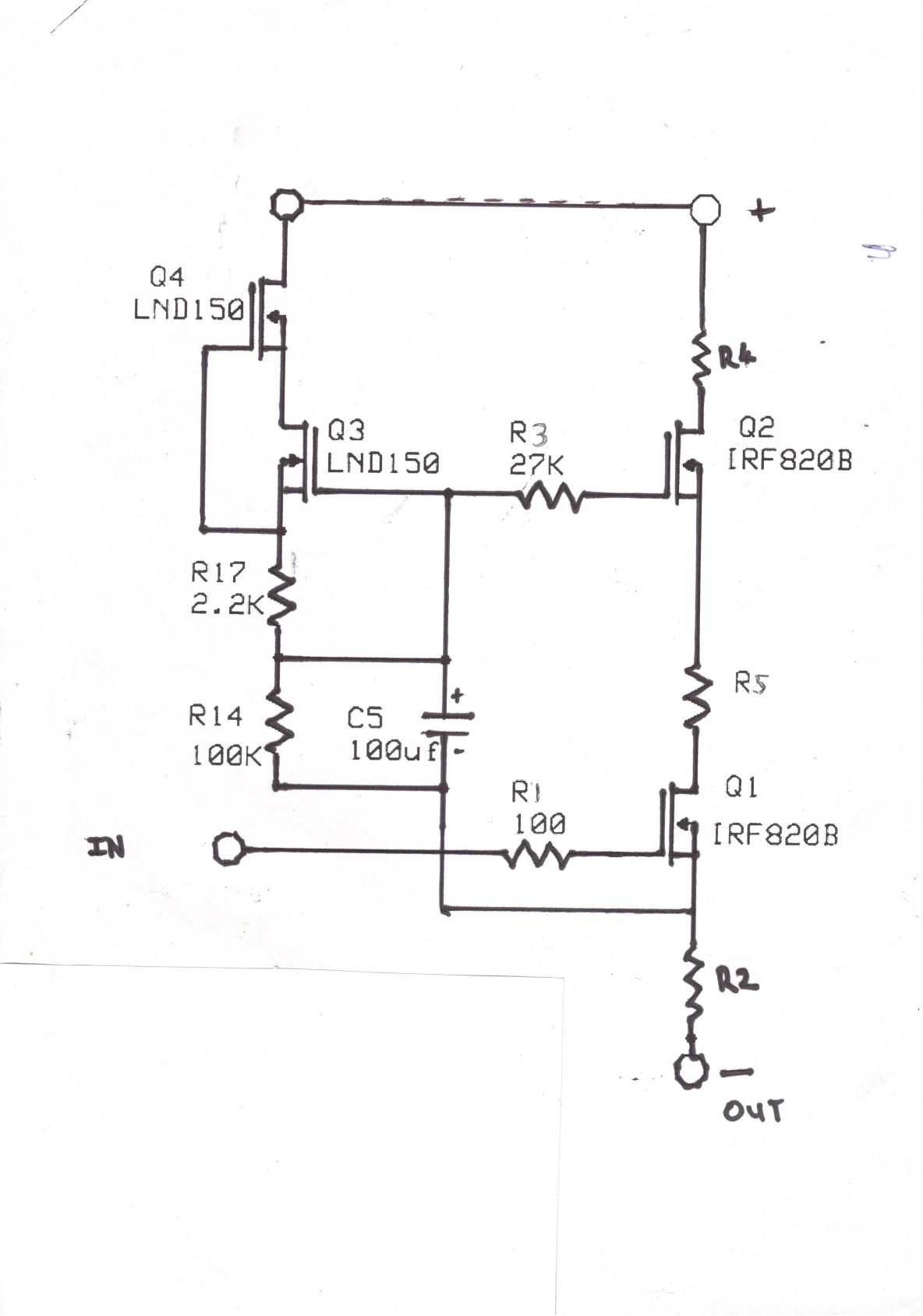

To get low FET follower capacitance I have adapted Gary Pimms cascode CCS to a cascode FET follower (see attached).
The bottom FET (I used IRF820) is working a near constant voltage.
Seemed to work ok.
Seemed to work ok.
