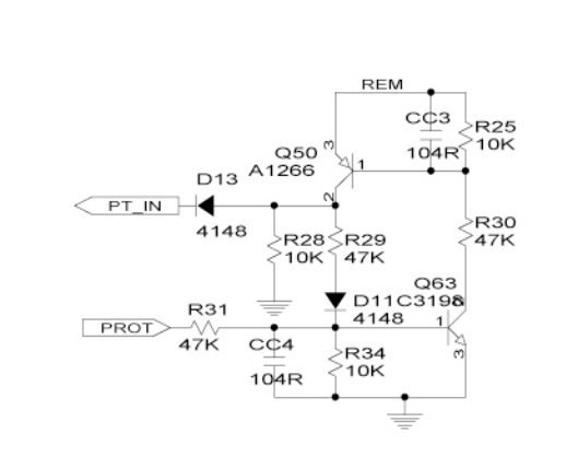

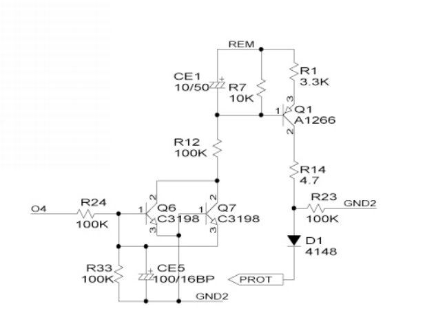

None of the schematic diagrams that I have that use similar circuits show anything other than the 293 (via 2 diodes) and a 4.7k ohm resistor connected to pin 1. Is the 4.7k resistor in the circuit and within tolerance?
I found another diagram with a DC offset protection circuit. Does the amp possibly have DC offset (on the output filter inductors before the relays)?
If not, can you find the following circuits in your amp?

The 4.7 k Resistors is within tolerance ..
The output filter inductors have 2.12 volts on them im assuming this is whats making it protect..
I will check the diagrams..
Any ideas on what i should check to see if thats the cause of the 2.12 volts on the inductors?
The First diagram is the same as the one in this amp
