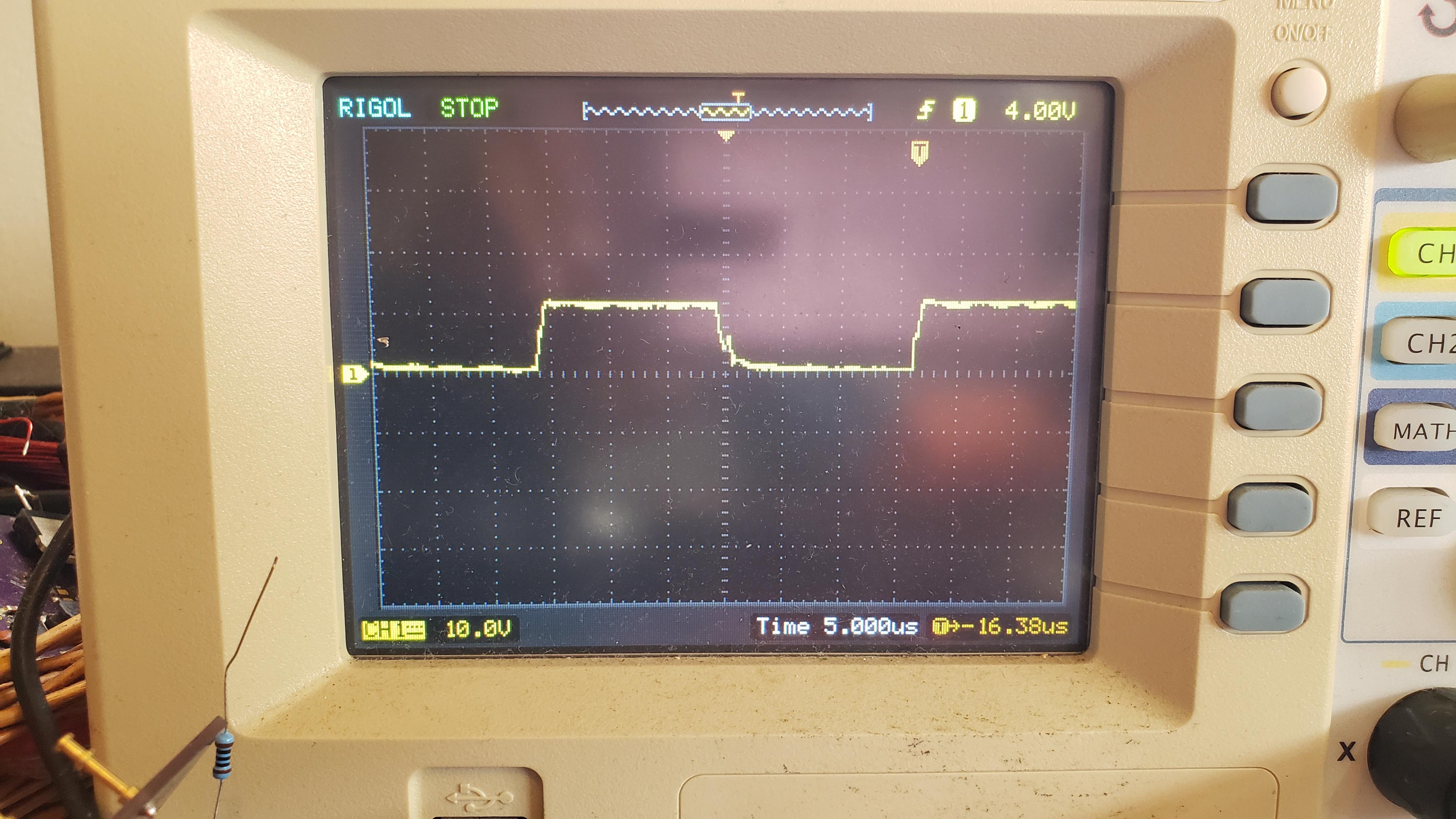

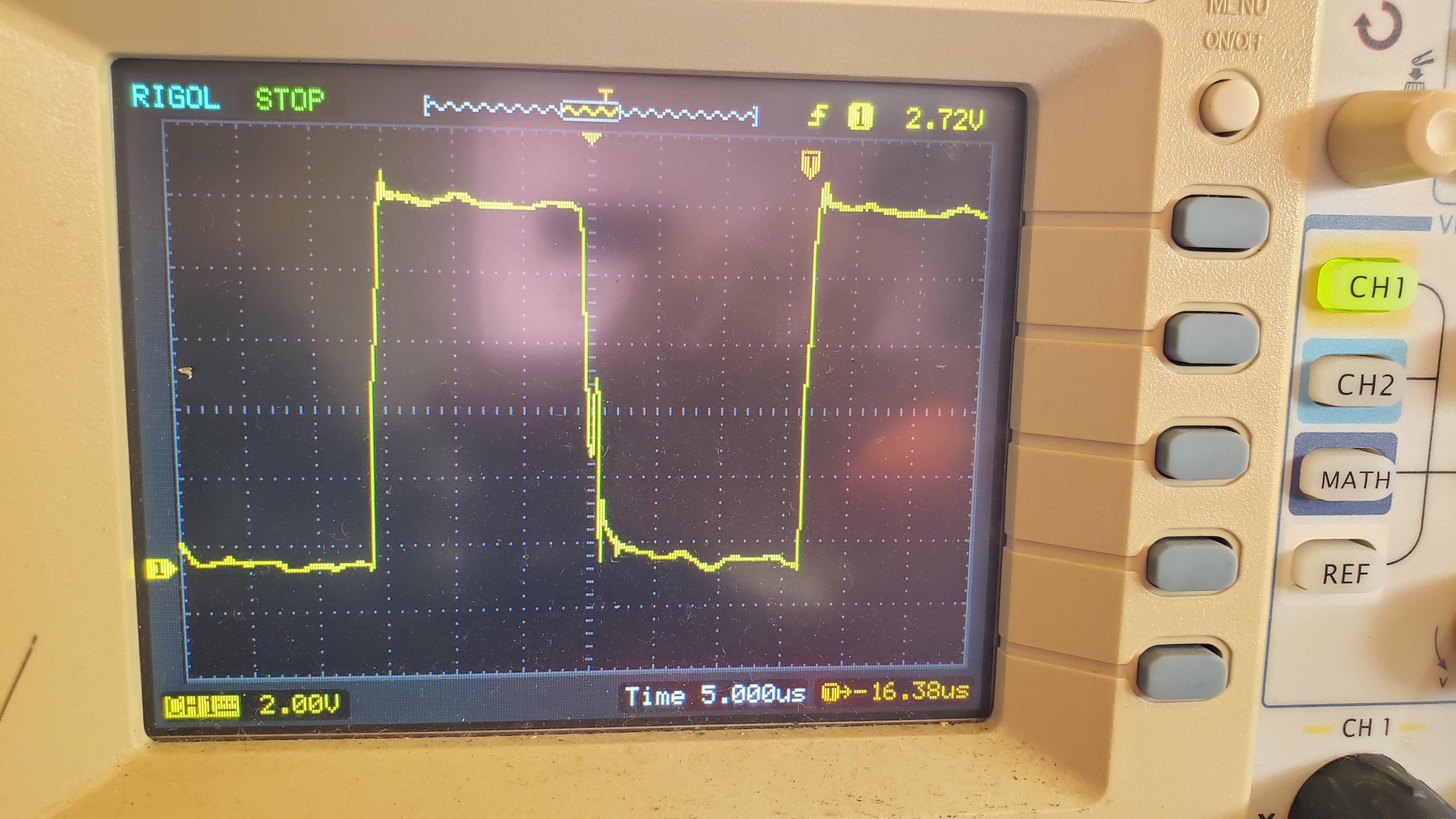

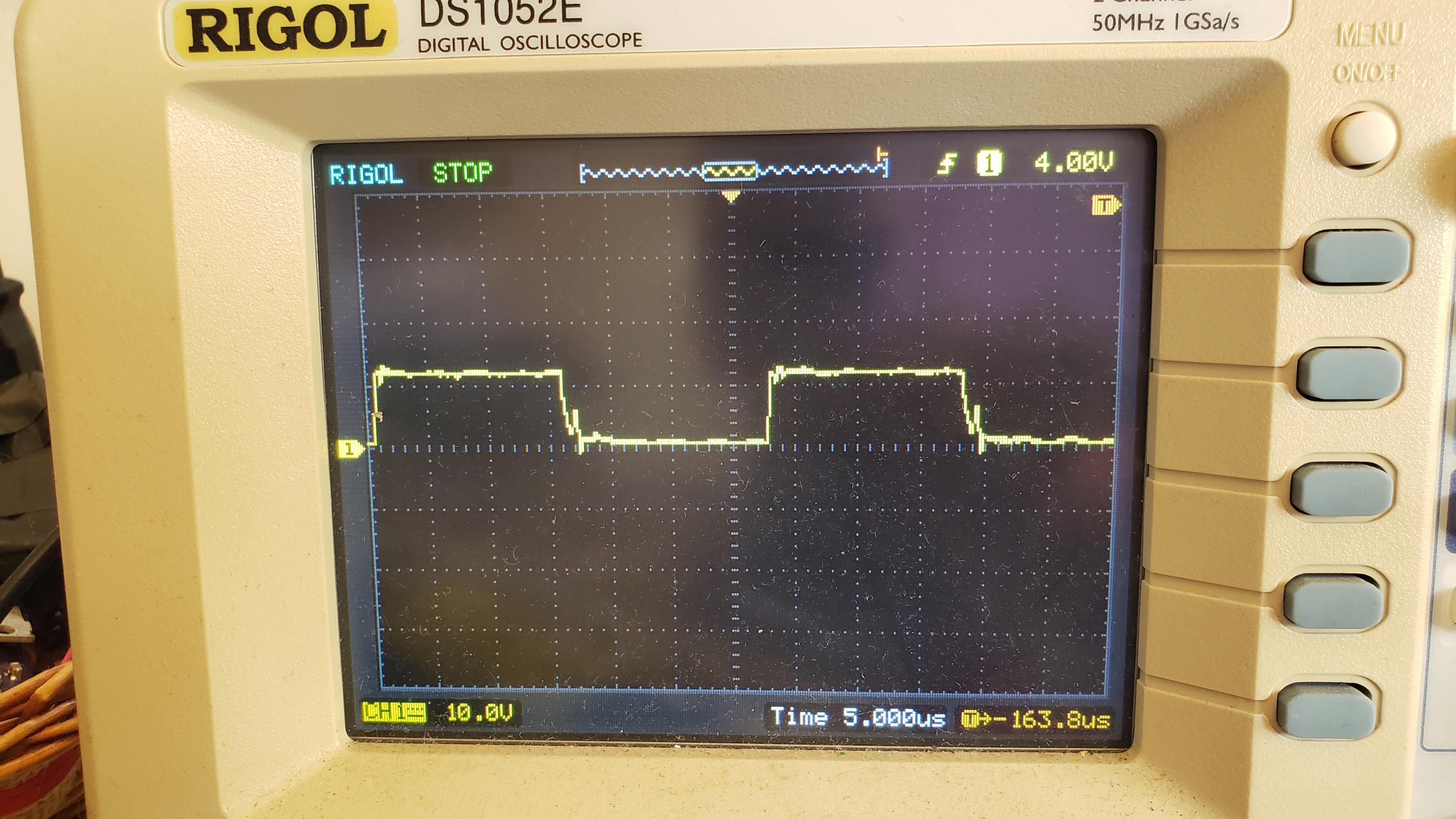

What does the waveform look like?
Waveform attached.
Did you install all of the FETs?
Are all in that bank heating up?
When posting an image of a waveform, use the lowest vertical amp setting that will allow the waveform to fit, vertically. When compressed, it's much harder to see what's actually there.
