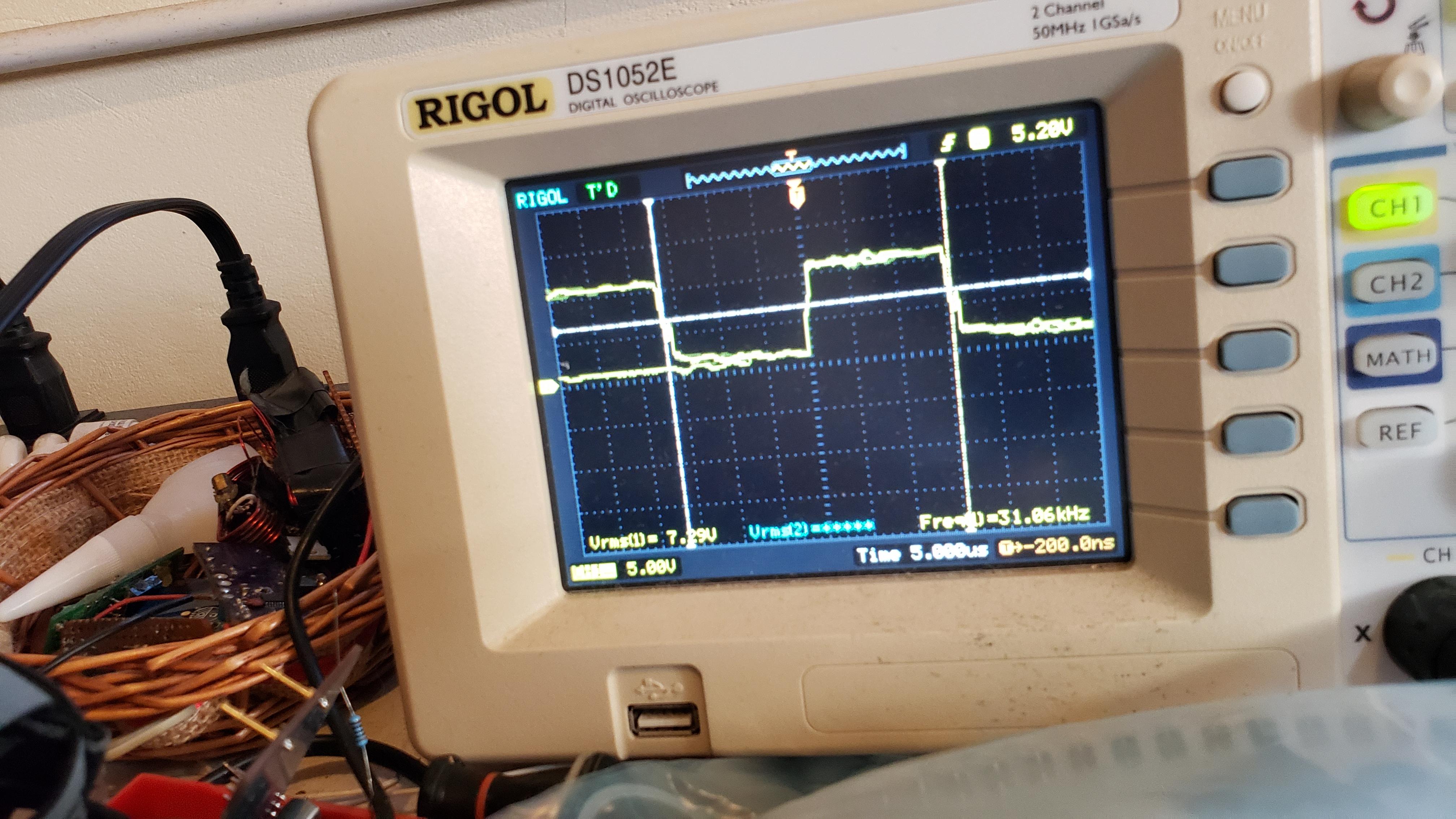

Replaced all fets. Attaching the gate waveform of One fet that getting hot.That doesn't really indicate that there is a problem.

Between the quality of the image (focus is on the wicker basket, not the scope) and the extra lines on the scope, I can't tell much. It looks like the signal is not falling quick enough. This is typically due to a bad PNP driver or pulldown resistor.

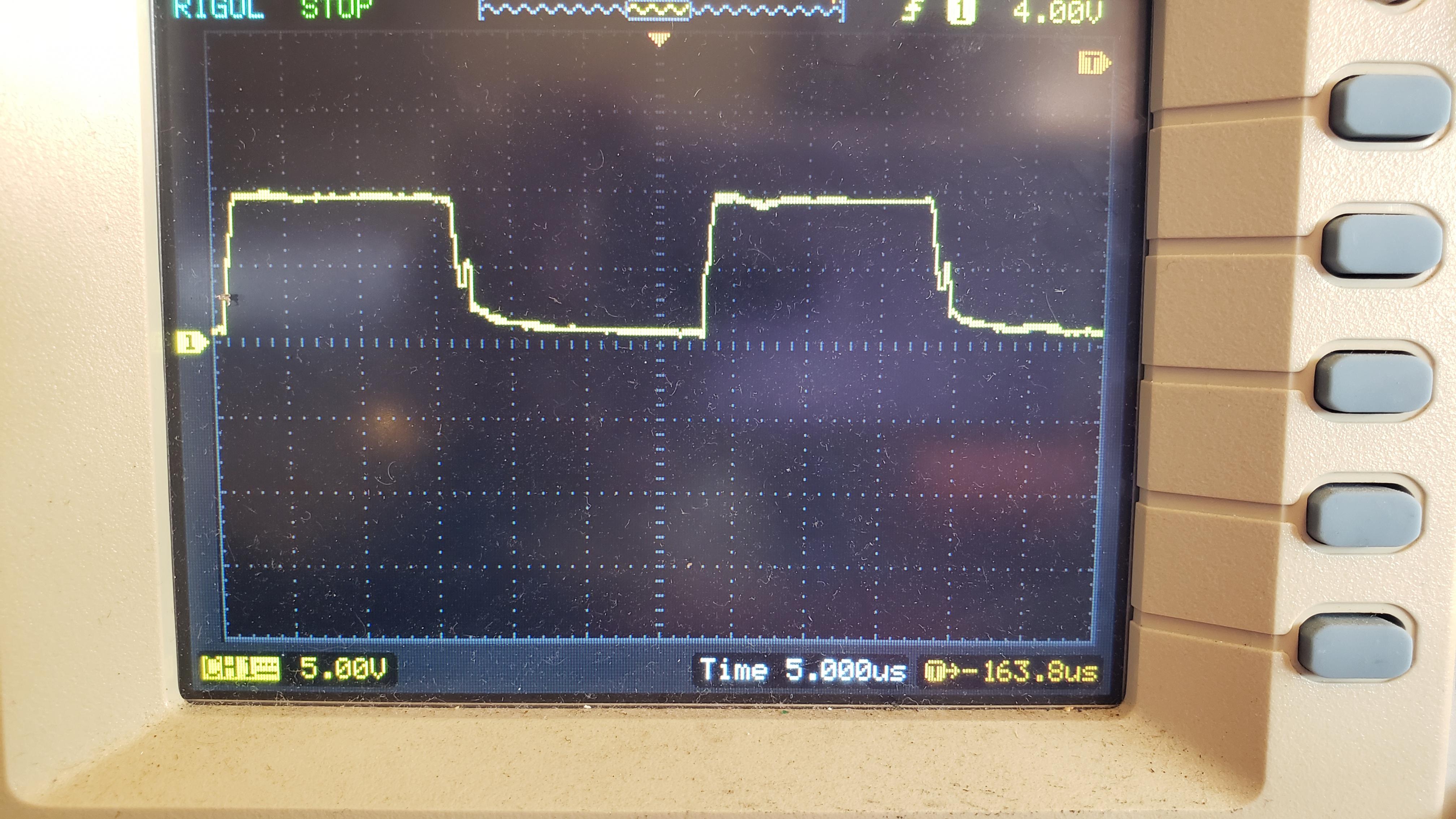

I will change the pnp transistors and also will attach good picture. It has A1023 transistor, may I know any good alternative that I can use?
The possibilities are virtually endless. Do you have the BD140 on hand?
Attaching new picture of gate waveform. Yes I have BD140.
