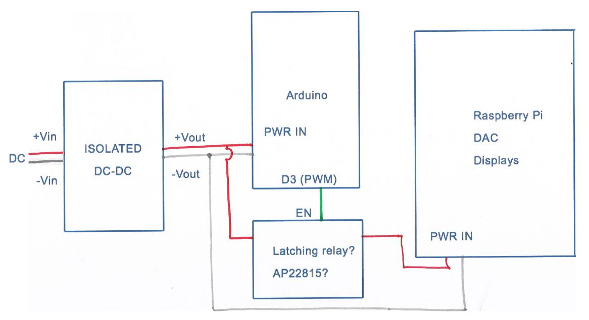

No audio switching here, audio selector will be another board, not this one. No PE either: I'll be using DC in, to avoid mains handling at all costs. Isolated DC-DC modules to get 5V and ±12V after the DC in. These switches are meant for unused power rails after the isolation DC-DC. Thus, Ground in these switches refer to the ground coming out of the DC-DC conversions. Unless I'm missing something.

If you switch DC sources that are symmetrical you should not switch GND as things can go wrong when one of both voltages may be up earlier than the other one (or the GND misfiring). This may lead to unwanted effects and/or large DC offsets/pops further in the chain.
Secondly you should switch the + and - only with semiconductor switches. Real switches or relay contacts will burn in fast when switching DC. This is normal, one of the reasons to switch AC instead of DC. Nowadays chinese engineers seem to forget this as I often see DC switching with mechanical switches. The switches will fail sooner than one thinks.
But I may misunderstand you, that is why schematics are invented. A drawing says way more than words. Anyway there are several reasons to switch mains voltages so AC switching is preferred. You will have the benefit of being sure things are truly powered off when you leave your home. Any detrimental power up/down phenomena when switching mains voltages can be solved with anti-parallel diodes, muting relays and such.
If you persist in switching DC then semiconductor switches or logic level MOSFETs are almost mandatory.

Very good point. I was already convinced to leave grounds alone anyway, so only aim for switching DC rails.If you switch DC sources that are symmetrical you should not switch GND as things can go wrong when one of both voltages may be up earlier than the other one (or the GND misfiring). This may lead to unwanted effects and/or large DC offsets/pops further in the chain.
Fair enough. I will try to do a basic scheme later tonight.But I may misunderstand you, that is why schematics are invented. A drawing says way more than words.
Again, no mains here, this is all DC from a laptop charger.You will have the benefit of being sure things are truly powered off when you leave your home. Any detrimental power up/down phenomena when switching mains voltages can be solved with anti-parallel diodes, muting relays and such.

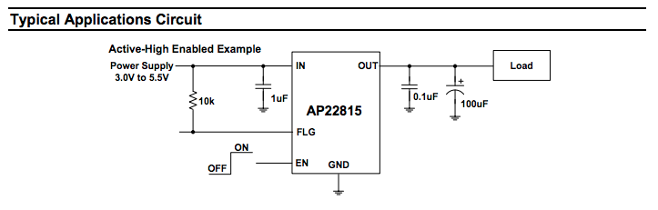

I would like to come back to the finding in post 20 of AP22815BWT-7 power switch as a candidate replacement of a relay:
Thank you so muchI might've found a way to avoid relays, using a power switch per each optional rail, at least for the 5V@3A. For instance, AP22815BWT-7. If I'm not mistaken this chip accepts a Input Voltage Range of 3.0V ~ 5.5V, and has an Enable input that acts as the switcher. It even has Overcurrent, Short-Circuit and Thermal Protection, Output Reverse-Voltage/Current Protection, Undervoltage Lockout etc. The EN feature is described as:
ON/OFF Input Operator
The EN input allows the output current to be switched on and off using a GPIO compatible input. The high signal (switch on) must be at least 1.2V and the low signal (switch off) no higher than 0.4V. This pin should not be left floating. It is advisable to hold the EN signal low when applying or removing power
Would anyone here please confirm this is a valid approach or I'm completely nuts? If this is valid, I'd need to find a similar product for +12V and for -12V rails.

Here's the drawing. I don't think we need a super details proper schematics at this points.
Please see my previous message with a possible alternative to latching relays, using the AP22815BWT-7 power switch.

Main "Isolated DC-DC" power unit will be on all time? So I dont see reason to use relay, but you can use just mosfet (for example - P-mosfet). May be there is some low-level (logic-level), I don't know exact popular part number right now. AO3401?

Hi, yes, isolated DC-DC will be ON all the time. I will investigate on using mosfets, thank you. Any circuit you know I can look at?
I haven't exact circuit. When I needed recently something like that I googled "p-mosfet switch".

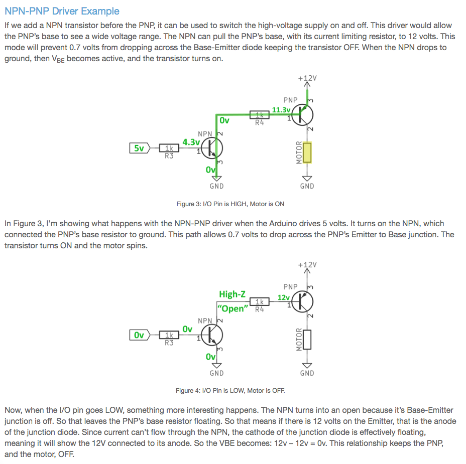

Hi again,
I'm just reading about using transistors. Apparently, the proper way to triggering a power circuit on/off through an Arduino signal is by using a P-Channel MOSFET as the switching transistor with a NPN transistor driver for that P-Channel. See NPN-PNP Driver Example section, from the baldengineer site, where I got the attachment capture from.
Also learnt from baldengineer that in theory there are off-the-shelf components called power switch or load switch, which basically would be ICs with the P-Channel MOSFET and a built-in NPN driver. Haven't found any in mouser though (or if I did, when reading the datasheet, I cannot find the explicit reference to the driver).
Also was having a look at this video Using PNP Bipolar Transistors with Arduino, from min 8:15 you'll see 3 circuits for the same purpose (one as the attachment, 2 a bit more complex, using Darlingtons).
