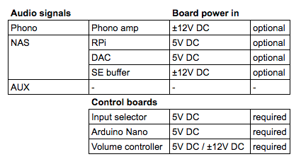

I'm designing an arduino controlled preamp. Power will be provided by an isolated DC-DC conversion board (taking power from a 12-24V) to LDO regulated 5V DC and ±12V DC. Besides de audio input selector (will be using maxw's board) I want to also be able to power unused circuits off. For instance, if I select audio coming from the NAS, I want to cut the ±12V DC power going to the phono amp off, and if I select the phono audio, I want to cut the 5V DC going to the RPi/DAC and the ±12V DC power going to the SE buffer after the DAC.

Savings around full watts, yes. Phono amp can probably consume 0,25W per channel, but the RPi will consume 10W (5V@2A) if using display, etc.Have you calculated the savings? Does it amount to whole milliwatts or just fractions?

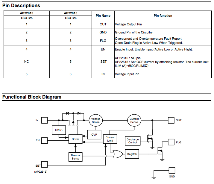

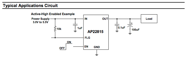

I might've found a way to avoid relays, using a power switch per each optional rail, at least for the 5V@3A. For instance, AP22815BWT-7. If I'm not mistaken this chip accepts a Input Voltage Range of 3.0V ~ 5.5V, and has an Enable input that acts as the switcher. It even has Overcurrent, Short-Circuit and Thermal Protection, Output Reverse-Voltage/Current Protection, Undervoltage Lockout etc. The EN feature is described as:
Would anyone here please confirm this is a valid approach or I'm completely nuts? If this is valid, I'd need to find a similar product for +12V and for -12V rails.
Thank you so much
ON/OFF Input Operator
The EN input allows the output current to be switched on and off using a GPIO compatible input. The high signal (switch on) must be at least 1.2V and the low signal (switch off) no higher than 0.4V. This pin should not be left floating. It is advisable to hold the EN signal low when applying or removing power
