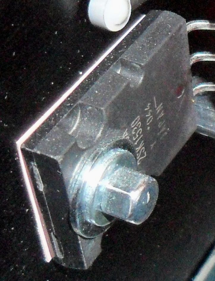

I used sil-pads for my class A amplifier and no heat transfer problem.
