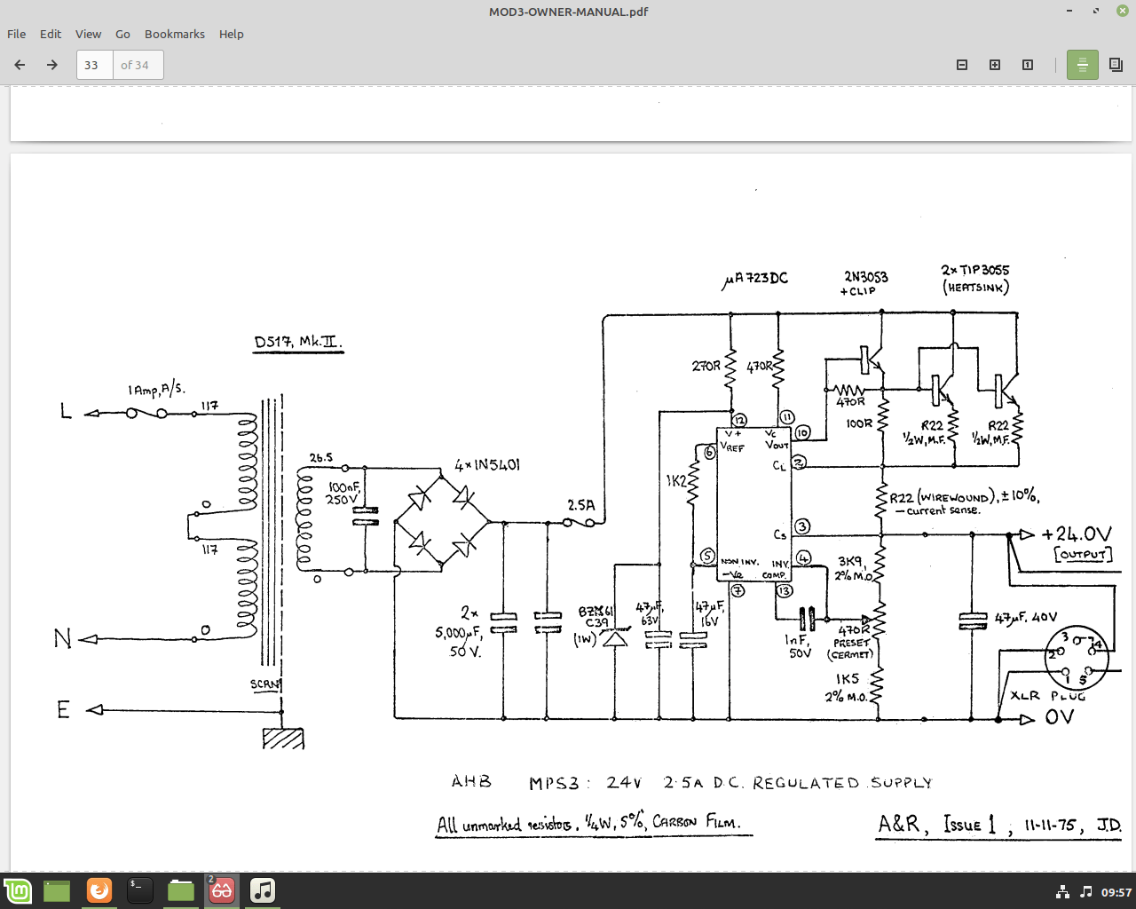

so any chance that you've located what's pulling the extra current??
I found that 2 of the (4) power transistors had shorts but the other two checked out ok on the multimeter. I was under the impression that if one of them failed, it is likely they all have failed but now I'm not 100% since 2 are showing to be ok when testing with the multimeter. Is there a chance that 2 of them did not fail? Sorry I should probably know this, thank you very much for your help. Much appreciated
entirely possible, but due to the fact that these are the pass transistors for the power supply regulators i would replace them all.

I'm not even sure that there is one, this was a custom built power supply (tmk the original ones were somewhat insufficient).
Linear regulated power supply's are pretty simple and likely to be either built around something like a uA723 IC, see attached, in which case a look at the IC's datasheet and application note should give you a good idea of what's going on, or there'll be an opamp and a few transistors. This is broadly speaking.
Things to look out for check as well as the obvious series pass tranny's is the opamp or reg IC, I'll pull em out and fit a DIP socket to allow easy checking etc. Also check zeners, diodes and any voltage reference. Other than that is to power the supply up on a current limited supply with only one series pass device fitted. Get that running without smoke and your laughing.

well yes identifying what's used as an error amp in the supply is going to tell us if the supply is original or a subsequent replacement/ upgrade the originals where zener based and went south fast when outboard gear of dubious manufacture ( and grounding ) where interfaced with the console.
it may not seem worth it but the schematic will go a long way in helping you flesh this out....is 50 bucks for the Pdf not worth it?
otherwise it's a lot of reverse engineering to come up with a total current draw to create a supply regulator that going to handle what this thing is going to need.
You/we NEED the schematic to begin with; an experienced Tech may do without, but then his minimum bench fee will be higher than U$50, so ...
But search around, specially Trident fan Forums, somebody will probably chime in, upload it, whatever.
