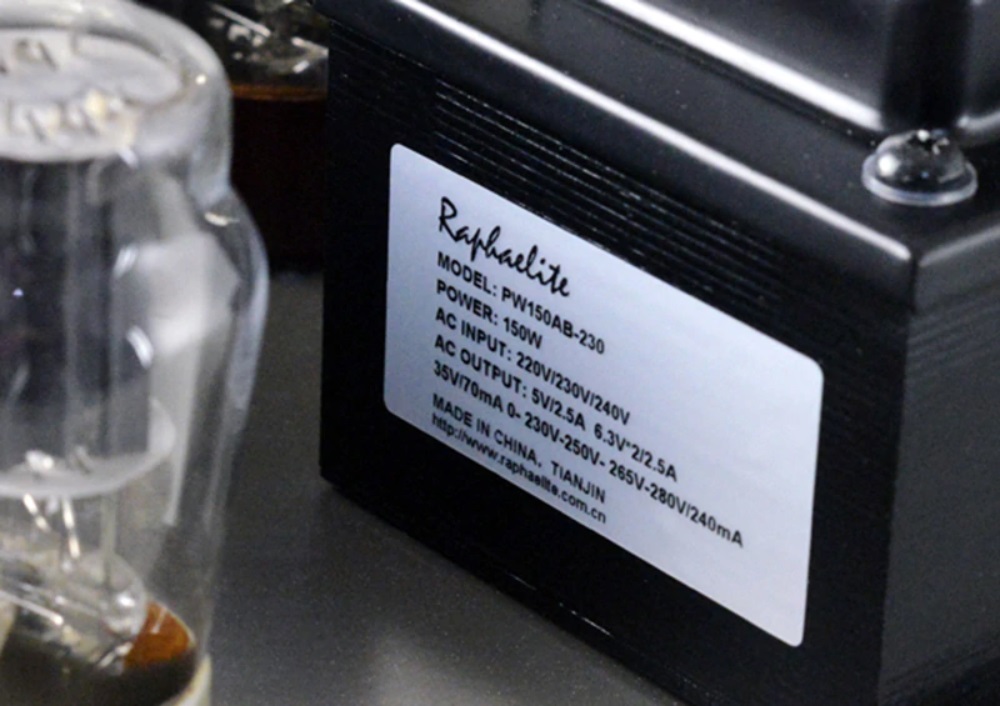

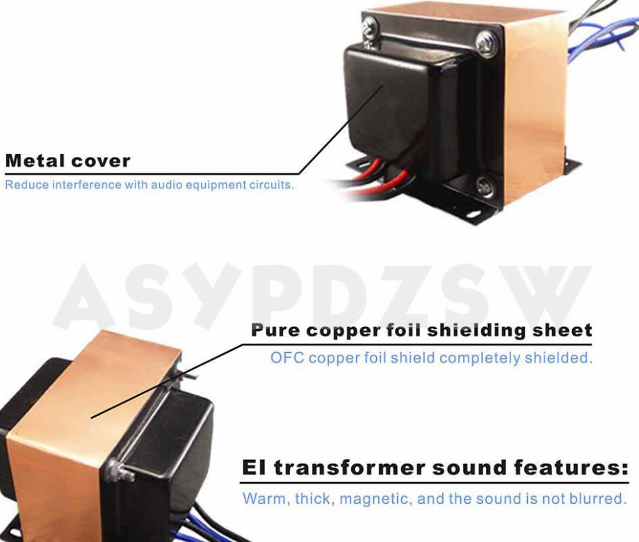

A Chinese manufacturer on eBay claiming that this is well shielded. I thought it was the winding and not the core that needed shielding.
At least the copper "belt" wont do no shielding, it is the wrong way around, it would screen some strays if it where positioned the same way the windings are.

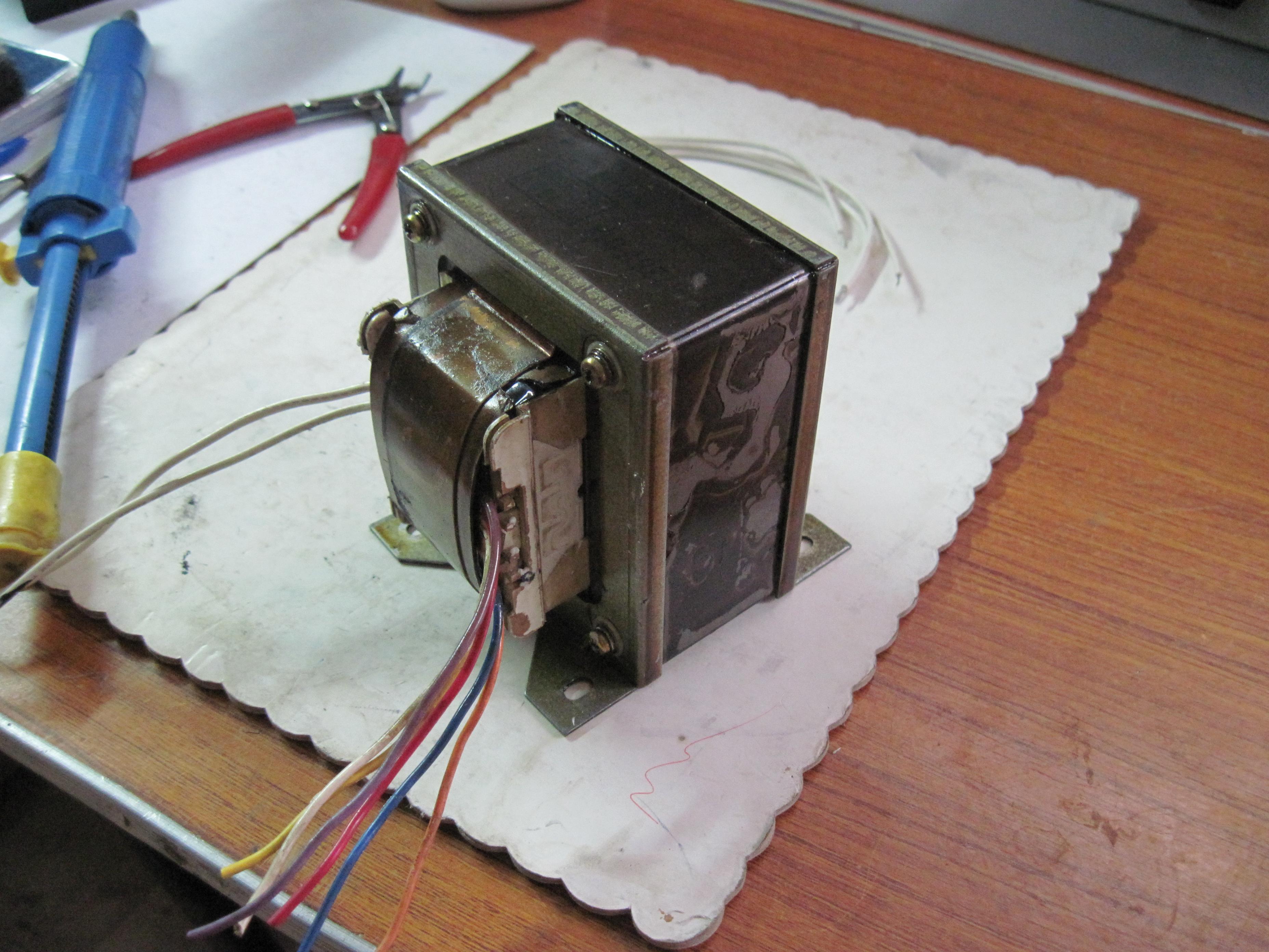

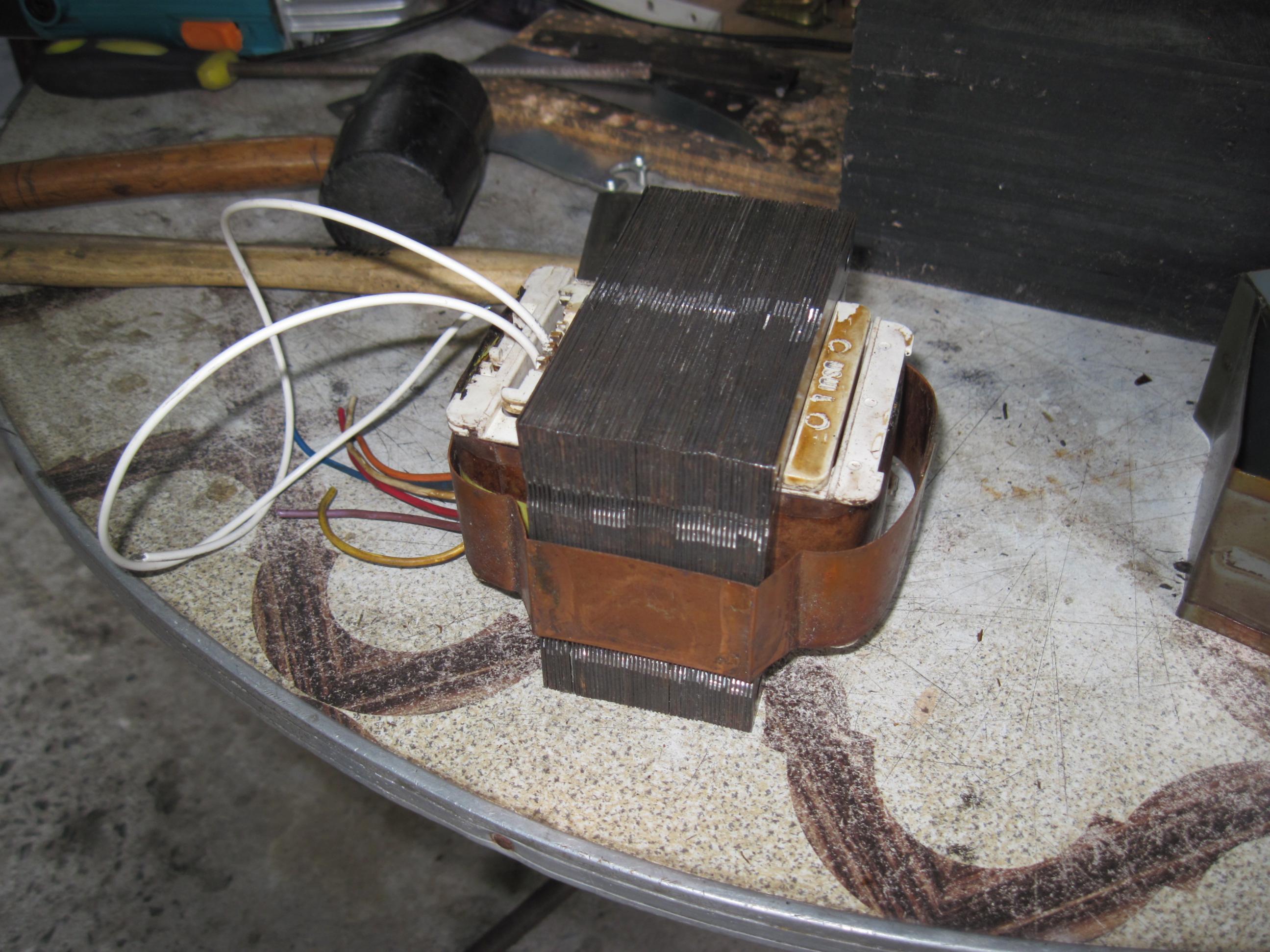

the way the Japanese did it, with belly bands of copper about 0.3 mm thick, and a mu metal wrapping around the perimeter of the core, two or three laps around and then welded...then the enbells are connected...

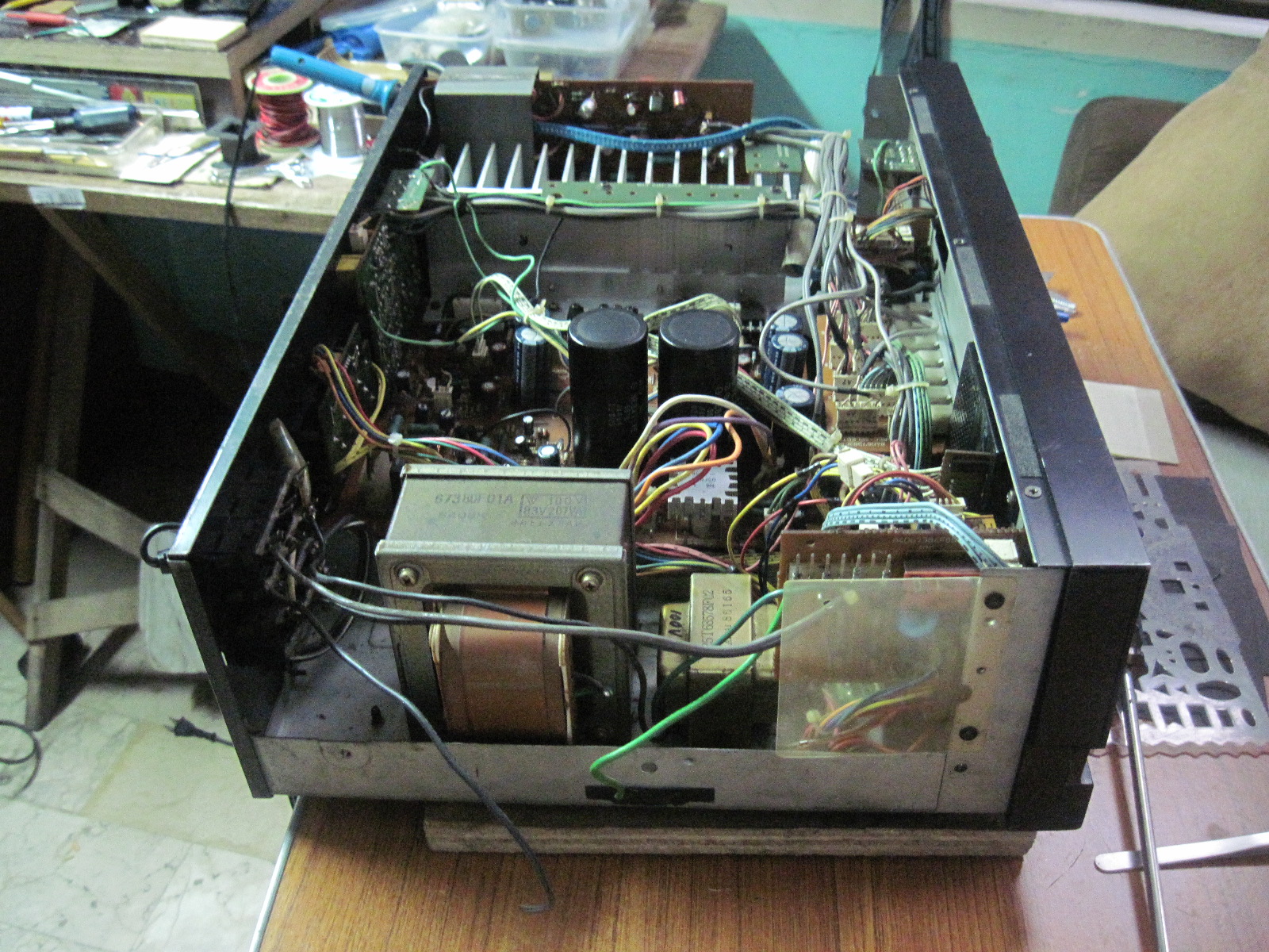

i converted an Alpine/Luxman LV-105 from the japanese standard of 100 vac to 230 volts...

No trust here for the Chinese (having lived there).
The amount of "easy" China(ese) bashing is becoming irritating on forums like these.
Be aware that welfare level in western countries are also possible "because of" how Chinese economy works, despite the criticism you might have.
How so does your transformer numbers do not compute?
Because adding the secondary powers does not match 150W?
It does not say a thing...
What does make sense is measuring the EI dimensions and stack, and it's lamination thickness, and check the power that a transformer with this core is able to deliver.
Checking the dimensions it seems to be an EI96.
Even with mediocre iron quality of 0.5 mm lamination thickness, a 50 mm stack could deliver 150 W.
When the transformer is wound with a lower T, and therefore "does" some 100 W secondary power, you even might have a very neat transformer.
