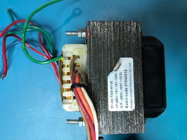

I'm no expert on rewinding transformers but wouldn't the transformer show physical signs of having been taken apart such as laminations having been moved (the label looks intact) and signs of varnish being cracked. The wires in the picture all have that look of originality.

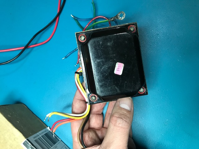

Sorry, the picture was just to show the transformer to JMFahey.
The first time i took it out i have taken that picture.
Right now the transformer has a lot of varnish ( I think thats the name ) and a different wrap around the wires.
I think they didnt charge the repair because it happens the same in a short amount of time.
Ah, OK. I just wondered. So that was an earlier picture.

I was monitoring the current thru the variac that has a meter. It was stable all the time. The strange thing was that as soon i take the input jack with the signal, the current drop to the normal value at idle and after some seconds as increased and the HT voltage as drop.

Not sure what "servicing" mens to them but that transformer has NOT repeat NOT been rewound within the last couple of years (or more).Its not a smps. the transformer is 10v - 60v - 250v.
They did service the transformer. i measure it when i send it and when it came.

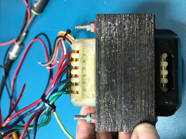

Rewinding requires pulling laminations.
Paint bubbles, rust patches and quarter coin glue patch on top left corner show those laminations have not been removed, so it has not been rewound.
Most they might have done is cutting some fishpaper open and resoldering some iffy enamelled wire to PVC insulated output wire ... but I am not sure even of that intervention.

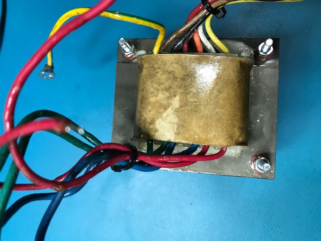

Please show the brown paper side of transformer.
As NelsonAlves said, he has shot the pic prior to sending the PT for repair.

IMHO, that is a small piece of iron, even for a SE 45 amp. Also, I fully agree with the assessment that it has not been rewound.
If it were just one OT, then it would make sense, but such a small power transformer? No surprise if a secondary gets easily overloaded.
The brown paper appears fairly "new"...
IMHO and per ante/post comparison, this xformer has at least been dismantled. Look at the disrupted lacquer structure, and it also appears that the label has been stripped off.
I'm not sure, though, why the shop hasn't been able to rewind it properly. Winding a power tranny isn't rocket science at all!

I agree with J.M. This traffo hasn't been disassembled and then, is not repaired at all, Surely the "repairmen" injected a small quantity of any insulating liquid between the layers (Oil, varnish) and expect that this would save the traffo. I believe you were cheated and I would claim for the warranty (if any and with many lucky).
Then there are shorted turns.
