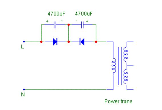

A couple of other possibilities cross my mind. Is something that contains a SCR attached to the same branch of the household wiring? Could DC be riding on household wiring? "Da Blok" is a potential answer to a DC problem.

Every amp I own has a noisy transformer, be it toroidal or EI. I think the mains in my house is poor so I’ve put my name down on a group buy here for a couple of DC filter PCBs. (Does the same job as Eli’s schematic above)
Interesting. I don't have any dimmers on that particular circuit. I'm struggling to think of what else may have an SCR in it.
It never had occurred to me that there may be DC on the line. My substation is only about 500m down the road from me. What would potential sources for it be? What's a good way to measure it? The only way I can think of is zero'ing out my scope with DC coupling and seeing if the wave is riding on something.
I built a lowpass RC using a 10uF and 200k and plugged it in. Over time it fluctuated between 5mV-9mV. With a DCR of ~1.36 ohms on the primary, it is unlikely that this is the problem, although this was a good thing to check!
In reality were talking about a real cheap unit, designed to the max. output for maximum profit for this company. Today those transformers are being made in asia, because its even more cheap. Buy something better designed, with better core lamms and bigger core which doesn't work on the edge of its data, something individual, coated with more varnish and the problem dissappears. If you buy cheap, problems occur.
This started me thinking. How would you even have a dc component along with the ac? It would have to show up as an offset.
From what I've read around, it's not really a DC offset, more of a wave imbalance caused by half-wave rectified devices in your house(I guess things like hair dryers, laser printers, LEDs, etc. can do that, although I'm not privy as to exactly why[LEDs are obvious]).
One side of the sine gets loaded down more than the other, and this manifests itself as a DC offset.
