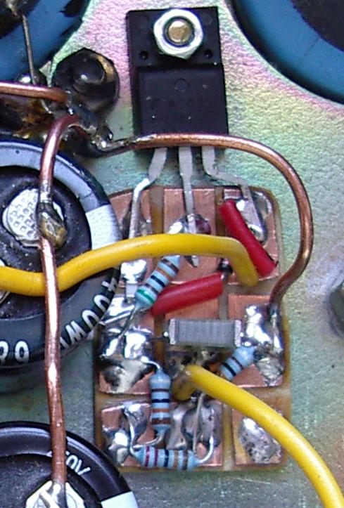

For a 50V dropper, I think Miles's suggestion is good. I've used these reliably too, on guitar amps. Fairchild FQPF3N80C etc, wired as gyrator/cap multiplier is fine, and good sounding.
This one is in a 100W 4x EL34:

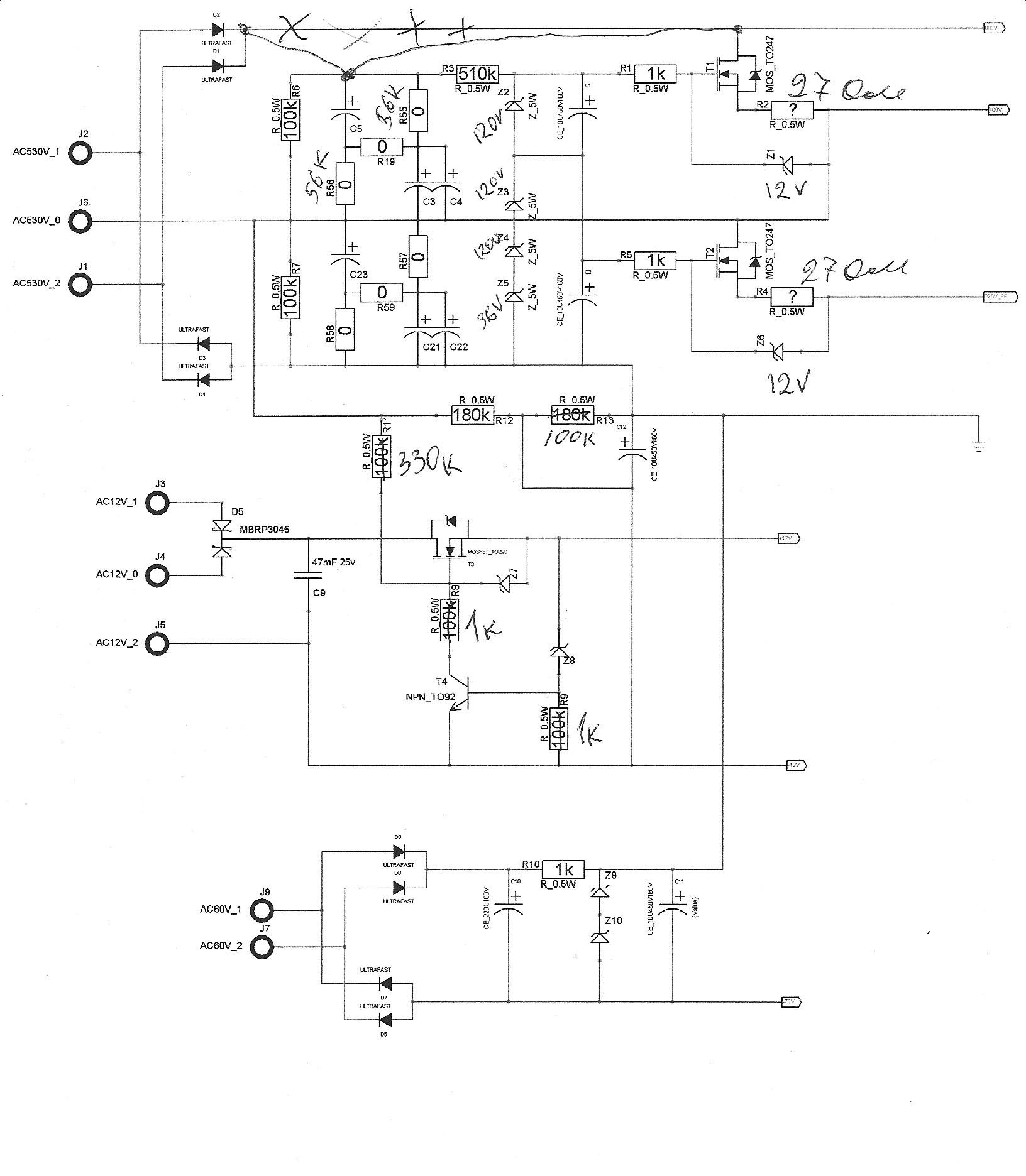

Just one parametric stabilizer (resistor and Zener) shunted by capacitor is enough to power whatecer you want through a single source follower.
In my Pyramid amps I use string of Zeners, and couple of source followers for 270V (screens) and 400V (preamp/driver).
Edit: Oops... found a drawing error, +400V stabilized connected to +400V rectified by mistake.
I would like to see your schematic, but it's not showing with enough resolution for me to read it.

Just click on the picture to open it's full resolution image. You will see in the bottom left corner of a new window a square with arrows: click it to open the image in full size.
Nothing special there: a voltage divider formed by resistor and string of Zeners. Resistor is selected for current needed for Zeners. Zeners selected for needed voltage that goes from them to the gate of source follower. In order to reduce noises generated by Zeners they are shunted by a capacitor.
