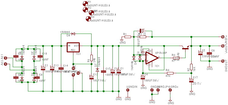

Hi Max,
the regulator measures the voltage and adjusts the opamp to control the pass device Q1.
The accuracy of the regulator relies on the measurement.
Your circuit as posted mixes up power current flow with measurement.
Mentally extract the following components:-r2,r1,r4 & d5
now arrange them in a bridge with r2 at top left, r1 at bottom left, r4 at top right and d5 at bottom right.
the top & bottom junctions of the bridge are the sense points and the side to side junctions are where you take the comparison measurements. It is very important that the currents that flow in this bridge circuit are only the bridge measurement currents and nothing else.
Now add the opamp measuring device, inverting input to left junction
Add the two diodes as your circuit to the inverting and non inverting inputs.
Now connect c9 from non inverting input to the lower side of the r1 trace.
Connect r5 from non inverting input to the right hand junction. We have replicated your circuit exactly.
Do not add anything else to any part of this bridge measuring system. Your regulator needs this to be uncomtaminated.
Arrange all the tracks for the bridge on your circuit board so that no other component touches any of the traces. Now connect the top of the bridge to the OUTPUT connection of the regulator. Connect the bottom of the bridge to the OUTPUT Ground connection.
The two opamp supplies connect to the main current traces running to the output but NOT connected to the bridge.
I suggest you sketch the resistive bridge as a normal bridge and add d4&5, c9, r5 as described. Then draw the regulator around it . Compare your existing PCB and you will find some power currents are passing along the bridge measuring traces, disconnect them and run new power traces OR run new bridge traces, whichever is easier.
BUT do NOT share power with measurement.

Hi AndrewT,
thank you for explanation but, can you draw it to me? i want to be sure. thank's Maxpou

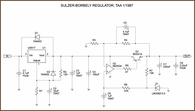

Hallo anyone,
i wave question about reg sylzer bobbely.
in input use lm 317 ic reg,
and output use BD241A
its mean that reg can handle 1 ampere current only?
i have question:
can i use pass transistor in LM317 , like TIUP2955/TIP3055
so the reg current can handle 3/4Amppere?
can i replace BD241A with TIP33? can handle 3Ampere current
if i cant replade BD241A with TIP33, i plan to use regulator to play CD player comp
need 2A12v and 2A 5Volt
beacuse i newbies and i need help and advice.
thx anyone

Re: Ask to Increase sylzer bobbely regulator current
I don't believe your CD player needs these high currents.ridwans said:i plan to use regulator to play CD player comp
Re: Re: Ask to Increase sylzer bobbely regulator current
I use Asus cd 052X, for comp,
before try to connect to power amp, i use suttle external switch 5A
need help to advice, because if i made jung req it difficully to find the component in my country.
AndrewT said:I don't believe your CD player needs these high currents.
Re: Re: Re: Ask to Increase sylzer bobbely regulator current
the right spec in the CD casing is
5V 1.2A
12V 1.5V.
when 1 try to use the regulator in the schematic.
transistor BD241 and LM317 is very hot, even 1 use medium heatsink.
can you give me an option to boot current from that regulator?
thank very much
