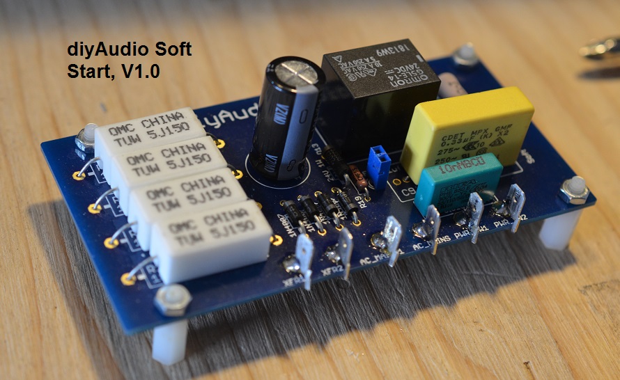

Soft Start stopped working
The amplifier with soft start was working great for a few years. Recently it started showing the following symptoms:
  • I'm using the external switch at PWR_SW1 and PWR_SW2. When I flip that switch, I don't hear a "click" anymore.
  • Voltage OUT of the transformer is low, and clipped.
  • The 4 big 180 ohm resisters get super hot.
  • The LED does not light up.
  • whole amplifier works fine when I bypass the soft start.
So, it seems that the relay is not switching the big resistors out of the circuit. but what to replace first? The relay? The timing cap? rectifiers? All components look fine. Are there tests I can run to see what is failing?
