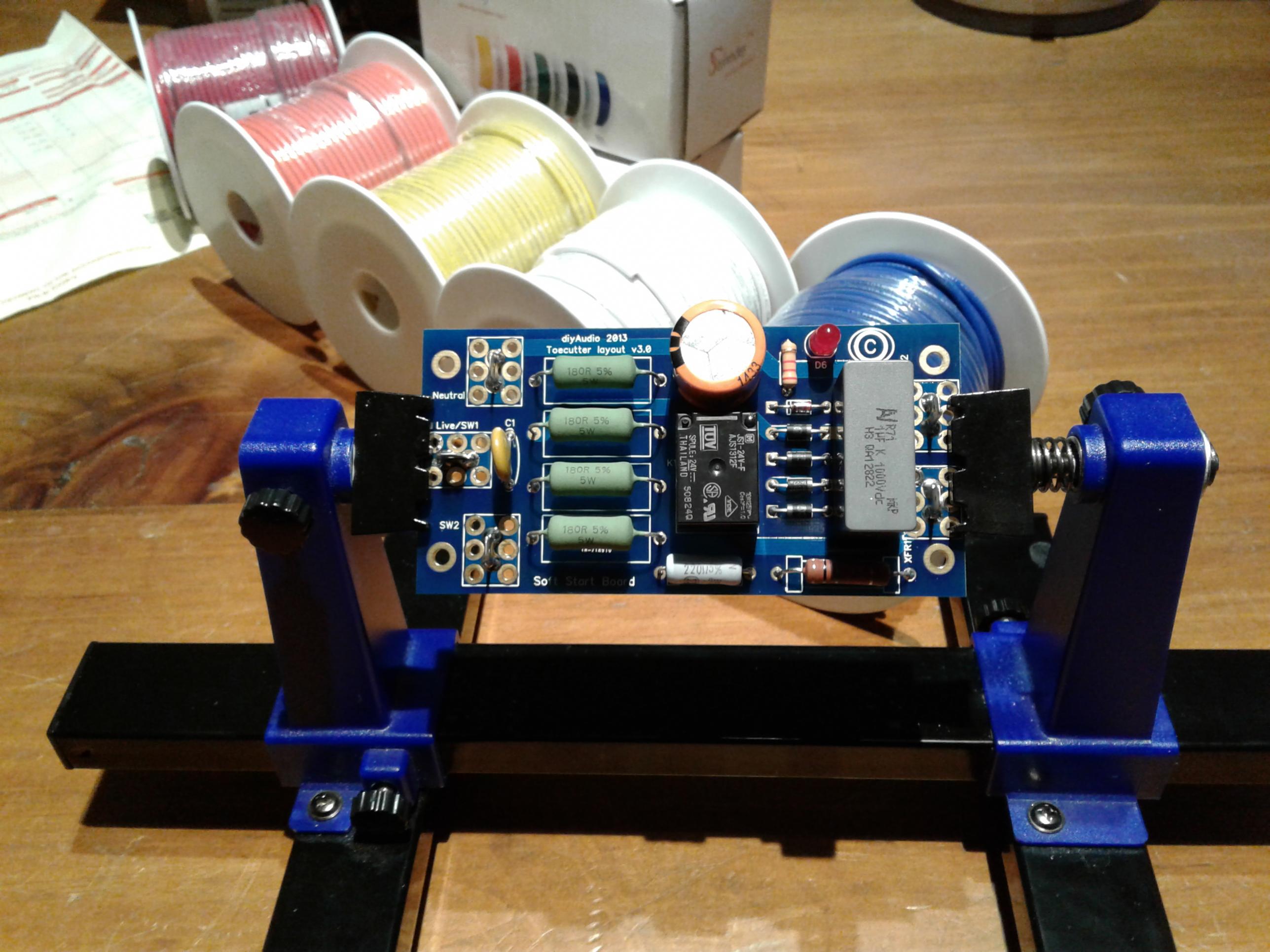

Toecutter is good times
Nice boards from the DIY Audio Store. I like the polarity pads for the diodes and the electrolytic cap! I used a Panasonic JS1-24 relay as Omron bailed out. I checked around and it looks like there are many relay substitutes. I bought the big chunky screw terminals but in the end I went with old fashion Faston tabs. The electrolytic is by Epcos Inc and the film cap is from Kemet.
The Toecutter board is very good, I will buy some more soon. Next is the speaker protection board.

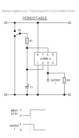

I've been playing around with this circuit (specifically the transformerless power supply, or "TPS", used in the soft start) and I think I am getting a good feel for how it can be used, and when it can't. The cap is just a reactive element that drops the mains current. In a sense, the cap reactance and load of the relay coil act much like a voltage divider in that if you change the load resistance the voltage across it will also change. When the TPS is connected to a relay that is supposed to just "fire" as soon as the voltage across the smoothing cap charges up high enough this works well. If you have a circuit that has a change in load impedance at some point, this will impact the voltage that the TPS is delivering to the load.
I happen to have a ton of LM555 timing chips. These are pretty handy and can drive a 12V relay directly. You can use them to create delays of seconds or even minutes if you want, so if you want to charge up your cap bank really slowly, or do some other action many seconds after power up these can work well. But when powered by the TPS, if you connect the output pin to the relay coil (as a drain) with the other end of the relay coil connected to the TPS you get so large of a drop in voltage when the relay is energized that the relay will open again and the LM555 goes below its min voltage! Fail.
The problem is that the current consumption of the circuit changed from almost nothing to several tens of millivolts and this causes the TSP voltage to sag. There is a modification of the 555 circuit that you can implement to prevent this: connect the output pin both to the relay, and to ground via a resistor that is equal to the relay's coil resistance. As long as the 555 output pin is high, the relay coil has 0V across it. At the same time, because of the additional resistor connected from the 555 output pin to ground, when the output pin is high the LM555 is sourcing current to ground equal to the current needed to drive the relay. On the changeover of the output pin state to LOW (e.g. ground) the output pin is now sinking current through the relay coil. But the amount of current that the circuit is consuming has remained the same because now current is passing through the relay instead of passing through the extra resistor we added between the output pin and ground.
Because the current consumption of the circuit is constant and below 100mA, it's a good candidate for the transformerless power supply.
I have attached a naive circuit schematic for an LM555 configured for "delay-on-make" operation with the extra resistor added. It shows the "extra" resistor that I mentioned adding to the circuit as R2, from pin 3 (output) to ground. The relay coil would be connected between the V+ rail and pin 3. When the time set by R1 and C1 causes pin 3 to go LOW (as shown by the little diagrams at bottom) the relay coil becomes energized. Keep in mind that the LM555 has a maximum supply voltage of 16V, and a 15V zener in the TPS can make sure that this limit is obeyed.
If anyone is interested I can post the full monty circuit of TPS+555 timer+relay from my SPICE sims. They show that this can work well for longer delays as long as the relay can be activated with up to 15V and total circuit current consumption is less than 80-100mA. Or perhaps I should start a new thread about this topic in the Power Supply forum...
