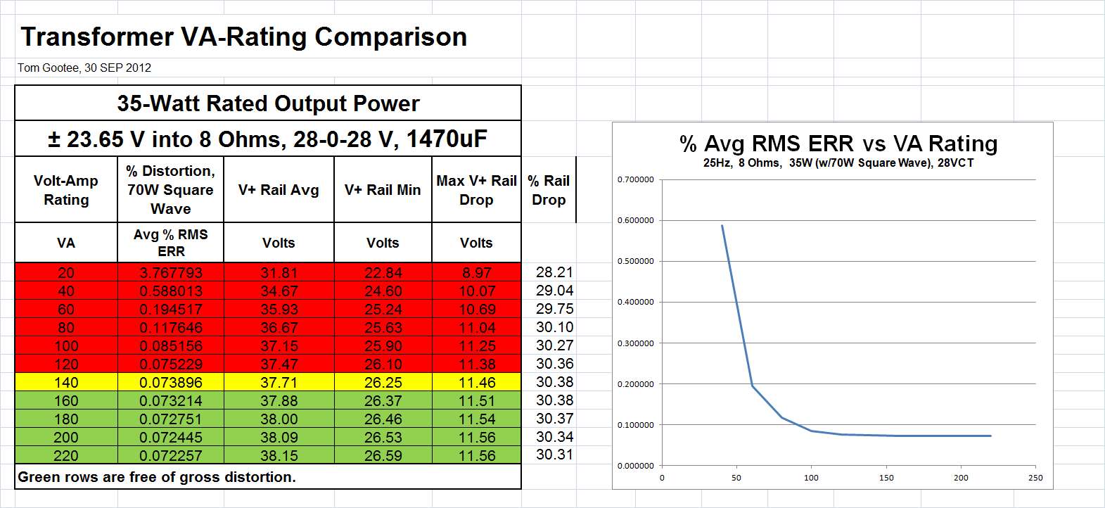

I have done only one, so far, which used a 35-Watt-RMS-rated output power into 8 Ohms, with square waves (making it 35 Watts per rail), with 1470 uF of smoothing capacitance, a 28-0-28 V transformer, and VA ratings (for each secondary) that were swept from 20 to 220 VA in 20VA steps.
Attached are the data points and a plot of the square wave distorion vs VA Rating.
Tom

Daniel,
Attached are the data points and a plot of the square wave distortion vs VA Rating.
Tom
Thanks Tom! There's some really disturbing news when it comes time to pay for the right size transformer. The chart is totally plausible though. I've seen a few real life situations where there's just not enough bass until buying the much higher current transformer. So, it would have been less expensive to get the transformer big enough on the first try. 😉
Daniel,
Don't worry too much, yet. Changing the capacitance totaly changes the picture. But changing the transformer output voltge changes it even more.
I purposely chose a power level and capacitance combination that made sweeping the VA rating cause significant changes, with the given 28 VRMS transformer output voltage.
With a little more excess transformer output voltage, and any large-enough capacitance, the circuit becomes much less sensitive to everything else, especially the VA rating.
Having a high-enough PSU transformer VRMS Out is extremely important, for use with a power amplifier.

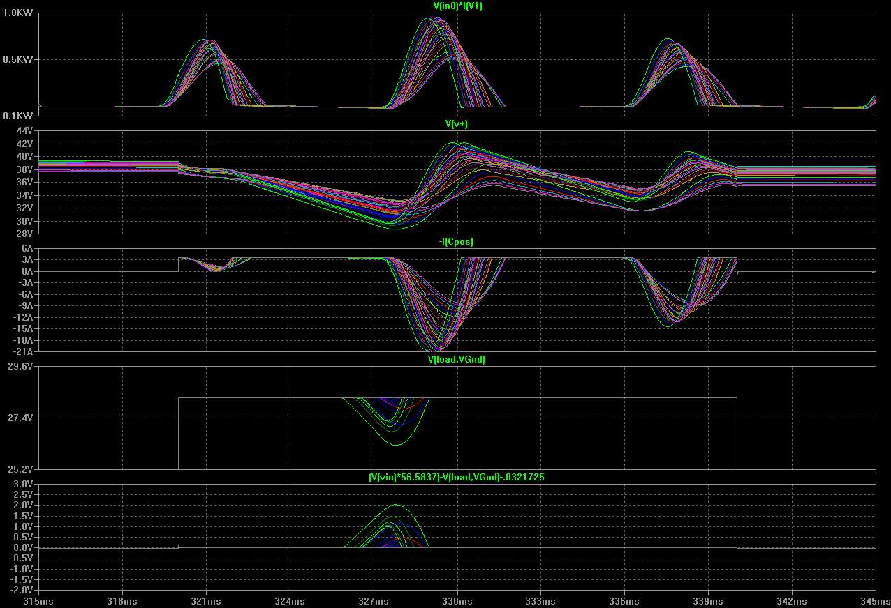

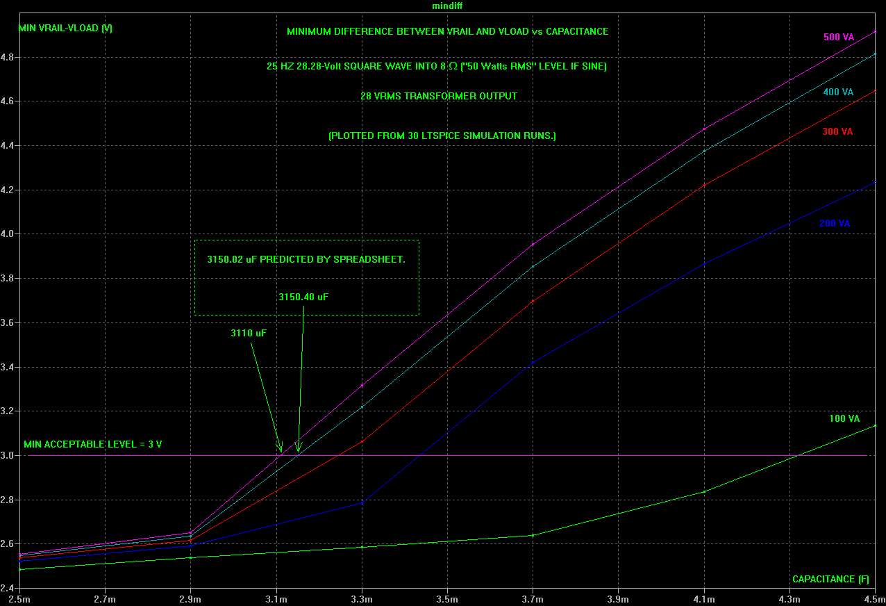

In my version of the spreadsheet, I changed the rectifier voltage drop from 1.4 to 1.7 Volts, since that's closer to what it is, in the simulations.
I did a series of runs (see attached plot), with Pout=50W and transformer Vrms=28V, automatically stepping the capacitance (2500-4500 uF by 500uF) and the VA rating of the transformer (100-500 VA by 100 VA, and plotted the "minimum voltage difference between the power rail and the high side of the load" (over 0.2 second) vs the reservoir capacitance and the VA rating. The minimum difference voltage (i.e. the voltage range where the amplifier resides) must stay above about 3 Volts, to avoid distorting the output with the power rail voltage ripple.
The plot verifies that the spreadsheet very closely predicted the minimum acceptable reservoir capacitance found by simulation, for the 50W / 8 Ohms / 28 Vrms case. In this case, the calculation appears to have been equivalent to using a 400 VA transformer.
The spreadsheet, if accurate-enough, could be used to create a table and/or plots that could show, for example, the regions of the [Pout, Vrms] plane where the capacitance values would be "reasonable".
I am also hoping to find out how to estimate the effect of the VA rating on the required capacitance, using sets of simulation runs like the ones that were used to create the attached plot.
Edit: I added a plot with some of the raw time-domain data from the LT-Spice runs, covering about 5% of the total time. For each run, the data for each entire run was automatically examined by the .MEASURE scripts, and the one minimum Vrail-Vload point was found, for each run, and the voltage difference was calculated and saved, then used for the first plot.
Tom
Tom
