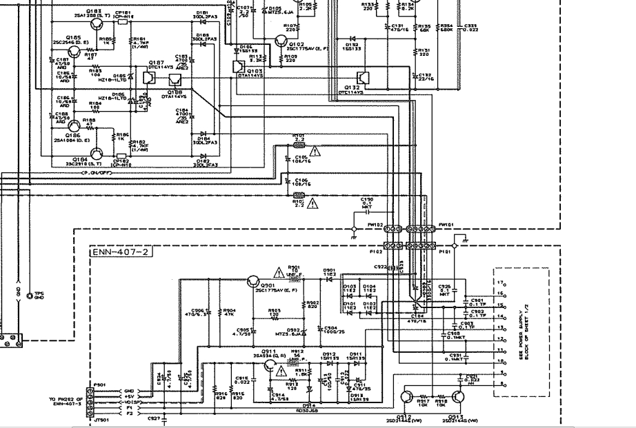

You are welcome, Stefano. In my last post I also wanted to clarify that by "size" we were probably talking about the number of capacitors being paralleled, and/or the physical size of their layout. "Size" could have also referred to the total value of the capacitance but I think that we were probably considering the case where we had already chosen a total capacitance and were then thinking about how many parallel caps to use to physically implement that value.
This evening I'm just going to apply our reasoning to an old player, by adding "decoupling" caps near the output devices (here cheap op amps)...

Thank you Tom,
<OT>
funny enough those opamps actually have no decoupling caps, at least in that model. The upper model had them (even if I can't understand why with such a high voltage rating (100v) with "reservoir" of 47/50v)...
</OT>
So, I'm just figuring out which values to use, trying to follow also Frank's rule of thumb on decoupling.
Bypassing is to bypass the high frequencies to ground, to defeat the positive feedback loop through the power rails for high frequencies that exists for most topologies of transistor-based amplifiers.
Decoupling is for supplying fast transient currents when needed, so that the rail voltage is not disturbed too much, i.e. "decoupling" the effects of transient current draws from the rest of the power supply circuitry.
Thank you! That makes sense!
