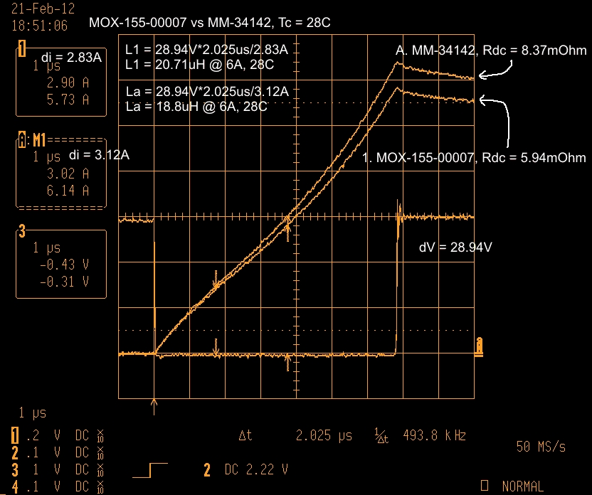

this is not an audio amplifier - its a "splat tester" for measuring inductance, but I used the aforementioned construction technique.
The Splat Tester is a big bank of caps going to a coil under test, then into a FET switch to 0V (many FETs in parallel). On the other side of the PCB is +Vdc, and a slot cut across the PCb. I solder the choke I'm testing across the slot.
There is a loop of wire I clip my current probe onto, and a pulse generator drives the input of a FET driver. The diodes you see are between the FET Drains and +Vdc.
I feed the cap bank from a bench supply, up to 100V. Then whack the choke with a pulse from a pulse generator. This makes current build up in the Choke being tested:
V = L*dI/dt, so for t = Tpulse, I ramps up to Vdc*Tpulse/L_choke
the slope of the measured current dI/dt = Vdc/L_choke, so I can calculate
L_choke = Vdc*Tpulse/I
I ensure that 0.5*6.5mF*Vdc^2 is >> 0.5*L_choke*I^2 (or in other words that +Vdc doesnt droop much)
there is a BNC connector for the pulse generator input, another to connect a scope probe to the input pulse (to trigger from) and a BNC measuring Vdrain.

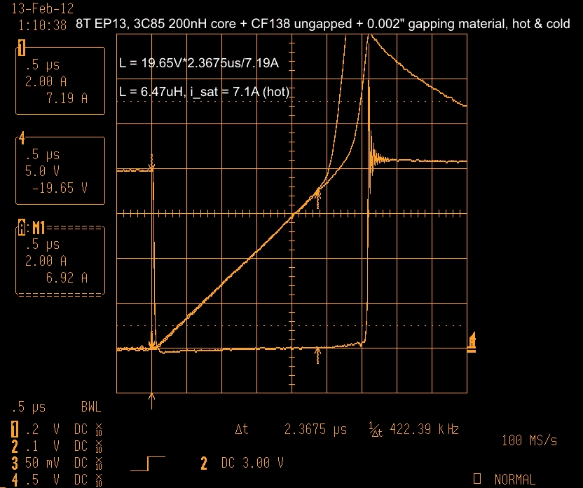

This way I can measure inductance vs current, and see saturation too. with ferrite cores the current slope is straight, until it saturates (which is quite sharp). iron powder cores have a permeability that varies a lot with current, so the current slope isnt straight, nor is the transition into saturation very pronounced.
attached are splat test results from Iron Powder (Moxie...) and Ferrite (NGD....) cored inductors.
Only downside to this toy is I used a plastic box. So I had to cobble together a heat shield from FR4, so I can het the device under test to 100C without melting the box, or my horribly expensive current probe 🙂
You can make a crude version of this with a decent sized cap bank, and a low inductance current sensing resistor. stick the R in series with the cap -ve terminal, and hook a scope probe to it. stick another scope probe to the + terminal. solder one leg of the DUT onto one cap terminal, and use a bit of solid wire soldered to the other terminal as a switch. charge the caps up, then close the switch - you'll soon see why its called a SPLAT test! eventually you will get sick of poor contacts (bounce = lousy waveform) and make a box like this.
I learned this trick years ago, working on big AC drives. 40mF charged to 600Vdc makes quite an impressive splat, and is a great way of getting several hundred amps flowing into a choke. ever so slightly lethal though......

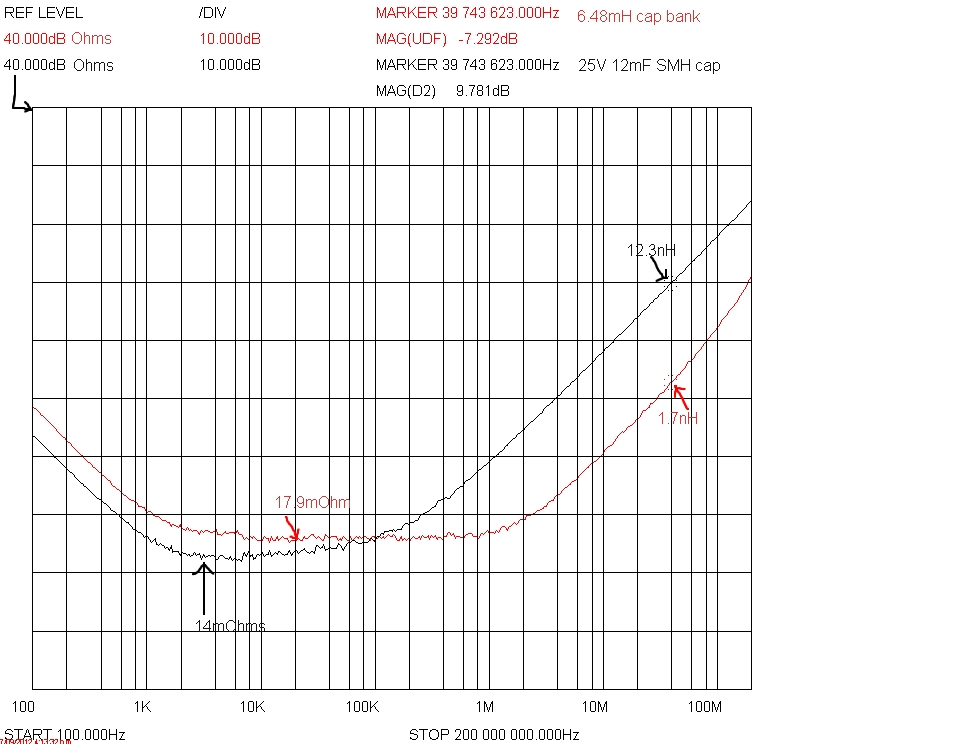

Steven,
here is the impedance of the cap bank. vertical scale in dB-Ohms, top line = 40dBOhms.
I also measured an SMH 25V 12,000uF = 12mF capacitor. I dont have a dedicated test fixture for this cap, so the measured lead inductance is a bit higher than ESL (I had to have enough leads to solder the darned thing to an existing test fixture). I'd estimate this cap at around 7-10nH (test fixtures are important when measuring stupidly low inductance).
But the cap bank has a total of 1.7nH - almost 10x better. and there are NO nasty resonances out to 200MHz (HP3577A limit). Nor are there any "decoupling" caps (film or otherwise)! yet the Dc bus impedance is < 100mOhms @ 2MHz, rising to 1 Ohm at 90MHz.
Not bad for a home-made PCB, using only a battery drill 🙂
The cap bank is very crude - a DS-PTH pcb would shave off maybe 0.2~0.5nH. Using thinner PCB (this is 1.6mm) would have a much larger effect - I would expect a total inductance of < 0.5nH in that case.
Edit: this very low broadband impedance will do a VERY good job of attenuating any AC line noise that makes it past the rectifiers. Likewise this will effectively filter any audio signal above 1kHz or so, preventing it from reaching the transformer. assuming, of course, one does not then go and undo all this good work with lousy wiring.

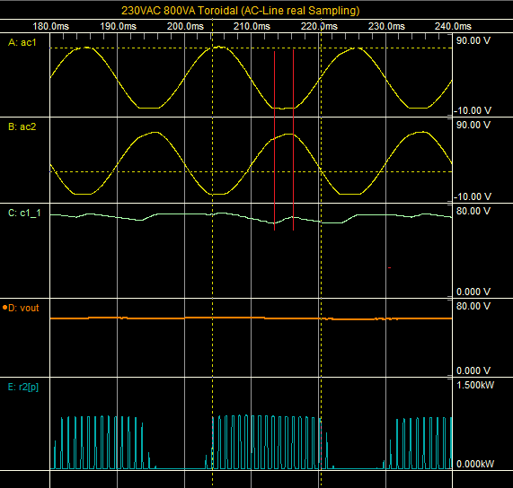

Hi All,
Tom: You certainly did a great job, I do not think that others have gone so far as to with the models in the simulation.
I followed (perhaps not very well) your work, I am with out a doubt, whereas the AC line is not perfectly sinusoidal, we know the reason of inductive loads, reactive, many big industrial capacity etc.
see for example, ac1-ac2 is the secondary transformer, V-in (on main capacitor cell, in relation to the load 12Amp burst 1Khz. with duration of 20mS.
there is a hole of energy is not in phase with the ac line I think.
you can show like these on your model? it is simple monitor of ac-line, main capacitor, voltage rail on power devices.
regards

AP2,
I don't understand exactly what you are suggesting but I think that I can answer your question.
In the simulation model, we can add connections and components at any point in a circuit.
One component we can add is a voltage or current source ( or a circuit including them). And they can be driven or controlled in extremely-general ways, such as by equations, or by equations involving parameters from other parts of circuits.
I am confident that we could devise a way to generate a close math to the burst you showed. And we can insert a voltage or current source into a conductor, anywhere, or connect it however we need to, in order to arithmetically sum the burst with that conductor's voltage or current.
Tom
Thank you for reply,
certainly my English does not help me.
well, as you say, I agree, also I make models when I need it.
I suppose that you have your complete model of transformer, rectifier and main capacitors (I think you have this)
Now it is obvious that you have created a load (I hope dynamic) amplifier or as burst as you said. Now, I ask you to show the tracks in points. ac on the secondary, on main filter capacitors, and on load. as I have shown in my last post.
