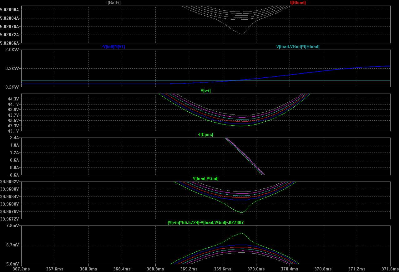

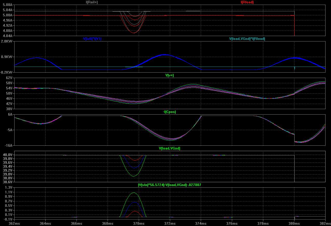

Here is an example of the power supply distortion that I am using to determine the "cutoff" point for the "minimum" required capacitance.
The example setup is not extremly important, for this example, but for the sake of completeness here is its description: It has two 500-VA-each transformers acting as center-tapped secondaries of a simulated 1000 VA-rated transformer, with a rated voltage of 44-0-44 VCT RMS, powering a rectifier bridge, reservoir capacitors, and the amplifier previously shown, set up to produce 100 Watts into the single 8-Ohm load resistor, with 25 Hz square wave input and gain set to produce +/-40-Volt peaks. (That actually gives 100 Watts RMS, per power rail, but not at the same time. So it makes a total of 200 W RMS if both polarities of the square wave are considered, but would make 100 Watts RMS, total, for a sine wave of the same peak amplitude.) Anyway, the 1000VA 44-0-44 transformer should be enough that the transformer ratings will not prematurely distort the output signal (i.e. it should not require atypically-large reservoir capacitances).
Image 1 shows the measured parameters for reservoir capacitors (one per rail) of 1000uF to 2500 uF each, stepping 500 uF each time, with the sequence of colors being (except fpr the top two plot panes): 1. bright-green/yellow, 2. blue, 3. red, 4. light-green. As can be easily seen, the output signal plot (second from bottom)and the calculated error (bottom plot), have large spikes, or glitches. One such set of error pulses is shown magnified, in the next plot.

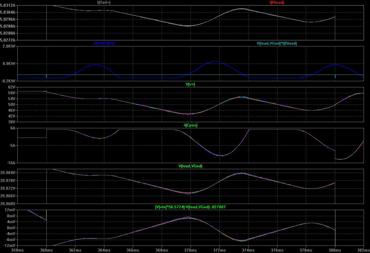

Image 2 shows a zoomed-in view of one set of the spikes. It appears that there are spikes for 1000, 1500, and 2000 uF, but none for 2500 uF. So the capacitance was then stepped from 2000 uF to 2500 uF, with 100 uF per step.

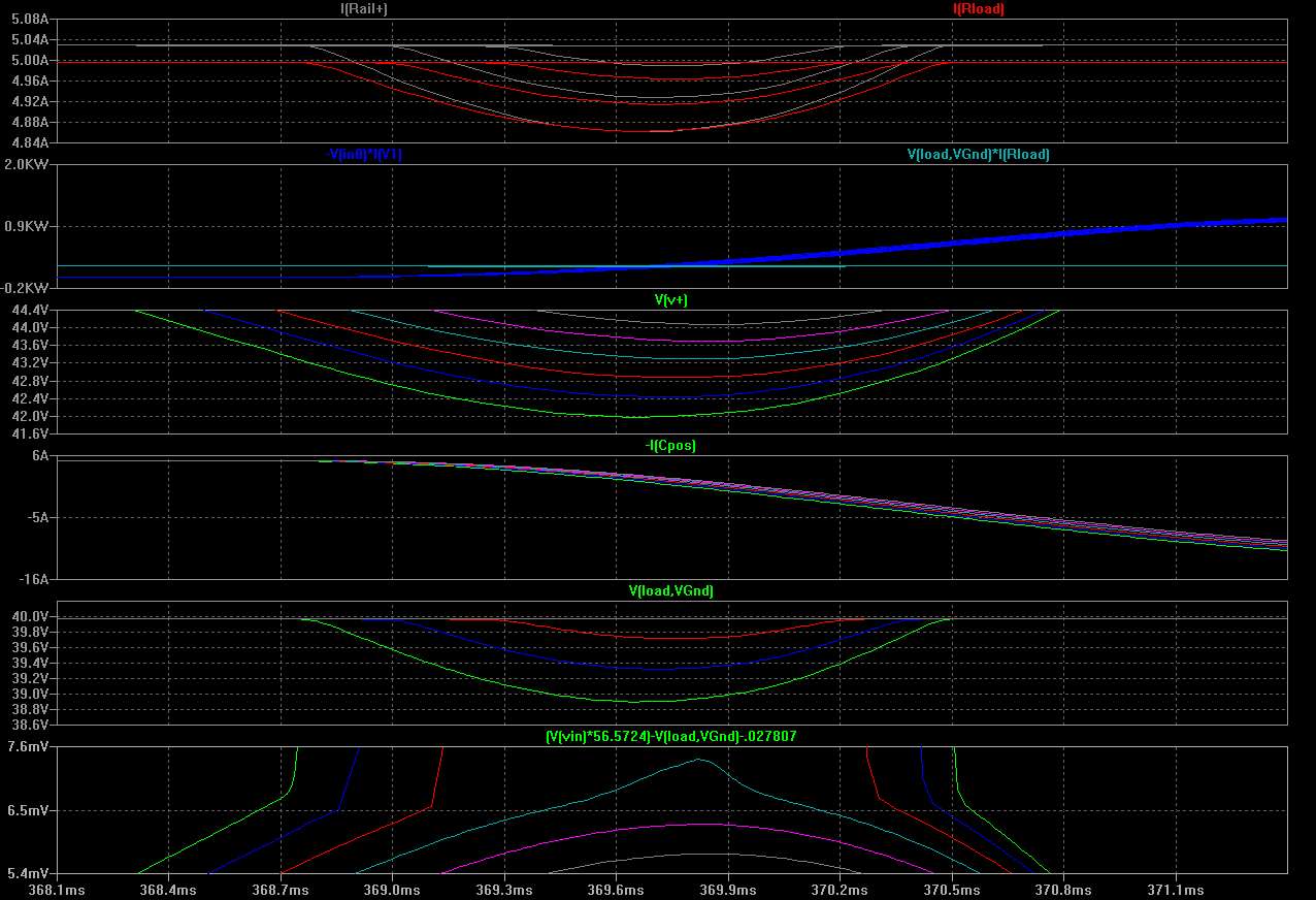

Image 3 shows a zoomed-in area that had a larger remaining error than the area shown in the previous plots. It looks like 2200 uF is still distorted but 2300 uF might be OK.

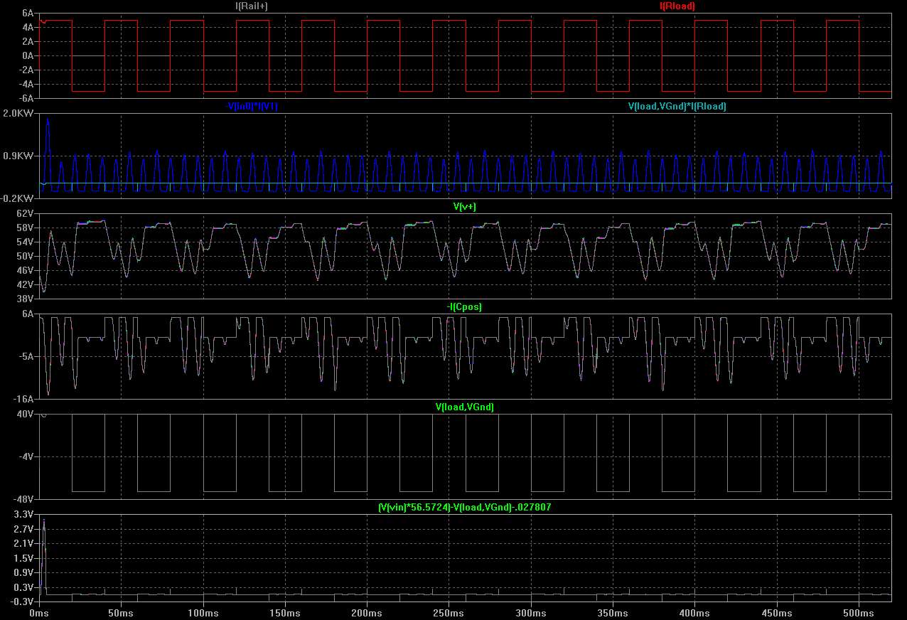

Image 4 shows the same area as plot 3, but zoomed-in much more. Now we can see that 2300 uF DOES still have some of the distortion. It's only about 0.5 mV, out of 40 Volts. It might not be audible, but one purpose of this study is to find out where (at what capacitance level) this "obvious" type of PSU-induced distortion goes away, "completely".
So, we could be overly-ambitious and try to find out where, betweem 2300 and 2400 uF, the distortion disappears.

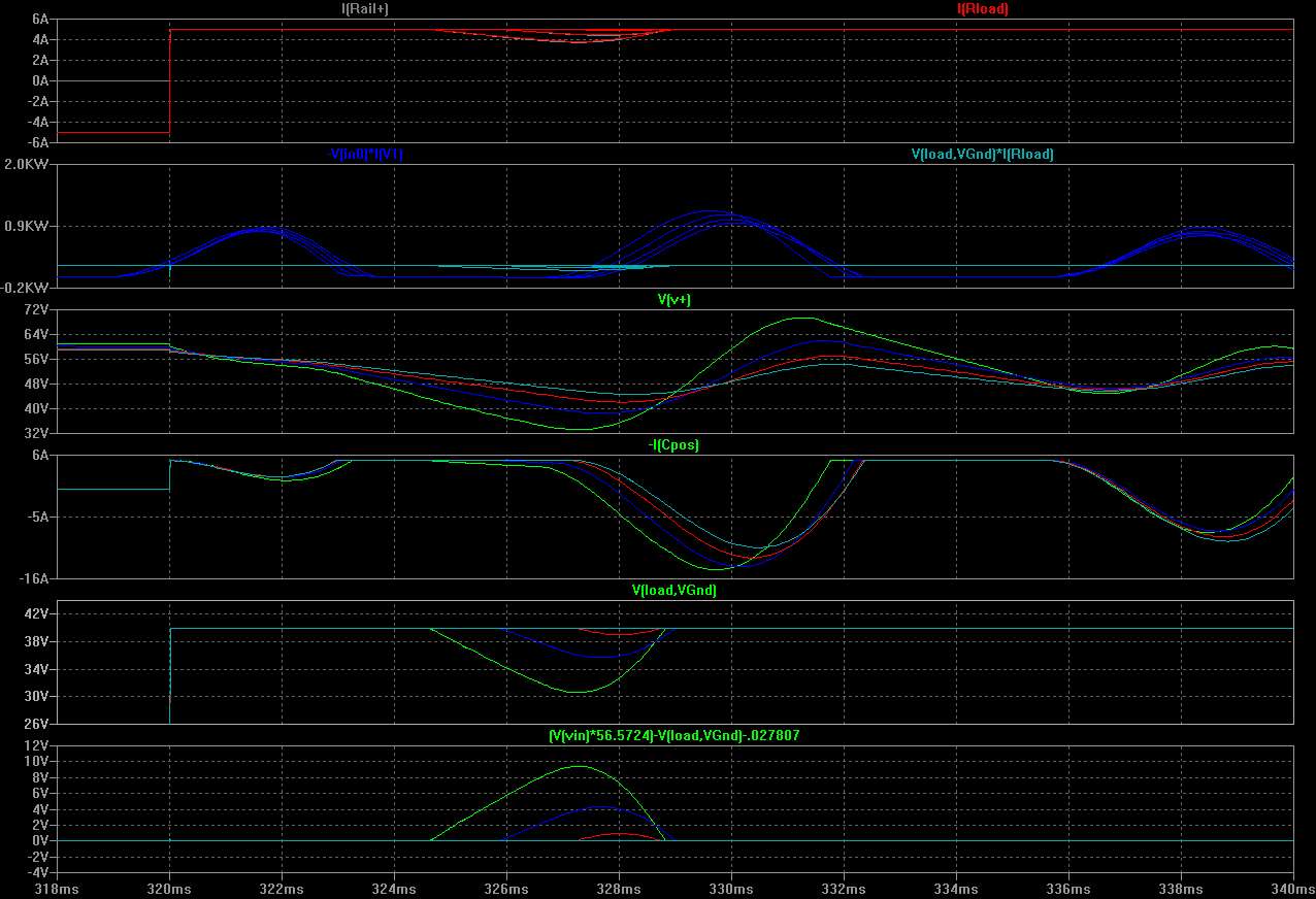

Image 5 has the graphs for the sweeps from 2300 to 2400 uF, with 20 uF per step. The distortion is no longer obvious, with the plots unmagnified. But we now know exactly where to look...

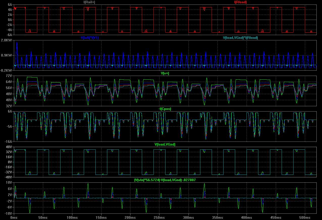

Image 6 shows a partially-magnified set of plots, so we can see the "context" of the remaining error glitch, which is just to the left of the 370 ms line.
Image 7 shows the glitch with additional magnification. Now we can see that 2300 uF still gives the glitch, but 2320 uF looks good. Bingo. (It's only doing an excursion of about 700 uV. But for 20 uF more, it can be gone.)
Looking only at the "flat" tops and bottoms of the square waves, there is still another type of distortion, which is shaped like the voltage rail voltage, and which is reduced as capacitance is added. It looks like less than +/-10mV, in the plots, with 10 mV being 0.025 % of 40 Volts.
(And, of course, without decoupling capacitances placed close-enough to the points of load, there are still error impulses coinciding with the rise and fall of each square wave.)
Tom
For amplifiers with respectable PSRR/CMRR, a small power supply ripple wouldn't affect it much, did you take that into consideration?
You have not read this Thread!
The output stage is being investigated.
The input stage is being treated as if it were perfect.
This is equivalent to saying that the PSRR is infinity and CMMR is minus infinity.
This Thread is not investigating the performance of a voltage amplifying stage. That should rightly be left to simulation of an amplifier.
This Thread is investigating the effect of PSU on the performance of the output stage.

I'll measure the DC bus impedance, along with the impedance of a 12mF 25V electrolytic (I dont have a 6.8mF cap handy). I need to wait for the network analyzer to warm up though.....
