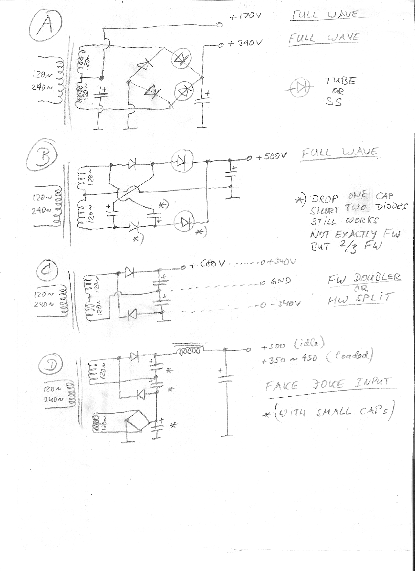

Here are a couple of ways to get various voltages from a cheap 120-0-120 isolation transformer.
What wg_ski meant was something as shown as in sketch "A".

I like 'A', but only if you have equal load currents. Great!
'B' is quite lovely, 2/3 wave.
'C', I already mentioned that.
'D' does not have a dual winding with a wired center tap.
It requires two completely different secondaries.
Might as well make one winding the higher voltage winding, and the other winding the lower voltage winding.
Kind of like I said, except I used a winding with a center tap, and =/- lower voltage taps, and +/- higher voltage taps.

FYI, schematic A in post #23 is a vintage classic used by Philips, especially for their PA audio amps using the TV tube 6CM8/EL36. It allows the 50% output to directly feed the pentode screens, and the 100% output to feed output stage B+, as well as pre-stages. The TV pentodes required a restricted low B+ for robust operation. AWA amps went up to sextuples of the 6CM8, for 100W plus PA requirements. Afaik, there is no concern with independent loading of the two B+ rails when both are capacitive filtered via ss diodes.

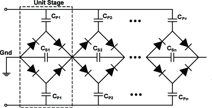

FWIW, the most sophisticated voltage multiplier I am aware of is the provided full wave series/parallel setup. Each stage is a 4 diode bridge. Polarized electrolytic caps. are OK in the series positions, but (IMO) caution requires AC rated film caps. in the parallel positions. The required voltage rating of the parallel position caps. increases, as "movement" away from the point of AC application occurs.
Bipolar PSUs, with possibly differing rail voltages, are possible using this technique. On the AC feed "side", all that's needed is a simple winding of sufficient V/A rating.
I haven't seen this one before. Eli, what makes this scheme "most sophisticated"? What are some of the advantages over other multipliers?
